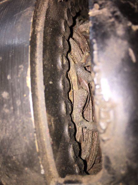

                                    Back to the Metropolitan Vicker single phase motor. Basically the motor is an inside out induction motor, the rotor is the stationary part and is constructed in a similar manner to what most folk would expect a normal induction motor to be, bars front to rear and short circuited. As the motor is not mine and some 150 miles away I can't take the motor to pieces to see the rotating member, regarding the manner in which the two windings are wound or located. Hopefully a series of picture will become available later. Pleased to say it is a runner. John

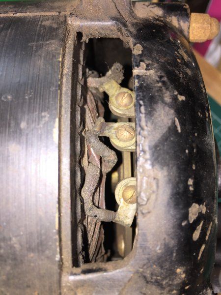

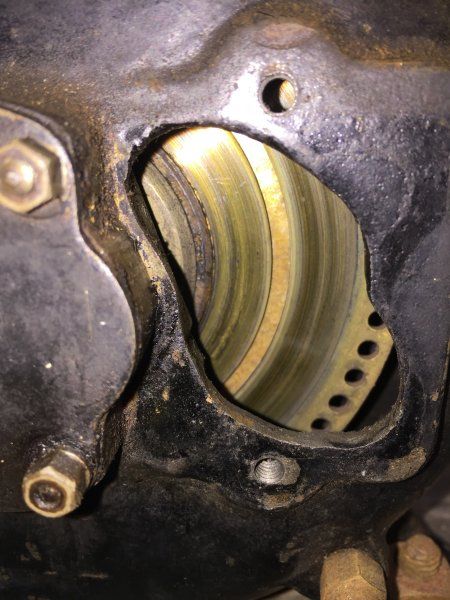

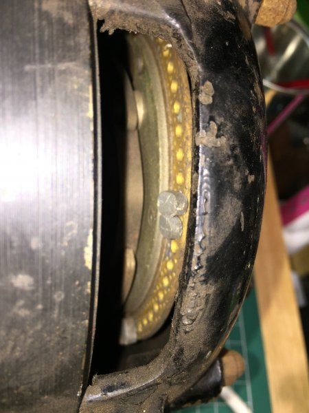

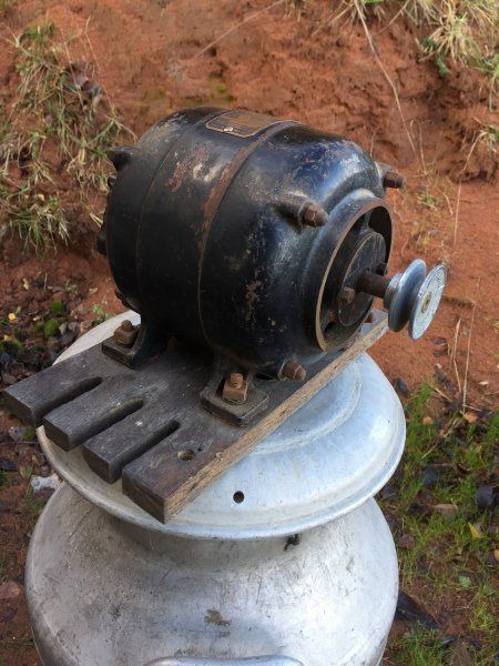

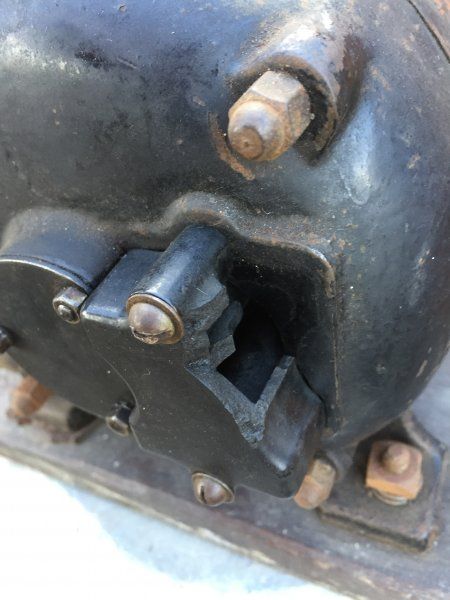

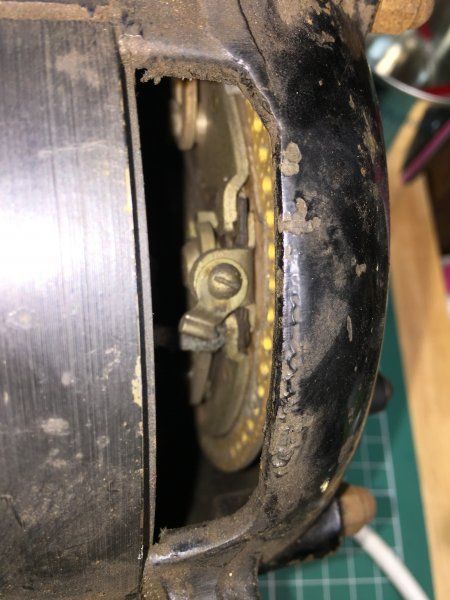

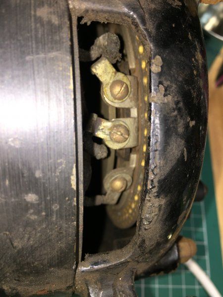

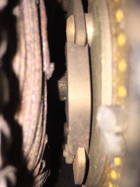

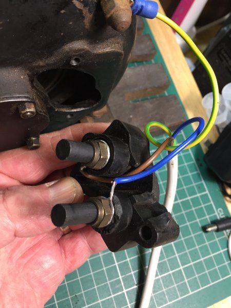

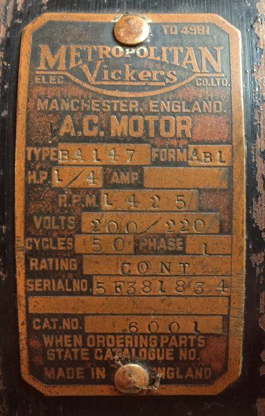

                                                  10.jpg9.jpg8.jpg7.jpg6.jpg5.jpg4.jpg3.jpg2.jpg1.jpgAs I mentioned earlier this motor is also being discussed on another forum. Below are some of the pictures from that thread.
                                                  #574517
                                                  Robert Atkinson 2
                                                    @robertatkinson2
                                                    OK, A picture is worth a thousand words.
                                                    It appears to be a switch (centrifugal) start induction motor. The oddity is that it is "inside-out". The induction part is the stator and the powered winding is the rotor.
                                                    The most likely reason for this was to get around a patent. It does simplify the centrifugal switch arrangement thoough.
                                                    AC power would just be connected to the brushes as shown in the picture.
                                                    Robert.
                                                    #574519
                                                    Ian P
                                                      @ianp
                                                      I agree the rotor mounted centrifugal switch is a neat idea but the downside is the brushes/sliprings carry current all the time.
                                                      The one picture that I thought might eleicit the most clarification is the one showing the brass plate that clearly shows the model type to be 'BA 147'.
                                                      Surely this must be in some old catalogue somewhere?
