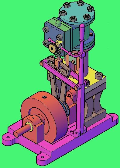

I have been spending some time over winter doing a metric version of Elmer's VR75 as a solid model in AutoCad. I have completed the assembled model in model space with each part on a different layer. I have started doing the drawings in paper space with multiple layouts with viewports. Each viewport can be set to only show the required layer(s) for the part being drawn, the line thickness and colour used for that layer in that viewport can be set, usually black. The scale in each viewport can be set to an exact value to suit the paper setup being used. Dimensioning is done in paper space so that things like dimension arrows are automatically sized.
There are plenty of tutorials online for AutoCad. These show how model space, paper space and viewports are used to make the best use of CAD. Not using these programs as they were designed to be used is probably making things harder for the user.

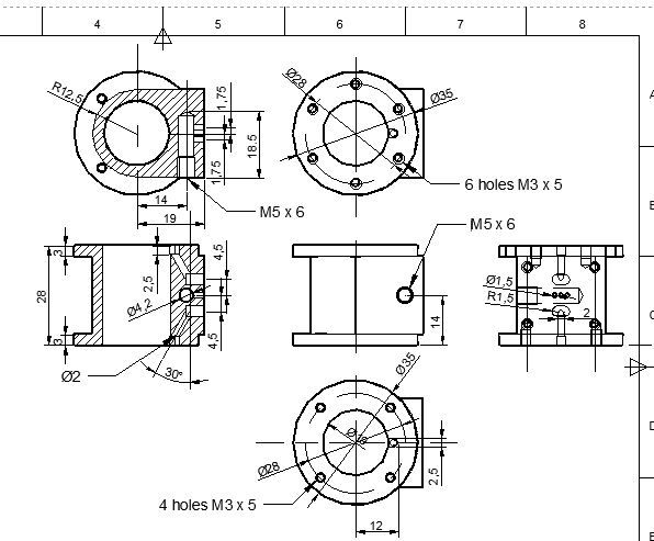

I've been looking at a better way to illustrate some processes for an article I'm considering writing and my artistic talent is absolutely minimal. My other solution has involved using GIMP to 'simplify' photographs – to give the sort of black & white style images much favoured by ME in the 50's. But I'd prefer the sort of Iso-drawings that Kozo Hiaoka uses to great effect in his books – not being able to draw by hand well is a great handicap – but I can use TC fairly fluently and this idea might just solve my problem – so thank you for the prompt!
(BTW – I know 3D CAD would solve this problem – but I'd need to learn it first and that's nowhere near top of my TUIT list!)
