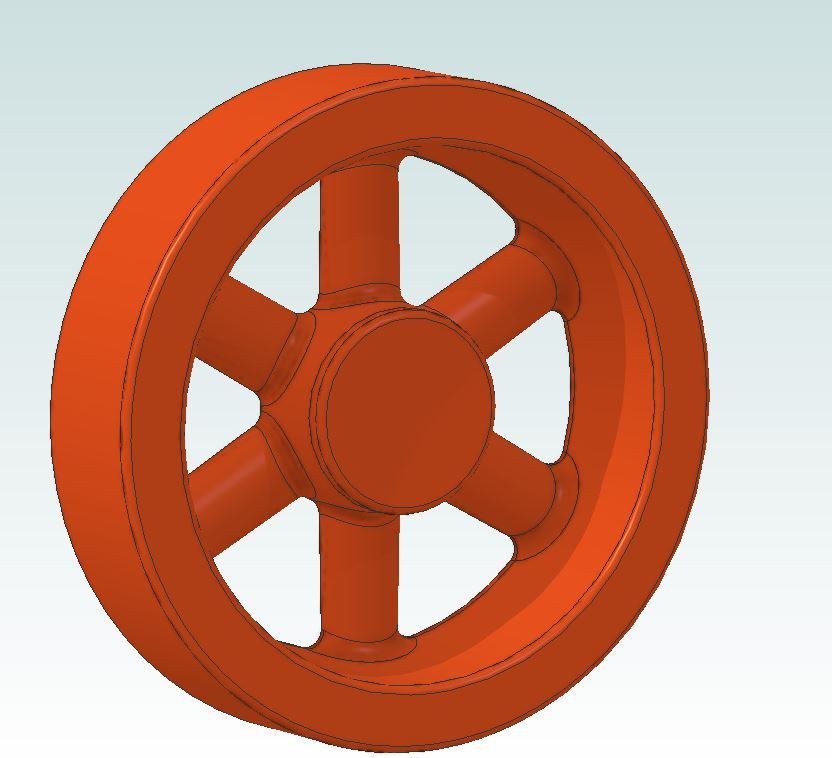

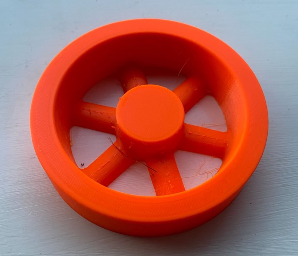

              #639246
                Could not have put it better myself.
                As an example the question of a missing pulley casting came up on MEM forum last week, someone dropped me in it saying I could CNC a pattern. I saw the post and within a few mins had put up an image of the pulley. Turns out the person has a 3D printer so a couple of mins more work adding machining allowance and draft angles and The pattern was ready to export as both STL and STP files which I e-mailed to him. He was printing within half an hour having processed the file through Prusa's own slicer software.
                Also last week I sent someone else a complete assembly of a Stuart Victoria, waiting to see how that comes out printed with a Resin Printer

                  Posted by JasonB on 25/03/2023 18:35:37:
                  As with my other recreations of long lost small engines I set to and redrew it in metric with a 12mm bore and 20mm stroke in Alibre, exporting some parts to F360 to make use of the CAM function to generate the G-code needed for the CNC mill.
                  Why do you model in Alibre and export to F360 for CAM? Why not do the modelling in F360 too?

                            Gary, having used Alibre for over 10 years I have a lot of files that I do still go back to and I'm also quite happy and conversant with Alibre so don't really want to go with something else.
                            F360 in it's non commercial form is fine for the small amount of CAM that I use it for and as I also tend to use Alibre for my work as well as using DXF and DWG output for hobby use it would mean having to pay for F360 too. At the moment I opt for the yearly maintenance for Alibre Professional and that is less than the more expensive yearly F360 licence would not really be worth paying for both.
                            I will do the odd tweak of an imported STP file in F360 such as filling in a hole so the CNC does not try to machine it out or as I have done on this bed part model the shape of the stock.
                            Ches, as David says I find a pdf output the best way to share my drawings with others and they also go to our editors for publication in the mag. This will give you an idea of the output. Though for my own use I tend to just pull the dimensions off the 3D model and sketch them out onto a scrap of paper in most cases.
