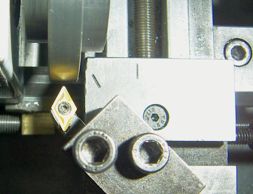

      Now that my Unimat 3 is behaving much better, I am undertaking pending tasks, one of them being a replacement for the OEM plastic drive pulley with an aluminium one.
      I am practically finished with it, with disk on dimension and only the grooves left to turn.
      I have made a copy of the original but with a couple of differences: I left some material on the ouside face of the pulley for future use.
      One possibility is to make another (smaller) groove to use if you flip it around and and another is to have where to put something like disk for a Hall sensor.
      The thing is that at this point I am at odds on how to go about making the grooves ie: what tool to use given the small space to work in even when using the small OEM tool holder.
      This is the only arrangement I could come up with with the tools I have but I don't like it too much as it would have to be finished by hand with a round file.
      I'd appreciate an opinion on this.

          Take a piece of 6mm square steel and drill a 3mm hole across it say 5mm from the end. Drill and tap a second hole M3 in from the end to meet the hole. You can now grind a piece of 3mm HSS (old ctr drill) as a cutting tool that can be held in your ned tool holder.
          I suggest you work out a set of co-ordinates to form the grooves in a series of steps as the lathe will unlikely be upto using a form tool of the required width

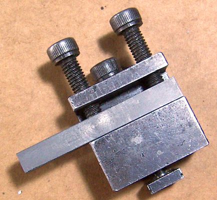

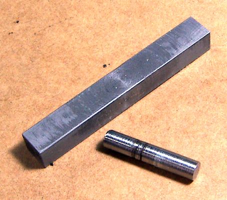

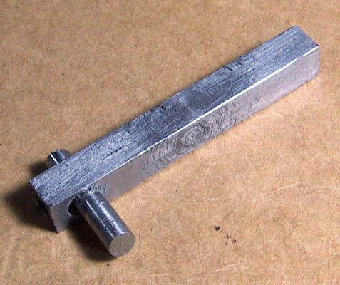

                              Posted by JasonB on 23/06/2023 07:13:17:
                              … piece of 6mm square steel and drill a 3mm hole across it say 5mm from the end. Drill and tap a second hole M3 in from the end to meet the hole.
                              Almost there.
                              All the carbide bits were ⌀ 3.0mm so I cut a 25mm piece of shank from an old 5mm masonry drill bit in bad shape. Not having suitable stock, made a piece of 7mm x 8mm x 55mm on the four jaw from an uneven piece of steel I had around.
                              The whole thing will fit nicely in the OEM tool holder:
                              The question now is what form/shape should the bit be to make the groove?
                              Thanks in advance.
                              Best,
                              JHM

                                        I would grind a 1mm radius on the end and then as I said earlier work out co-ordinates to cut each groove in a series of steps, the rounded tool will smooth the steps out better than a more angular one.

                                          Posted by JasonB on 24/06/2023 06:51:13:
                                          … grind a 1mm radius on the end and then ….
                                          Done by taking a stepped approach similar to the one suggested.
                                          This is the tool+holder as used. Not the prettiest but it worked as I intended.
                                          Some with better eyesight than what I have may notice that the bit is not at exactly 90° to the holder and that the hole is larger than the bit. Vice moved, milling table clamps are still on the to-do list.
                                          In any case, as the bit was to be registered against the one of the faces of the pulley and a larger hole did not pose a problem, that was that.
                                          The front end of the bit was ground with a slight slant (maybe 10/15°?) but left at ⌀ 5mm to keep the width of the groove constant and parallel / even. Once centered, it was very slowly fed into the piece till I had an almost square ended channel ~ 3.5mm deep, the almost due to the slant and the cutting edge being a bit lower than the centre.
                                          Granted, it is not the most orthodox technique but it worked quite well to start off the groove both parallel and at the right width in just one albeit very long operation.
                                          The use of a 6x6mm straight finishing tool with a large radius tip was the next step to gently sneak up to the desired inner radius and the rest was done by hand with the end of a rat tail file with an end that is ~ 4mm.
                                          Looking back, I could have waited to purchase a round file such as the ones used to sharpen chainsaws. They come in small diameters (5mm/6mm, etc.) and have a spiral cut pattern which will probably work for this job.
                                          I will probably purchase one for when I turn the pulley for the milling head which is also plastic. Curiously enough (or maybe not) Emco decided to manufacture it with a M12x1 mount instead of the 14×1 one used in the U3. 8^°
