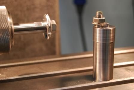

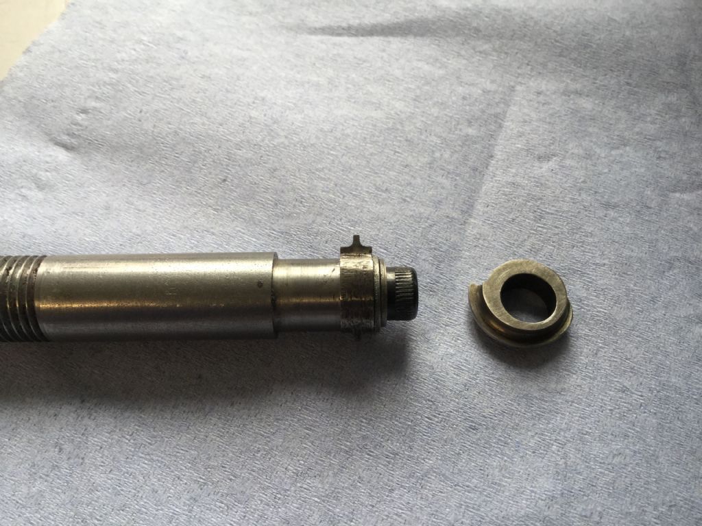

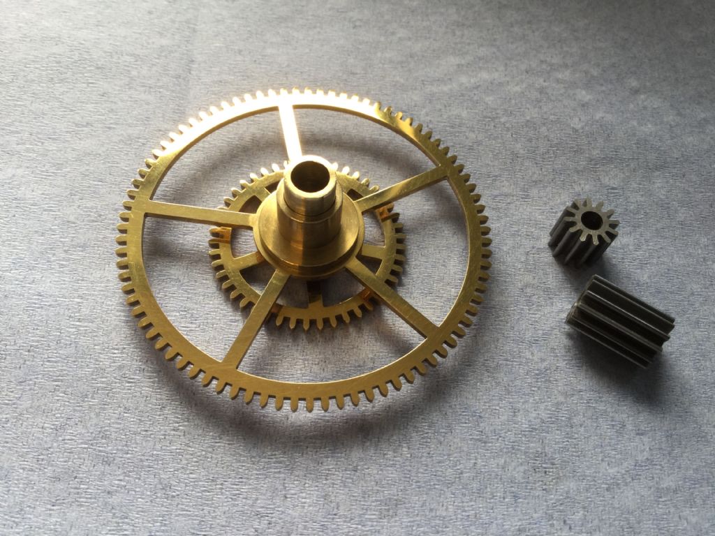

              I make all the pinions and wheels in my clocks using shop-made cutters made from hardened/tempered silver steel. I usually cut pinions from silver steel, but sometimes I use EN8. Cutting pinions this way is a slow job. I typically run the mill at around 200rpm, and take 2 or 3 passes with plenty of cutting oil. Picture of one of my cutters and examples of wheels and pinions below.
              Mike

                Some very nice work there Mike, especially since you made your own cutter.
                Emgee

                    As Mike Crossfield has shown … it is perfectly possible to cut a pinion with a fly-cutter
                    Success comes down the selection of appropriate speeds and feeds : which will, in turn, depend upon the actual materials [sadly, some Silver Steel is better than others] and upon the detailing of the cutter.
                    One chap I know has moved to fly-cutting all his wheels and pinions, but he also makes the cutters from HSS.
