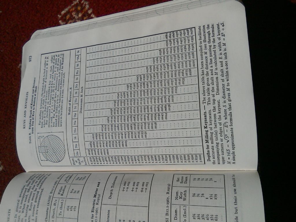

          Do a number of different depths so that the first cut is not too deep. Measure the difference in height between the first and last tooth and this is the difference between each slot depth.
          img_20170414_152414.jpg.
          Martin C
          Machinery's Handbook has, for 3/4" and 1/8". I will add a picture of the table.
          Edited By Martin Connelly on 06/05/2020 15:24:09

              A 6mm key way, tangental depth in the shaft is 3.5mm +0.1, and in the bore is 2.8mm +0.1.
              In simple arithmetic, if 19+2.8 is depth across the bore, minus 16.66+1.46, then the thickness left in a 19mm plug is 3.68mm.
              In reality the depth of the keyway in the hub doesn't matter, so long as it is deep enough for the key to fit in. Keys are normally side fitting, with clearance at the top and you could always file the top off the key if it is too tight.
