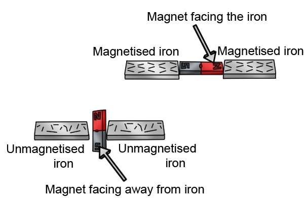

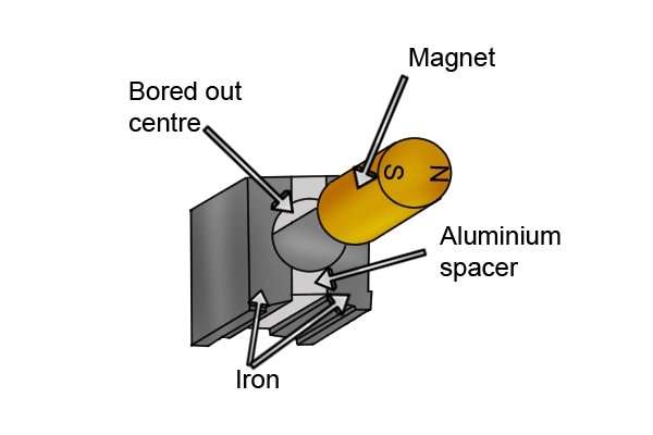

              Steve’s post deserves more attention!  This type of magnetic base does not have a keeper, and I believe it’s the most common.   Unfortunately, I can’t prove it by taking mine apart – can’t see any screws, and suspect it’s a press-fit assembly.  I don’t want to break it.
              HSMag’s description appears to be a shortened version of that on wonkydonkeytools, which has more diagrams.  This pair I think shows more clearly how moving the magnet magnetises the base, there is no keeper:
              3MB-4-4
              magnets
              The absence of a keeper is counter to what I was taught at school, but in later life I found many examples of lessons that were too simplified, or out-of-date.
              Early magnets weren’t made of the best possible materials because they hadn’t been discovered yet, and permanent magnets demagnetised.  Their decay was slowed by completing the magnetic circuit with a keeper.
              Poor magnetic materials caused a lot of problems, such as failing magnetos,  so materials scientists have been looking for improvements for over a 150 years.  Very successfully, first with a basic AlNiCo, then a series of improvements, ending with today’s Rare Earth alloys.   Modern materials demagnetise very slowly, so the need for a keeper has diminished, perhaps to vanishing point.  However, the need for a keeper is embedded in folk-lore and it’s “not wrong”.
              I don’t think there’s a black and white answer.  There’s a good reason for putting keepers on ancient magnet bases, and good reasons turning modern bases off, even though that means there’s no keeper.   It depends on what the magnet is made of and what the designer allowed for.

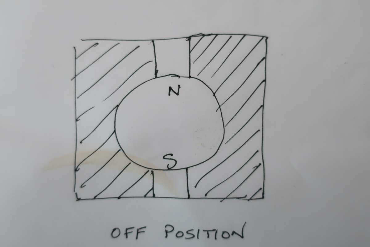

                Re. “This type of magnetic base does not have a keeper” …
                ..this is what it looks like in the off position..
                IMG_2684

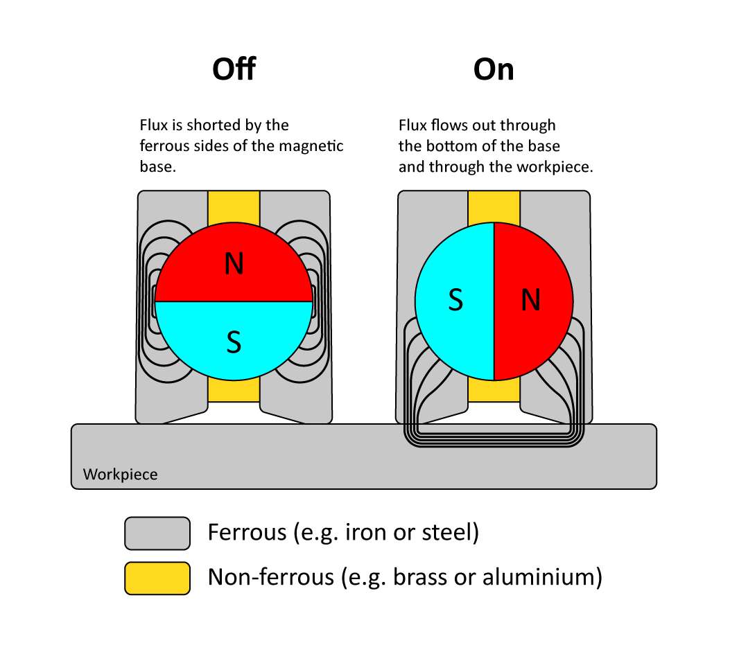

                    There is a keeper built in to rotary-switched magnetic bases. So you can leave them switched off in a box with no keeper, or standing on a piece of steel or iron switched on. Below diagram makes it a bit clearer how that works.
                    mag base
                    The push button ones work similarly, but axially rather than radially. The magnet is bobbin shaped. North and South poles are respectively each raised end of the bobbin. The brass separator plate is rotated 90 degrees to match. When you push the button so the two poles are either side of the off-centre brass separator, the magnet is “on”.  Push the button the other way to “Off” and both poles are on the same side of the brass separator, so the iron body acts as a keeper. Thus, like the rotary type, it can be stored switched “Off” , or stored stood on a steel plate and switched “On”.

                          This cleary shows that there are TWO kepers, one each side. The null point is across the diameter of the cylindrical magnet. So in the off position it is shunted by the pole pieces on each side.
                          Robert.

                              .. …This cleary shows that there are TWO kepers, one each side.. ..

                                          Thanks guys. Seems to have cleared it up. Reading the Image Posting thread, I think I erred by editing my original post and in the process deleted and re-uploaded the image. Seems others have had problems with this not working. So a case of do it right and do it once, or else! No editing.
                                          I thought it was worth pursuing because this diagram does show more clearly how the magnetic flux flows in the rather unusual instance of a round magnet, rather than a flat bar type.
                                          Those wishing to remagnetise one of these would have to be very careful to get the N and S poles correctly aligned with the on/off handlle, but of course there is no easy reference point on a round magnet, no ends like a bar magnet. Even the push-button mag bases are easier. The cylindrical bobbin-shaped magnet there has N at one end of the bobbin and S at the other. Very easy to remagnetise.
