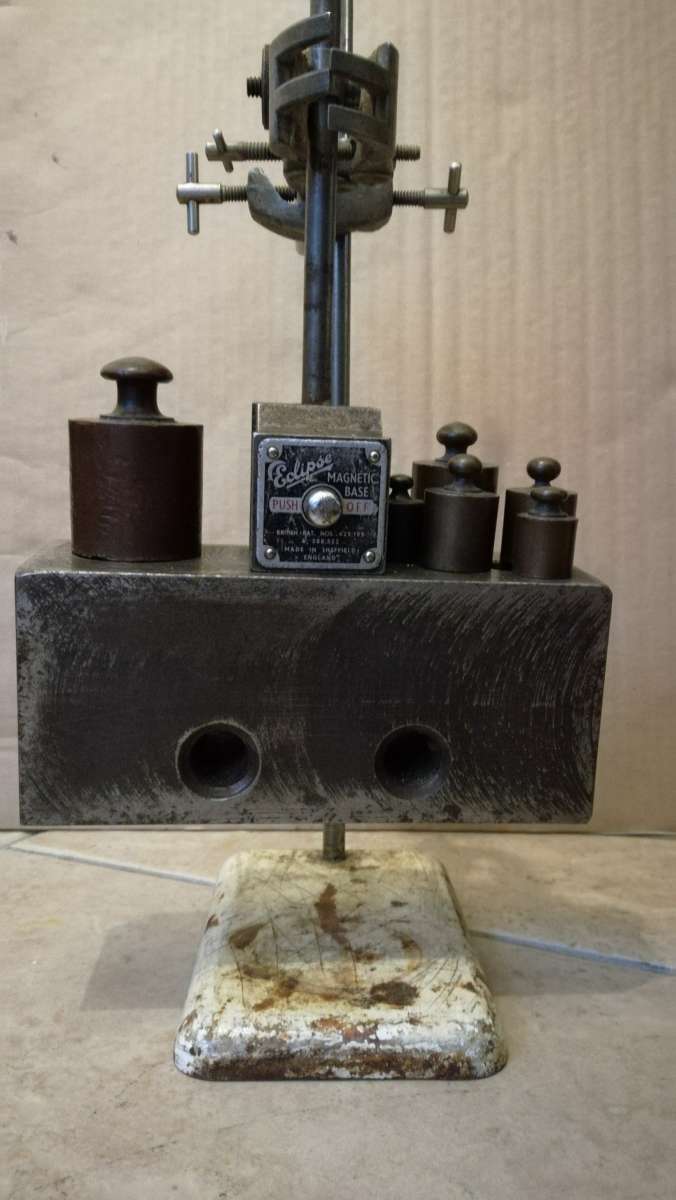

                                          Hi, here’s my Eclipse No. 903, which is over 55 years old, which has been stored mostly with it switch off, as it tends to return to the off position when it isn’t attached to iron or steel, but it has also had some long periods switched on on steel. It’s holding just a little over 6 kg. Although the surface on the block is flat, it does have very shallow machine marks on it.
                                          Magetism
                                          The big block weighs a little over 5 kg, and all the other weights sitting on it, add up to 1 kg, with the one on the left weighing 500 grams.

                                            Lower the clamp stand a bit, Nick.  The base is most likely cast and may not like a 6kg lump falling on it from even at the height shown!

                                                  Nicholas Farr
                                                    @nicholasfarr14254
                                                    Hi NDIY, well it didn’t drop off, and it takes just about all my effort to pull it off, which is much more than the 6 kg that is in the photo.
