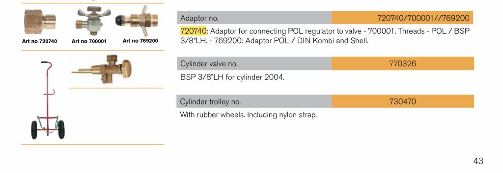

                          My apologies for not being more explicit. I assumed when I said propane tank in the title it would be apparent that the 3/8” thread as well as the POL would necessarily be left hand.
                          The POLx3/8 having a Sievert part number is useful for further searches, so thanks to both of you for flagging that.
                          If I decide not to stump up for the Cromwell item, and can’t find it at a modest price elsewhere I may resign myself to continuing to use the particular torch it’s for with Bernzomatic style cylinders rather than Calor propane cylinders as well.

                            Just for clarity … here is the beast, with Sievert’s description
                            Credit: https://sievert.se/wp-content/uploads/2014/11/Sievert-International-Catalogue.pdf
