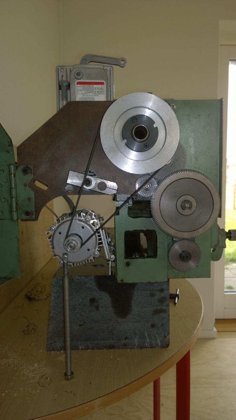

                  My WM 250 lathe has 27mm/MC4 spindle and is driven by a best german 1.1kW fourpole motor from a HuanYang VFD.
                  Power and torque has been very satisfactory.
                  Bed is 140mm wide.
                  My 918 has 100mm wide bed and met an industrial sewing machine motor 600W/4Nm torque/100-4500 rpm.
                  The motor is a three phase,has permanent magnets and cannot be stalled at low speed unles I thigthen the belt to a silly degree.
                  I am ordereing a 1500W/7Nm/100-3000 of same familly for the WM250.
                  The DB 10 from Chester is more like the 918 I think.
