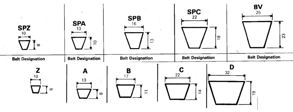

                                          Nicholas Farr
                                            @nicholasfarr14254
                                            Hi John, below is a photo of standard belt sizes.
                                            Do make sure that non of your pulley grooves are badly worn and that any belt you use is not running on the bottom of the pulley groove. Vee belts should never be drum tight.

                                            John Haine
                                              @johnhaine32865
                                              Thanks Nick. Well, that seems clear then, measuring the width of the top of the vee groove on the pulley it is very slightly under 10 mm so it is unlikely that the 13mm belt that RDG sell as suitable for Myford is actually suitable for the newer big bore S7. Actually looking closely you can see the belt virtually riding on top of the pulley rims, so there is very little actual surface area to give friction and therefore drive. Lathes.co.uk also quote A-section for the h/s drive belt but on the newer lathe it should be Z-section it would seem. Bricky seems to have had problems with z-section Powertwist so I'm inclined to try the more expensive T-link, still cheaper than getting the service engineers out and worth a try as an alternative to dismantling the headstock for an endless belt. As they say, when you're up to your a***e in alligators it can be hard to remember you set out to drain the swamp!

                                                John Haine
                                                  @johnhaine32865
                                                  Thanks, T-link Z section I think it will have to be.
