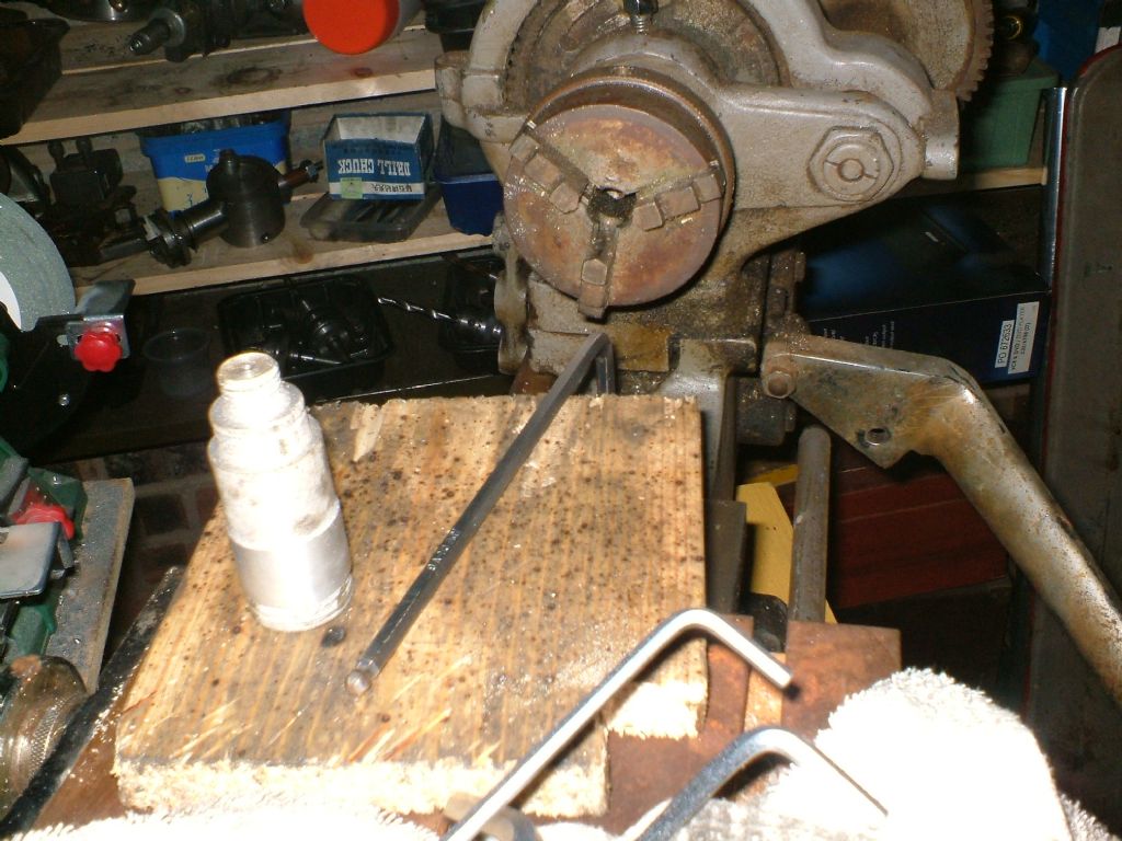

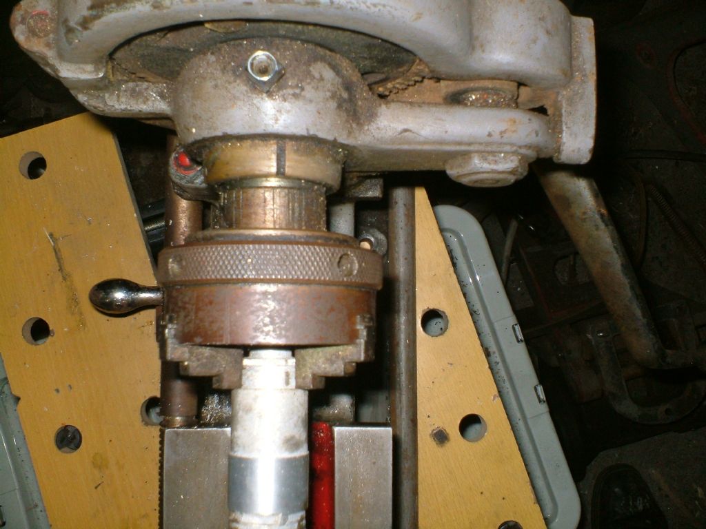

        Just got a new pal, Drummond number 2 which was saved from a house clearance not too far from me
        Plenty of work to do to get her going again but problem number one was a nice looking original scroll chuck still holding its workpiece from possibly decades ago and not keen on letting go
        Suggested solutions to this problem are entertained, I have a large hammer ready to batter the workpiece from side to side
        The register part has marks which look like they've used some sort of grippy thing to screw her on too, tsk tsk tsk

              You need a spanner on one of the chuck jaws and a C spanner in the hole. Make sure one is braced against something solid and tap the other one in the correct direction. The should be after applying some sort of penetrating oil as suggested above. Figuring out the correct direction may be tricky unless you can see part of the scroll somewhere.

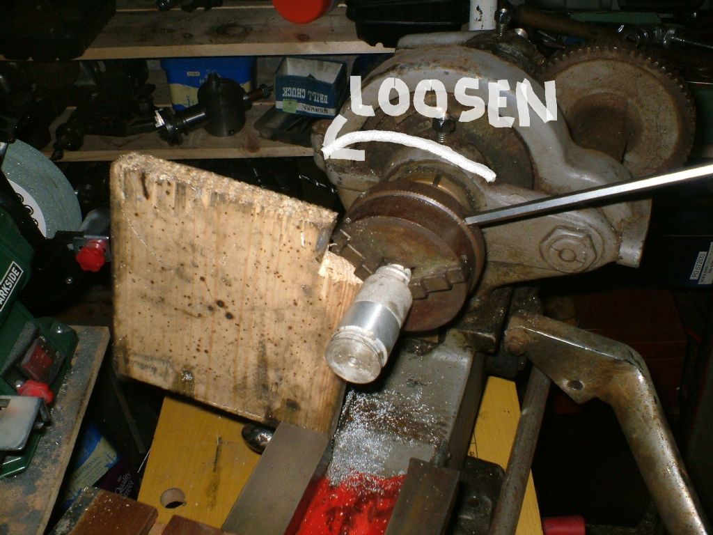

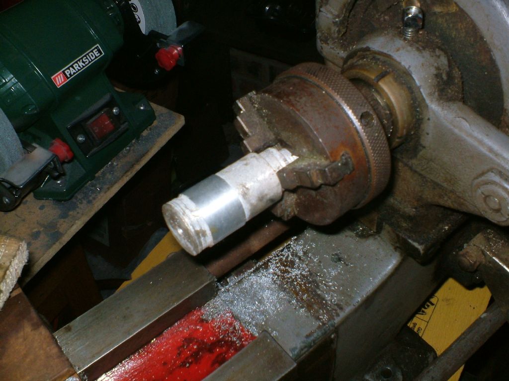

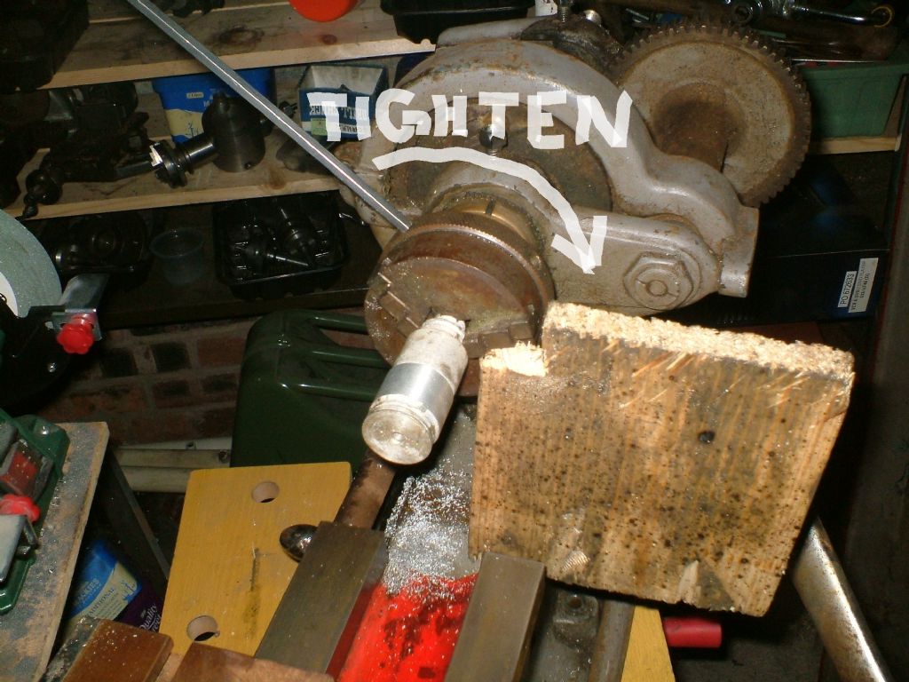

                    I found my cowells chuck, looked at the scroll and managed to get a result
                    Put a block of wood from the lathe bed to beneath the chuck jaw, no violence required

                      It also occurred to my teeny brain that I should have been using this system for my unimat scroll chuck from the very beginning and ignoring the front chuck body hole
