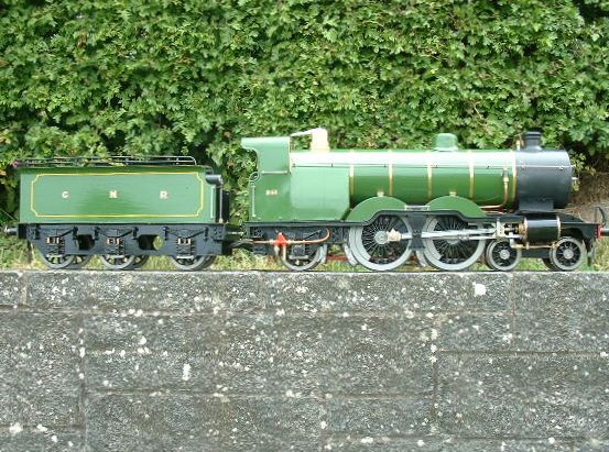

              Hi Bruno,
              I built Maisie over 30 years ago and I remember that LBSC specified automatic drain cocks,
              these are basically small spring loaded safety valves, I feel sure that they were mentioned
              in the book and also the drawings.
              Bert Ashton.

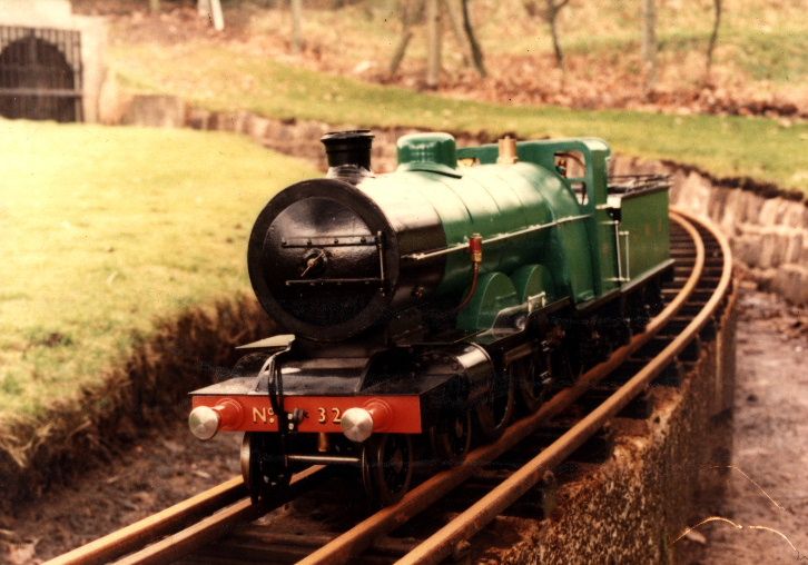

                  Hi.
                  I fitted the drain cocks as the book on my Maisie ( Now sold ) they are operated from the cab by a lever on the left hand side, connected to a rod which runs on the inside of the frames which connects to a bell crank fitted to a shaft fitted across the frames and has drop arms on the outside of the frames that operate the drain cock slide rod which lifts the drain cocks open and by way of it's shape lets them drop back down to close.
                  In the picture you can see the drop arms and linkage for the drain cocks.
                  Michael.
