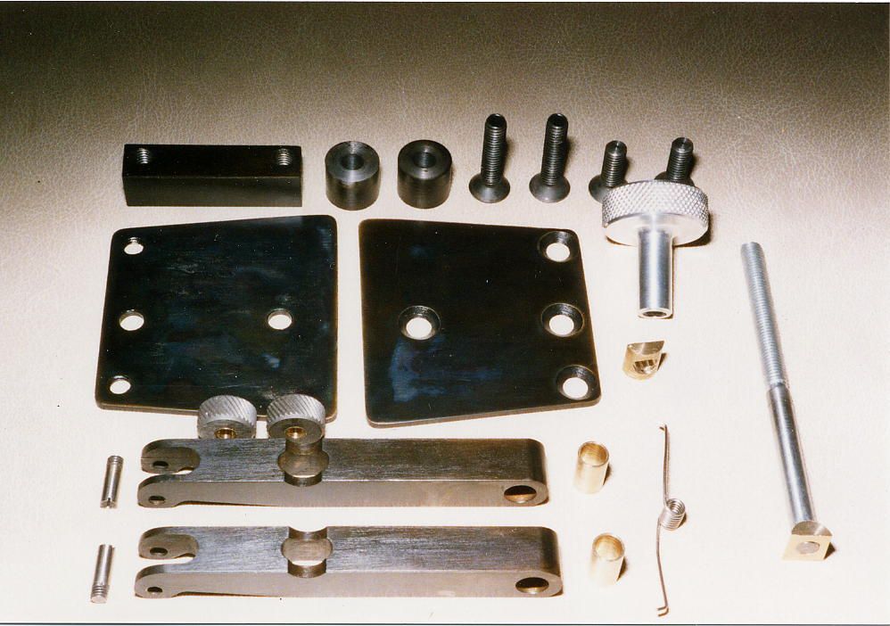

                    #131446
                    _Paul_
                      @_paul_
                      I built mine from scratch in around 4 hrs or thereabouts a bit at a time as the parts/materials came together.
                      Examine/zoom the knurling on the handwheel thats the quality it will produce.
                      Here is what you get in the Hemingway kit

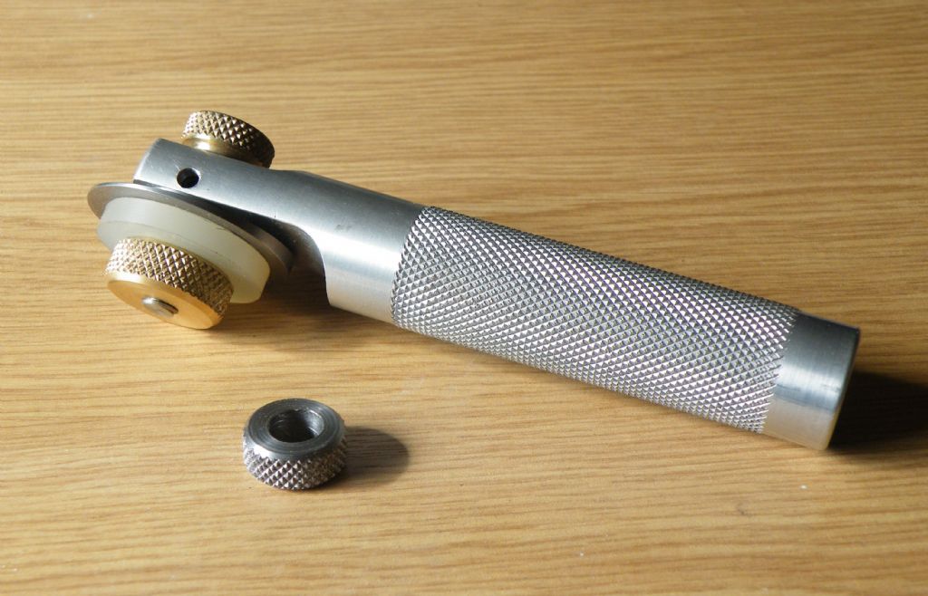

                              Sub Mandrel
                                @submandrel
                                I haven't got the face to post a picture of my clamp knurler after seeing Gray's. It was my first tool more complex than a d-bit, made around a bit of a broken display stand. It self centres and works, and now fits my QCTP as well. But it looks 'orrible.
                                To engrave my Meek-designed saddle dial I had to make a simple push in knurl, which worked fine – just a bit of bar with a fork in it and a hole for a spindle.
                                Knurling

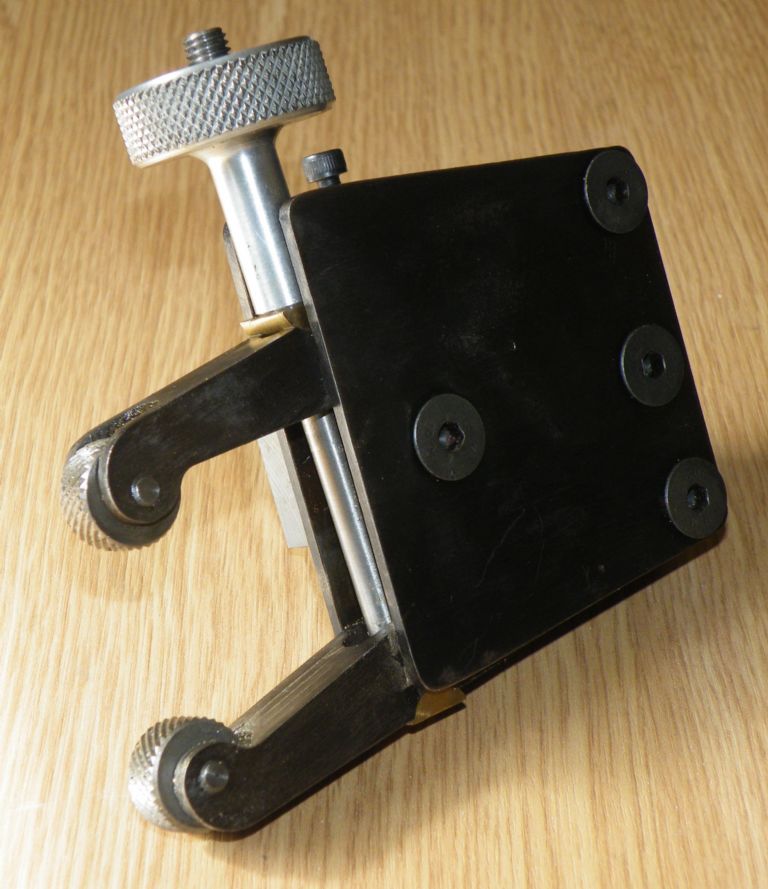

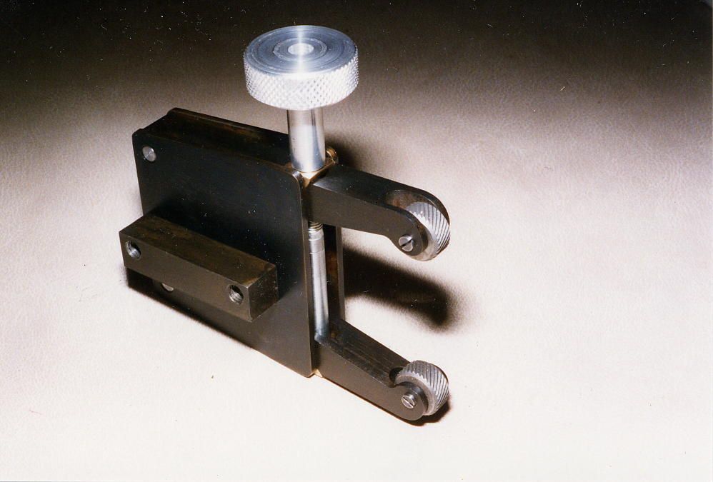

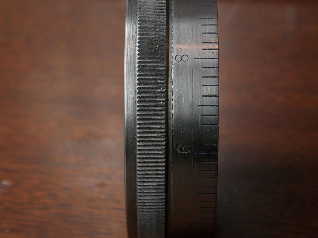

                                      #131788
                                      Gary Wooding
                                        @garywooding25363
                                        Here's a knurler I made some time ago, together with a couple of examples of the results it produces. Full details of its construction were published in issue 72 of MEW.
                                        Gary
