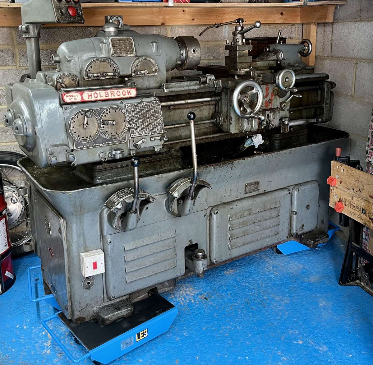

      Hi… as per the Topic Title… the lathe has the usual covering of gunk, ranging from light oil to quite heavy grease (mainly on the bed that the taper-turning attachment sits)…
      Is there an ideal cleaning solution that’ll shift the more stubborn deposits??
      IMG_8854
      I have yet to delve into the innards of the machine, but anticipate plenty of oily dust, & a suds-tank that’ll be pretty dire.
      Any recommendations?? TIA 😎🇬🇧👍

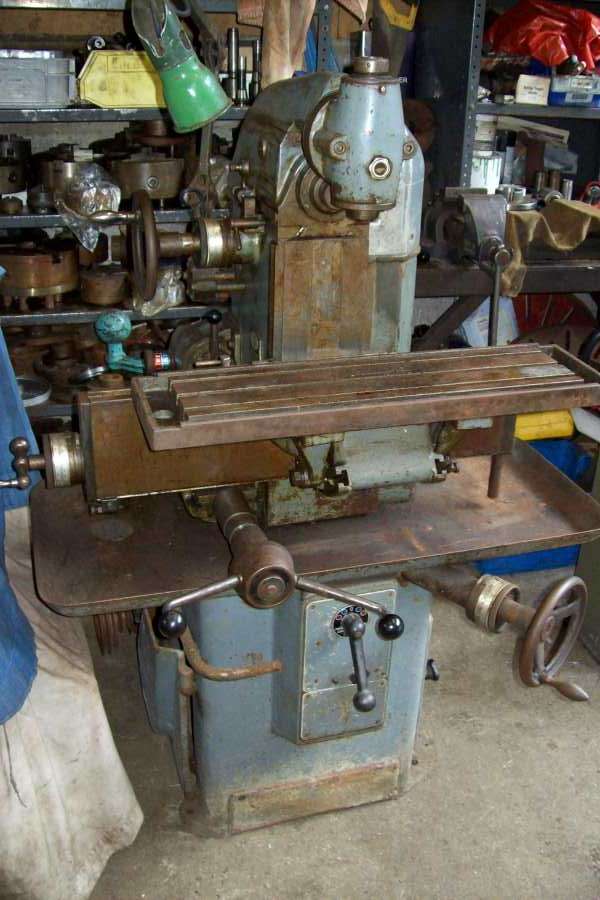

          F3 reduced
          I’m in the process of cleaning up the above mill, unused and covered in a thick oily grease for thirty years, it seems like it might be Waxoyl or Ensis, but whatever it is it’s the devil to get off.
          Best results so far, and I’ve tried brake cleaner/duck oil. WD40, paraffin, panel wipe, are with Jizer, the one in the green tin, hasn’t so far affected the old paint, and Screwfix no nonsense degreaser (which is water based so not suitable everywhere). Bought some cheap sets of small wire brushes, a bit like big toothbrushes in steel brass and nylon which have proved very useful. Hard work but very worthwhile especially for a Holbrook used a 13″ swing one at work, one of my favourite machines. Good luck. when theres an adult home I’ll try to post a picture of progress so far.

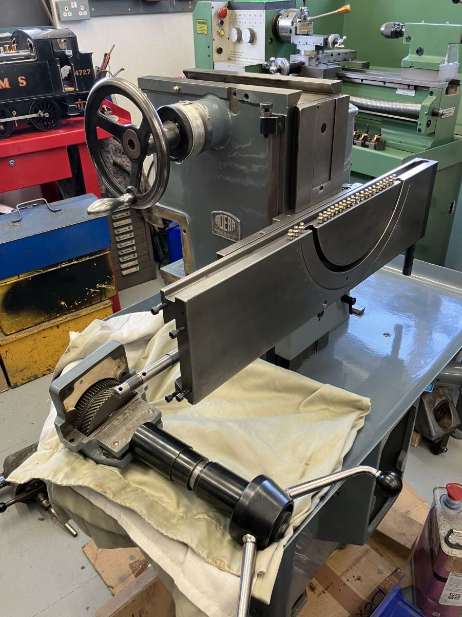

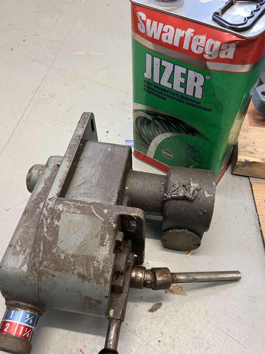

              Hopefully a couple of pictures attached one before of the feed gearbox and the Jizer I’m using, has proved quite effective and although using outside has no detectable odour or fumes, the old fashioned Jizer had a strong smell to it. And an after of the machine cleaned, repainted and being reassembled, had to completely strip it as some clown used thick grease in all the oiling points, which had hardened over the years making removal difficult. The little things that look like teeth on the horizontal slide are the replacement oil nipples which have just been turned down as a push fit to replace the original 7mm push fit oilers.IMG_2027IMG_2026
