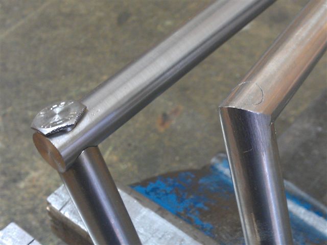

                As it happens I have just joined two SS bars at 90 degrees. On bar has a concave recess cut after drilling and tapping axially. The other bar is crossdrilled and counterbored to take the head of a turned down hex bolt that was then filed off flush. I was pleasantly surprised how strong the resulting joint was.
                Ian

                  I forgot to say, in the picture above the bar is 16 diameter and the bolt is M10.
                  For 10mm diameter bar I would suggest using M6 with the head diameter reduced to 7 or 7.5mm.
                  Ian

                    Ian, that look like a nice job, that is the way I'll go.
