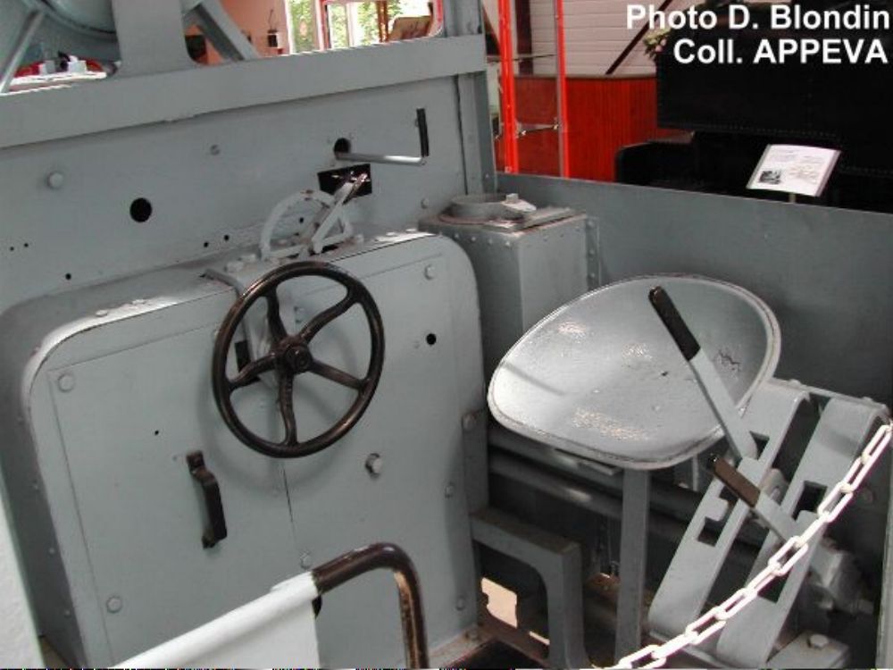

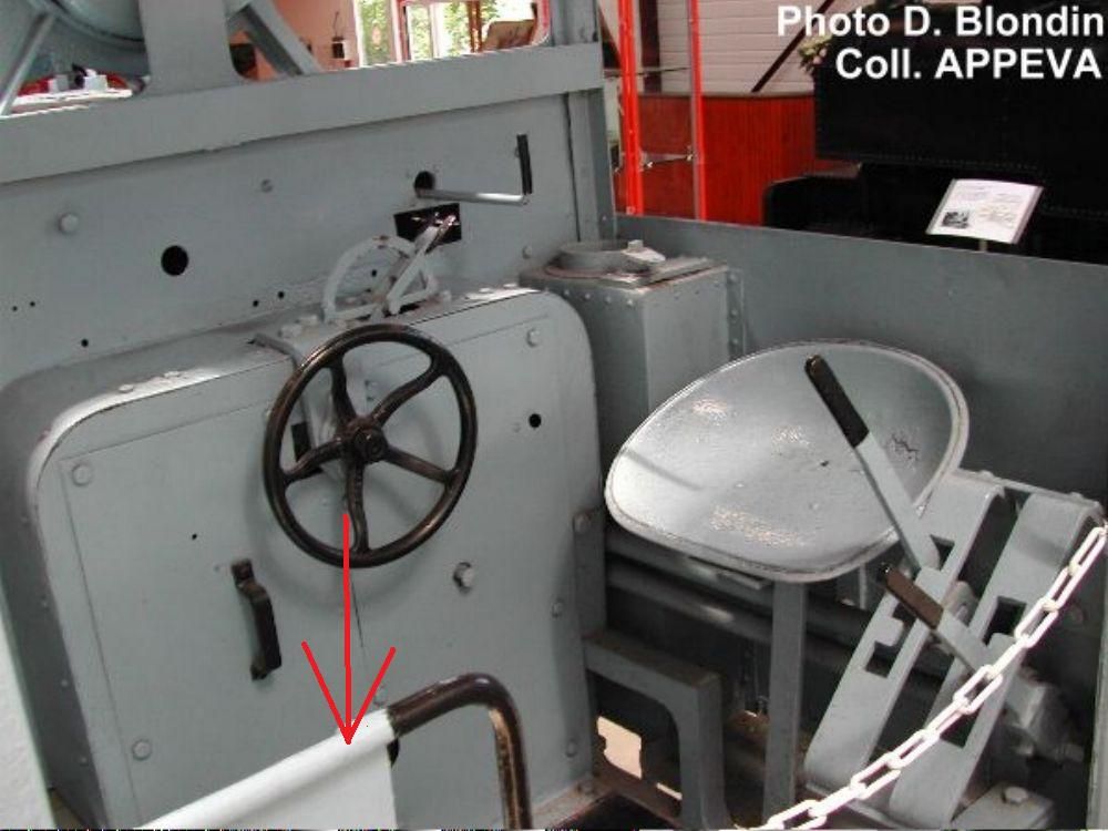

                        It is a Baldwin WW1 Gas Mechanical. The beading is most certainly half round in the literal sense and actually forms handles on the edge of the cab where two are applied to inside and outside od the sheet metal. This is really why I'm bleating about making it.
                        Steve
                        #222885
                        Steve Addy
                          @steveaddy35670
                          You can see what I'm on about in this shot of the prototype cab.
                          Edited By Steve Addy on 27/01/2016 23:38:14

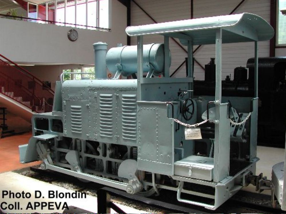

                          #222887
                          Steve Addy
                            @steveaddy35670
                            This is the whole thing for the benefit anyone curious about this thing.

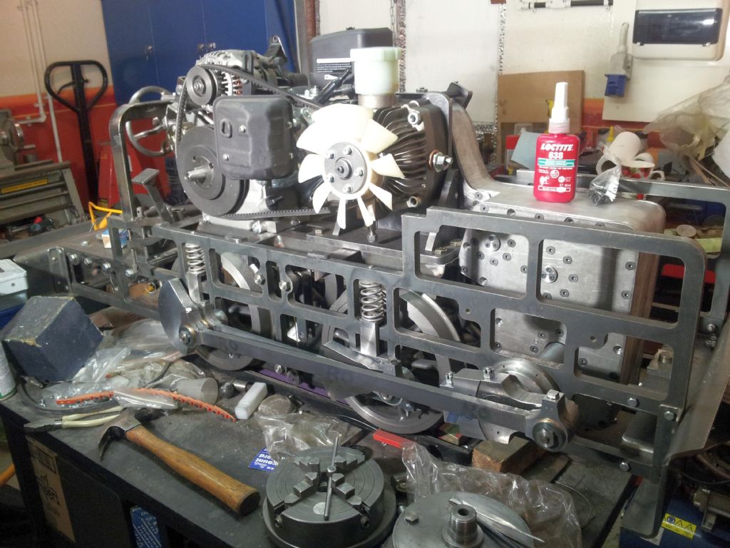

                            Steve Addy
                              @steveaddy35670
                              This was the model about 2 years ago with the gearbox newly fitted along with the cranks and rods. The air cleaner assembly has since been replaced.

                              Ady1
                                @ady1
                                What? Where? Uh?
                                (I'm the guy who asks questions others are afraid to ask.)
                                I can stick a big fat arrow on the JPEG if I know what the issue is
                                (The only beading I know is wooden beading glued to walls)
                                Edited By Ady1 on 28/01/2016 01:09:20

                                  Or you could soft solder or glue the 5mm round to a length of board, steel or whatever and run it across a belt linisher until you get it down to size. Might be quicker than milling it a few feet at a time if you need large lengths.
                                  #222893
                                    ADY1 you are the guy that needs to go to specsaverssmile p
                                    I would also favour the soft solder method, I have done that a couple of times when making brass mouldings. Another option would be to bet some 3/16" flat bar and use a woodworking router bead cutter to put a 1/2 hound on teh edge then cut it off with a slitting saw, keep repeating. I often do this when making wooden moundings.
                                    Something else to think about is a moulding box. In this case a block of metal drilled horizontally for your round stock held in the mill vice. Then plung vertically into it with say a 3/8" slotdrill stopping on the ctr line of teh 5mm hole. Set the mill running and push your rod into the hole as its fed in the top half will be milled away.
                                    Edited By JasonB on 28/01/2016 07:36:20

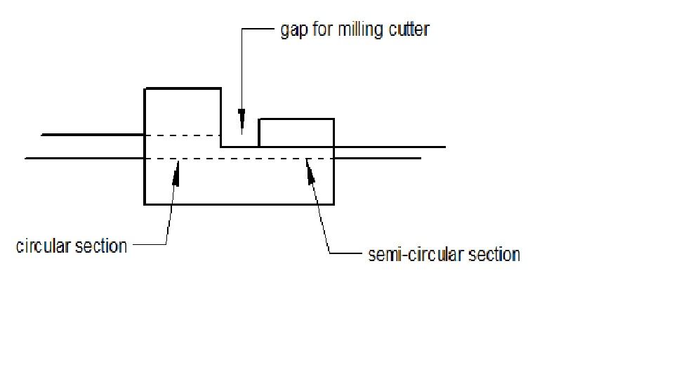

                                        Michael Cox 1
                                          @michaelcox1
                                          Hi Steve,
                                          I have never tried to do this but I will suggest a way that might work.
                                          Take length of steel bar and bore a 5 mm clearance hole through the it. Mount the bar on the milling machine so that the hole is horizontal and machine away one end of the bar to expose the hole. Continue milling down until the hole is bisected. Make and mount a steel cover over the bisected section but leave a gap between it and the unmilled section.
                                          With this mounted on the mill set the milling cutter running in the gap and push the 5 mm steel bar through the hole. As it passes the milling cutter it is cut to half the thickness and then enters the semi circular hole on the other side. The semi-circular hole stop the bar from twisting. Out of the end of the semi-circular hole will come the half round material.
                                          As I said, I have never tried to do this so iI do not know if it will work but it might be a way forward.
                                          Mike

                                            KWIL
                                              @kwil
                                              By Jason's Red arrow.
                                              There does not seem to be any change of diameter of the round section as it pases from handrail to capping on the cab side, looks more like the panel could be inserted into a milled slot on the underside of the rod?

                                              Michael Cox 1
                                                @michaelcox1
                                                half round jig.jpgHi Steve,
                                                I have made a drawing that may clarify my idea for a jig.
                                                Mike

                                                  Some ideas above seem impressively ingenious but I can’t help thinking that some devices might constantly jam up with swarf especially if milling dry or bottle-dribbles. I think a full flush of cutting fluid would work best. What do the team think?

                                                  Ady1
                                                    @ady1
                                                    Thanks Jason, hadn't a clue what was going on there

                                                      DMB The moulding box method I suggested which is the same as Michael's I use quiet often for small timber mouldings and don't have a problem with sawdust clogging but agree swarf or a burr may jam thinds up and it would be easier done on brass than steel.
                                                      For anyone wanting to make larger flat section then this is a good nethod.
