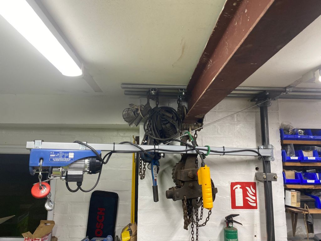

                          I needed a crane to pick my indexer on its mounting plate which weighs around 90Kgs. The indexer along with rotary tables are on a trolley. The crane is used to pick them off the trolley and lower them onto the mill table (table being moved to extreme left hand position. I had an Aldi/Lidl hoist and bought a jib from Ebay. I needed longer jib than that supplied so swapped out the inner section for a longer one. I would have liked it longer but decided this was not a good idea. One of the guys on this site did some calculations to confirm it would handle the load.
                          The steel scaffold pole is located in a metal plate on the floor and the upper location is provided by a steel plate bolted to 41x21mm thick wall Unistrut. The each length Unistrut is bolted to at least three roofing joists and is also clamped to and supported by the overhead RSJ girder.
                          It had a little more flex that I liked so a large steel clamp was machined up and bolted to the wall with long rawlbolts.
                          It may not look over pretty but certainly works.
                          If you want a 2 metre reach I think you will have to significantly increase size of support pole and beam.
                          Colin
