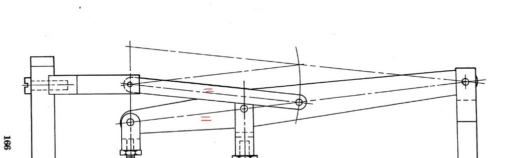

                            I looked at this a bit more and he has also used the 4.25mm hole and a 4mm pin on part 03 which is the fixed pivot for the two links so a second item that will knock and the combined total of the two will give the missing 0.5mm from the length of the beam.
                            Geoff, how many parts have you made so far? Changing the beam looks the best option but it may also be possible to change the two side links which have less work in them.
                            If one takes a look at Elmers GA you can see that the vertical line that the piston rod moves in forms the base of an isosceles triange( two equal sides) with one of the longer sides being the link and the other the end of the beam to the hole where the link fits. As the piston rod goes up and down the base of the triangle will alter and as the two other sides are equal all will move a sit should. On Julius's one you will reach a point where the whole thing locks up as his will form a scalene triangle ( all three sides different length)
                            And for Michael's further enjoyment Elmer notes the holes in the beam and the pins with a circled "C" next to their diameter for "close fit"

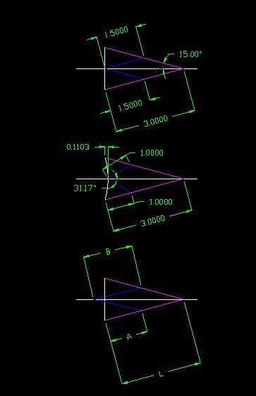

                                      duncan webster 1
                                        @duncanwebster1
                                        Posted by JasonB on 16/10/2022 07:51:06:
                                        Edited By JasonB on 16/10/2022 08:03:07
                                        Jason's explanation only works if the connection to the main beam is exactly half way along. You can make it work (not quite as well) with the connection not at half way, but then the fixed point of the short link is not on the piston rod centreline. I'll work out the general relationship if anyone is interested.
                                        #617508
                                          It can work anywhere along provided the link Ctr to Ctr is the same as the distance from end of beam to where the link attaches to the beam as it will still have two equal sides to the triangle.
                                          Interested to see how your thoughts work out Duncan
                                          Edited By JasonB on 16/10/2022 16:09:13
                                          #617522
                                          duncan webster 1
                                            @duncanwebster1
                                            The top picture has the connection to the beam (cyan) at half way position, and the correcting link (blue) equal to half the beam length, The right hand end of the beam is constrained to move in a straight horizontal line. The left end of the beam where the piston rod connects moves in a dead straight line. In the second picture I've moved the connection to the beam to 2/3 the way along the beam, and made the correcting link 1/3 of the beam length. The angle of the correctig link to horizontal is now 31 degrees, and the left hand end of the main beam now moves in a shallow arc. With the beam going 15 degrees up and down, the error is 0.1103. If the beam were just anchored at its right hand end, the error would be 3(1-cos(15))=0.1022, so this is not a good linkage. The third picture shows a linkage with the anchor point for the left hand end of the correcting link moved off the piston centre line. The text book relationship is B=(L-A)^2/A. If I plug in L=3, A=1.4 I get B=1.829, and the right hand end of the beam moves in a very shallow arc, the error being 0.0002 according to the CAD, which isn't bad.
                                            By playing tunes with the link lengths, you can get it to generate a long radius arc, which could be of use in some applications.
                                            This linkage is attributed to Scott Russell. I'm not sure whether this is the same chap who constructed the Great Eastern. It forms the basis of Joy's valve gear
                                            Edited By duncan webster on 16/10/2022 19:29:54

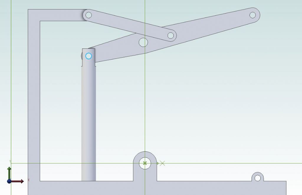

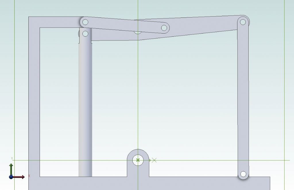

                                              It gets more interesting when you add the vertical link on the right which is often a ladder or cross braced part.
                                              As the top hole in this vertical link moves in an arc there is a small amount of vertical movement where as the half/half proportion wants the right hand end of the beam to move horizontally.
                                              Alibre seems to allow it to only move a certain amount, this is about the maximum it will go above or below horizontal.
                                              If that link is removes the beam can go to whatever angle you line and the right hand ends still remains at the same horizontal height.

                                                  I found similar playing with the #37 grasshopper some more, if I added a couple of microns tolerance to the beam/vertical link joint then it could be fully animated so allowing for the clearance that would be needed in all the pivots there should not be a problem if link is half beam distance.
                                                  #617583
                                                    Posted by JasonB on 17/10/2022 10:03:08:
