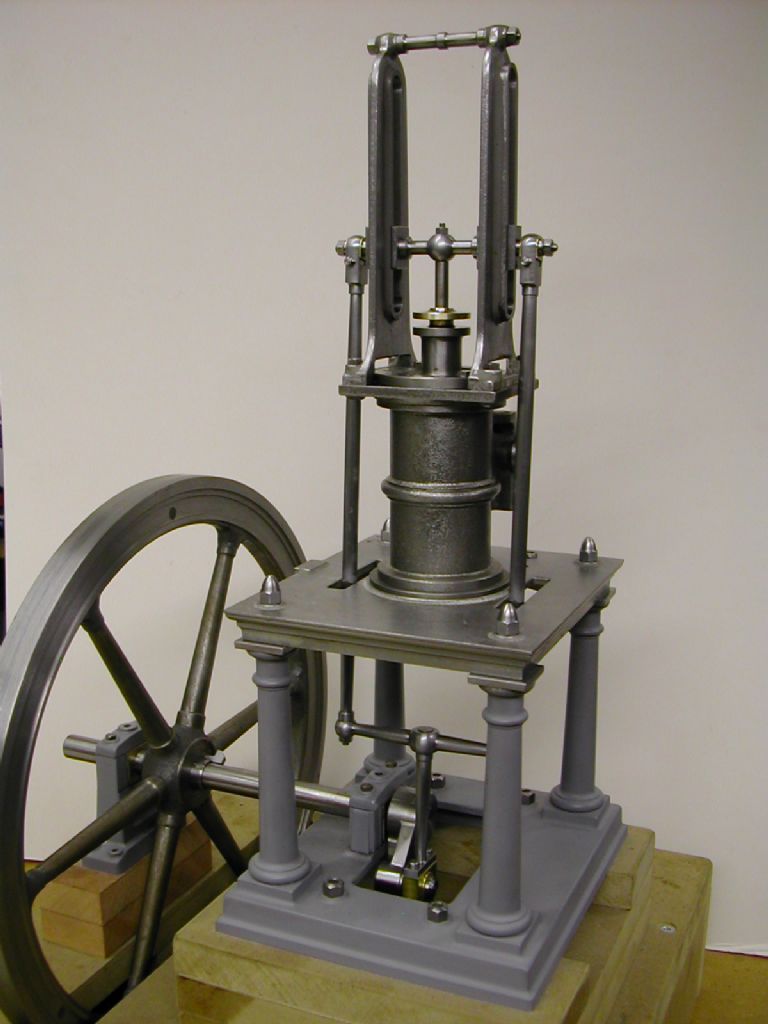

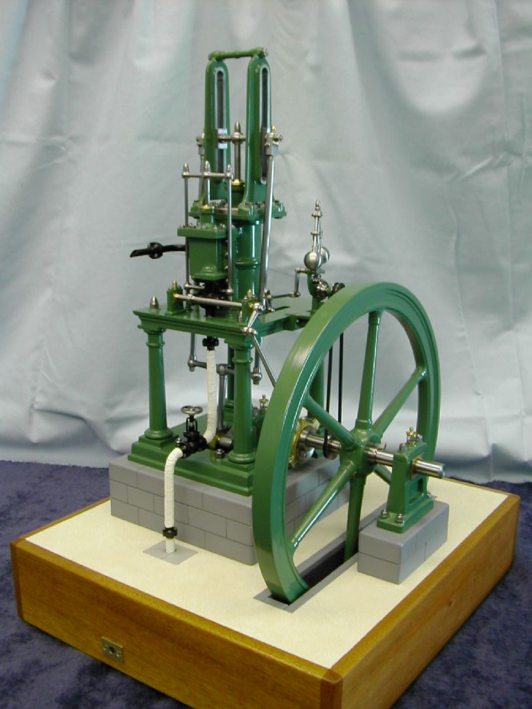

      Having enjoyed the "reinvented" Stuart Real project last year and seeing Jo's current bulid I thought that their James Coombes could do with a similar treatment to bring him into the 21st century. So I set to with a copy of Andrew Smith's book which is the cheapest way to get a set of the drawings and redrew it in Alibre to use mostly barstock and to metric standards. Some of the main points I wanted to address were:
      -Do away with the cast box bed and outrigger bearing support and mount the engine on a "stone" plinth
      – The sole plate and table on the stuart are just bits of flat 3/16" plate so these to be made to look a lot more like castings and generally more appealing to the eye.
      – Similar with the plain columns to be replaced by ones with classic bases and capitals
      – Do away with the soldered conrod which may put people off and not easy to solder it up true
      -Do away with the clumsy bolt together eccentric rod and replace with a single straight piece
      – Add decorative bands to the cylinder as I was not going to timber clad this one and do something with the inlet as I don't like that going in via the valve chest cover. And while I'm at it get rid of the chunky exhaust flange.
      = Generally add a bit more detail but not go as far as things like fluted columns, wedged and cottered straps etc otherwise I may as well just build a Waller Table Engine.

            The columns seemed the next logical item to make. Starting with four pieces of 12mm steel bar The ends were centre drilled, quite deeply at the bottom so that a ctr would still engage once it was drilled and tapped M5 for the CSK screws that will attach them to the bed and I also turned a short 8mm spigot to locate the columns in the bed. The tops were turned down to 4mm and threaded.
            After that the embryo columns were mounted between ctrs with the tailstock one being held in my boring head so it could be set over for taper turning. The next couple of photos are a bit blurred but it's a similar method to what I used on the Real
            **LINK**
            Some round "washers" were parted off and then held on a simple arbor to round over each corner to give them a half round edge. Some plain edges square ones were also made to go at the tops of the columns.
            After gluing the "washers" on with Araldite and allowing to cure they were held in the 3-jaw using the jaws as a stop and all faced down with the cross slide locked which ensures they will all be the same height.
            On the Victoria and Real I more or less copied the Stuart design for the bearing pedestals but a third pair was going to be a bit boring so I decided to make these with square brasses and curved caps. Starting with the main pedestals two pieces of 10mm aluminium ware machined to overall size and then a pocket for the bearing milled centrally.
            Followed by machining the sides to leave the feet, these were done in 17.9mm high x 2mm stepover passes using a 2-flute cutter designed for non-ferrous cutting. The last cut having the cutter lowered to the full 18mm depth to avoid any stepover marks on the foot.
            The last couple of jobs were to drill and tap for the caps using an M3 spiral flute tap which lifts the swarf out of the blind hole and then two 4mm holes in the feet.
            Two more bits of 10mm material were sized up for the caps, drilled and counterbored for some bosses to be bonded in, the central hole is for the oiler also counterbored for a threaded boss.
            The underside was milled out 2mm deep (1mm overlap and 1mm gap) so that the cap would slip over the pedestal
            A couple of holes were quickly drilled and tapped into a well used holding block and the CNC made quick work of roughing and then profiling the cap seamlessly blending the three arcs into one. but it can also be done on a rotary table without too much effort.
            The bearings where soldered together, milled to size then drilled and reamed 12mm in the mill
            Last job on these was to mill a 1mm deep groove all round just over 10mm wide to allow for the paint on the pedestals
            Here is a shot of the assembled pedestal and the bosses have been bonded into the cap, I just need to add some fillets around them with body filler (bondo) and knock the corners off so they look like castings.

                                  I had been debating for a while whether to use the usual 7" Stuart flywheel casting or to go with something a bit different. Having already machined five of these the prospect of another one did not really offer a challenge and with the casting costing just under £50GBP once tax and delivery had been added decided me to see what I could knock up. I like the look of the near 10" flywheel used on a couple of the Clarkson engines and a similar style is used on Anthony Mount's Waller Table Engine so I decided to do one like that at 200mm diameter.
                                  I originally just ordered some 203mm x 12.7mm wall (8" x 1/2&quot tube for the rim but the wall was actually a bit thinner and by the time I had cleaned up the hot rolled surfaces things would have looked a bit skinny so I decided to use this as an outer rim that could be slipped over an inner one which had the added advantage of hiding the holes for the spokes.
                                  I made a start by cleaning up the OD, facing the edge and boring out the inside on which I left a small 0.3mm step half way in so that I could locate the inner rim against that.
                                  I then reversed the ring in the chuck and faced it back to a little over finished width
                                  Not the nicest steel to machine, a CCGT insert seemed to work best but did not break the chips so ended up with long swarf.
                                  Having a change from the big stuff I did the spokes next, six pieces of 10mm steel were sawn off, faced to the same length and after heavily ctr drilling both ends one was tapped M4m the other M5, the deep drilling still offering a surface for the ctr to locate in. A short length of each was reduced to 9mm diameter and then using tailstock support the central section was taper turned from 8mm to 7mm leaving "bosses" at the ends of 10mm and 9mm. Here I am half way through the taper turning.
                                  The bub was bored undersize and then turned to a pleasing profile before being transferred to the spin indexer to have 10mm dia pockets plunge milled for the thick ends of the spokes and also drilled & tapped M4
                                  Using some short lengths of M4 threaded rod the spokes could then be screwed into the hub and drawn into their pockets, quick assembly to see how things are looking
                                  For the inner rim I used a 25mm long slice of 203 x 25 tube which meant even more swarf as that was the only size that would give what I wanted.
                                  This had the stepped OD turned, bored out to size and faced, not easy to see but I have also rounded over the inner corner to a 5mm radius
                                  To stop the swarf pile getting too large I decided to part off the bit I wanted but to save having the ring rolling across the workshop stopped the parting tool 0.5mm short of break through and finished with a hack saw. What is left will make another flywheel. The rough side was then faced and the corner rounded over
                                  Test fit of the two part rim, just needed alight tap with a nylon hammer so will go together with loctite.
                                  I then drilled six equally spaced 9mm holes around the inner rim to locate the smaller ends of the spokes and deeply countersunk then so I could use M5 socket CSK screws to "true" the wheel much like you do on a bike wheel.
                                  In my excitement of putting it all together I forgot to take a photo but the setup was to hold the inner rim in the lathe chuck, poke the spokes through the holes from the inside out and then bring the hub into position by holding it with teh tailstock chuck. I could then apply a bit of JBWeld to the spoke ends,, screw them into the hub and then add the CSK screws to pull it all together. A section through the assembly may help to show that.
                                  After Loctiting on the outer rim I once again set it up in on the lathe to skim the outer rim and finish bore the hub so all will run nice and true. After test running some fillets of bondo will be added around each boss to get the "cast look" I also opted for a taper gib key rather than Stuarts grub screw.
                                  Trial fit

                                      Well I thought that I should at least use one Stuart casting as it would not really be a version of the James Coombes so Santa gave me a cylinder casting to modify.
                                      You quite often see the comment that todays Stuart castings are not as good as the old ones but from what I have used over the last few years they have all been fine, this was no exception. Small amount of thin flash and a bit of material where the iron was poured better to have that proud than over fettled and cutting into the surface
                                      Couple of minutes with files and it cleaned up nice enough and ready to machine.
                                      I used the method that I came up with on the Real to machine the cylinder to ensure the bore, piston rod end and port face are all square to each other. Firstly packing up the vice on the lathe cross slide and then further packing the casting in the vice using feeler gauges to get the ctr line of the bore to the required height. You can also see I have thin strips of aluminium between the jaws and the casting so I get a good grip on the cast surface,
                                      When setting up ensure some of the piston rod end of the casting is protruding beyond the vice jaws. Finally use an edge finder in the tailstock to set the casting central to the lathe axis and lock the cross slide.
                                      Machining starts with a between ctrs boring bar, three passes were enough to get to size in this case I went with 25mm on the metric version. So as mentioned in another theard it is possible to use old castings from imperial designs for metric engines, the stroke was also altered to 50mm rather than 2"
                                      Next the top end of the cylinder can be flycut down to the final size.
                                      Now WITHOUT removing the work from the vice transfer to the mill and the port face can be machined ensuring it is true to the surfaces machined on the lathe. I also used the facemill to clean up the two flat areas either side of the portface, their 0.8mm tip radius leaving a nice fillet in the internal corners. No sign of any hard spots either.
                                      Changing to a 3-flute milling cutter the other edges of the port face were cleaned up. happy to say that the cast in ports were very crisp and even so needed no further work.
                                      The last job while things are set up is to drill and tap the holes for the studs that retain the valve chest and it's cover. These did not end up getting used see next post.
                                      The cylinder can then be held with the machined end facing down and the other end milled to bring the casting to final length and while it's like that may as well tap for the stud holes. the ports were a tiny bit off from ctr at the ends so the stud holes just ran into them but not a problem and would not have affected things with the smaller number of studs used on the Stuart design
                                      #635993
                                        I'd been contemplating how to deal with the inlet and exhaust on this engine while waiting for the cylinder casting to arrive and once I had offered it up to the rough assembled engine decided on a plan of attack.
                                        First I needed a valve chest so machined up a suitably sized rectangular block and while I was at it a thinner one for the chest cover. I located the ctr of where the valve rod would go on the mill and drilled a small ctr hole then set this to run true in the 4-jaw chuck. Then it was just a case of drilling 2.5mm for the valve rod, counterboring 5mm for the gland and turning a spigot to form a round neck as I wanted to use round rather than oval glands on this.
                                        Part of my modified design was to make it look like the valve chest was an integral part of the cylinder casting which is quite common on full size it is just a lot of models have them separate to make it easier to machine the flat port face. So I drilled and counterbored each corner for M3 cap head screws to hold the chest to the cylinder and tapped the rest for studs. In the next photo I have mostly completed stitch drilling out the waste using a stub length, split point 6mm drill at 5mm stepover. As you can see the holes link together, don't wander and there is no reason to spot drill first
                                        One more hole and the waste drops out without any hammering or sawing to link the holes
                                        The cavity was then cleaned up with a 4mm cutter , try not to get carried away at the ends of the cut :-[
                                        With the vice stop in place it was easy to position the cover and drill to the same pattern, the recess was cut with a 4mm dia cutter with 1mm corner radius to 1mm deep
                                        The standard exhaust position comes too close to the conrod if taken straight out and there is not much room to put a bend into the pipe so with the "solid" valve chest temporarily screwed into place a recess for a round boss could be positioned further from the cylinder ctr line to clear the conrod
                                        After assembling the chest and a bit of rod with JBWeld and allowing to set the boss was milled back to length, M1.6 stud holes added for the exhaust pipe flange and then after tilting the casting an angled hole was drilled to meet the central port.
                                        Even though I'm unlikely to use them I drilled and taped for drain cocks and spot face around the holes.
                                        last job on the cylinder was to turn a couple of decorative bands which were then cut and JBWelded to the outside of the cylinder to add a bit of interest as I di not intend to fit wood cladding.
                                        #636444
                                          Time to knock off a few odd remaining bits and then the building should be about done.
                                          I made the cross head slippers about 50mm longer than the Stuart Drawings show to help with smooth running and added a half round cut out each end for decoration more than reducing the reciprocating weight using a couple of plugnes of a 6mm cutter
                                          Rather than have integral spacing bosses I turned up two steel sleeves to fit between the pivot on the end of the piston rod and the back of the slippers
                                          Then I took equal amounts of either side until the slippers were a nice running fit inside the guides
                                          The last bit for the upper part of the engine was the spacer rod that holds the tops of the two guide "castings" apart, I added a bit more decoration to this as the plain rod on the drawing was not that special, again I am using a small hollow sleeve on the threaded end spigot so I can use tailstock support without the need to drill a ctr hole
                                          The piston was faced and skimmed clean from some 1" stock, drilled 3mm deep x 4mm dia for the reduced end of the 5mm stainless steel piston rod and then tapped M4 the rest of the way through. After parting off it was held the other way round, faced to length and a recess cut to accomodate a lock nut.
                                          Then holding by the rod in a collet and using tailstock support in as mall ctr drilled hole in the end of the rod the piston was turned to diameter, ring groove cut and I also added a small Vee shaped oil groove. Th episton won't be taken off the rod after this to ensure it stays as concentric as posssible.
                                          I needed a couple of oil cups for the main bearings so some 1/4" brass had a 4mm spigot turned on the end which was then threaded M4 x 0.5 fine and then transferred to the spin indexer to cut a hexagon
                                          A small round nosed tool was used to cut the nick of the cup just above th ehex flange and to also skim the body down to 6mm dia
                                          A bit of file & then emery work soon had the bottom of the cup shaped ready to be parted off
                                          With the part finished cup screwed into a threaded holder a 4mm ball nose cutter was used to cut the inside profile and then the oil hole drilled through 1.2mm
                                          While the brass bar was out I made a simple form tool for some drain cock bodies by milling some 9mm dia silver steel to half thickness and then used a 6mm cutter to form a 2mm deep recess in the end. The edges either side were riled round and the tool use das it was to shape a couple of valves
                                          The flange to the right was then machined to a hex just like the oil cups and the one on the right reduced to 4mm before parting off, As I'm not likely to run mine on steam I just added dummy handles that were taper turned from 2mm stainless and bent to shape before being Loctited into place.
                                          Well thats about it next time we can see what it looks and runs like with a coat of paint.

                                            Well this post brings the build of my Version of the Stuart James Coombes to an end and it was at least twice the fun for half the price. I went with the same Ford Ivory that I used on the Real and painted a stone effect onto the base. Quite pleased with how it turned out and I'm glad I went with the different flywheel as the larger size and lighter spokes seem to suit the look.
