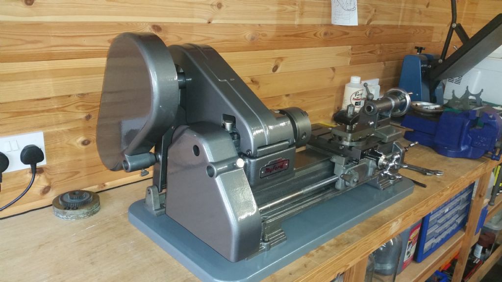

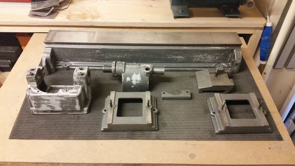

      Finally, got the lathe back together and I'm really pleased with it although I am so tempted to strip it again and spray the bed, tailstock and headstock as I have the covers as its a much better finish. Trouble is I want to start using it. Just waiting on new switch gear and should be able to get it up and running.20190317_141645.jpg

            What's up with my eyesight? I think it looks pretty good, and I can only see the faintest mismatch. laugh
            Thing I'd wanna do it put in a leadscrew clutch and handwheel dial, like my old Speed 10 had. Good for milling in the vertical slide, and dialing off exact facing lengths, with halfnuts engaged and without disconnecting the geartrain.

              A leadscrew clutch is on my list of things to do as I have some drawings to follow, as is a handwheel dial, the first job is a new handle for the original drum switch, although I won't be using it. Thought it might be a nice beginner project to get something turned to size and to try and cut a thread.

                Paint doesn't make it work any better, and it looks pretty good to me anyway.

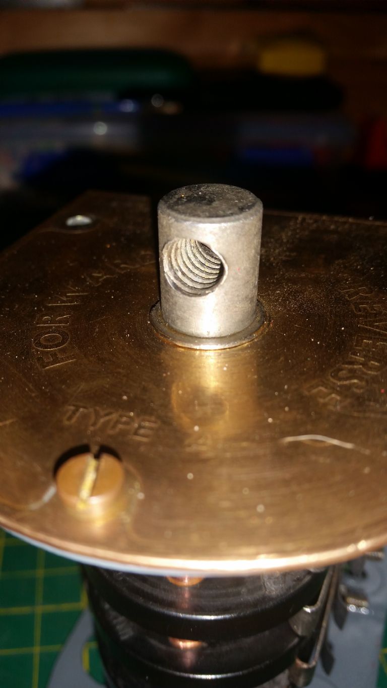

                  Here is the drum switch, i have stripped cleaned and painted it, its a type A Dewhurst switch and it appears to be threaded where the handle fits. Does anyone know how to measure this thread?

                      Dave, measure the thread internal diameter, this is the Core size and is close to the tapping drill size for the thread in the spindle. Check thread charts for a similar size core and you may find an exact match, or the thread size may be the same as diameter of the operating handle if someone could measure.
                      If you have access to some thread gauges you will be able to confirm the TPI by inserting gauge into the threaded hole, from memory it may be 1/4" W or BSF.

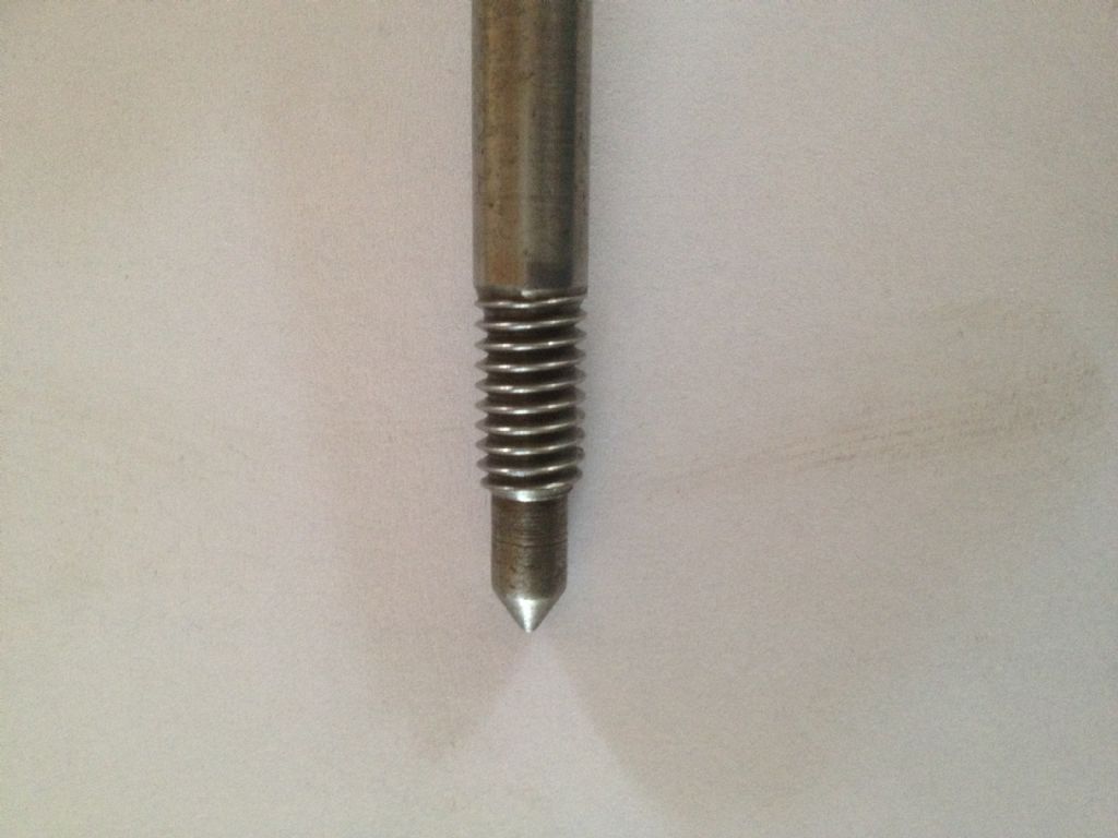

                          Dave Try to insert a bolt of the appropriate size bearing in mind that it will probably be imperial or BA
                                    5/16 Whitworth on my Dewhurst type A.
                                    Regards
                                    Graham

                                      Brilliant, thanks Graham, that's exactly what I have to try and make yes

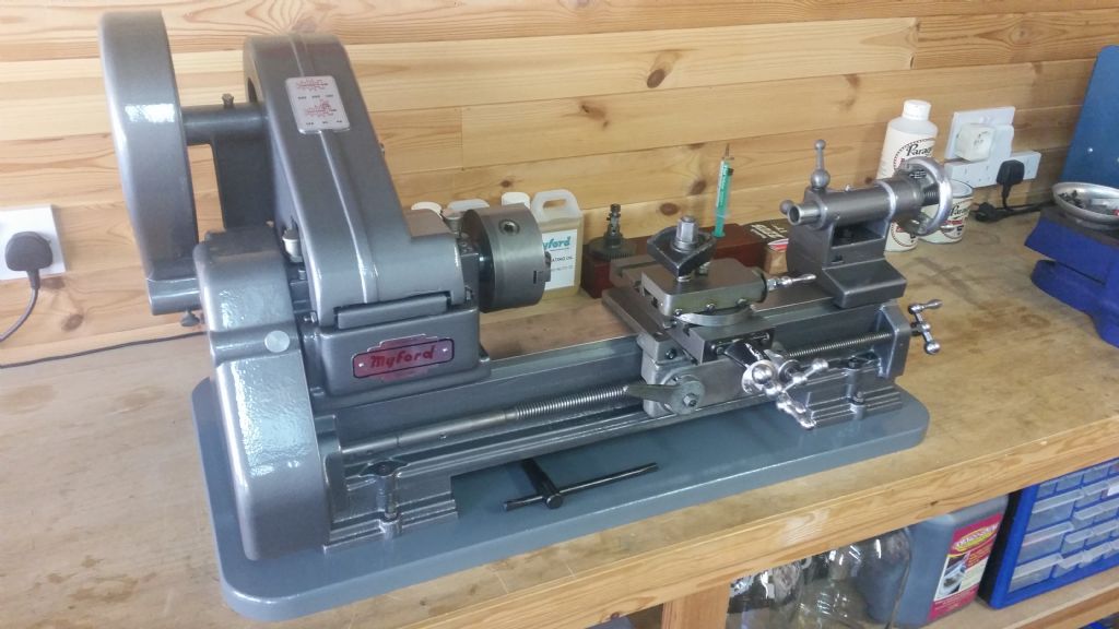

                                        All back together now after rubbing back down and spraying the few bits that I had hand painted. Really pleased with how it turned out. Just waiting on an NVR switch to turn up and I can finally get the motor installed and get it up and running.

                                          Looking good. I can still remember looking enviously at one at the ME show in about 1981 when they cost £600 without tray, motor, or chuck and were the cheapest lathe at the show apart from a tiny flexispeed.
                                          For finding threads when a helpful forum isn't available just screw in a bit of soft wood or plastic loosely so it is indented with the thread to measure against a rule more easily.

                                            I hope its not too good to use, that would be criminal!
