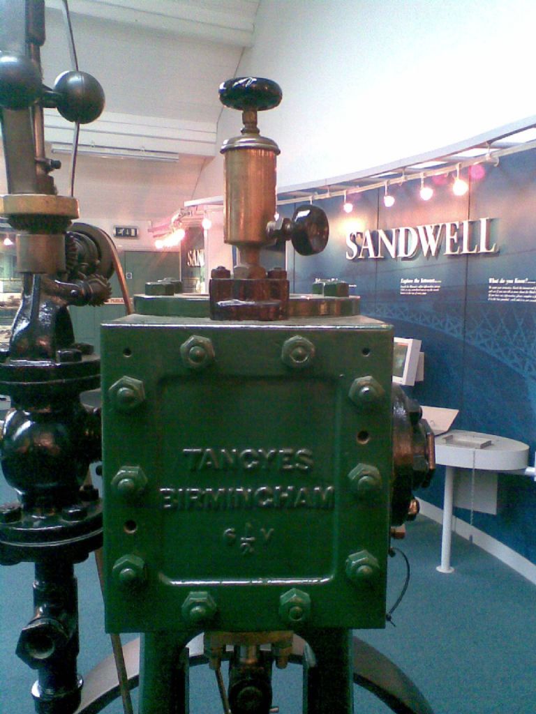

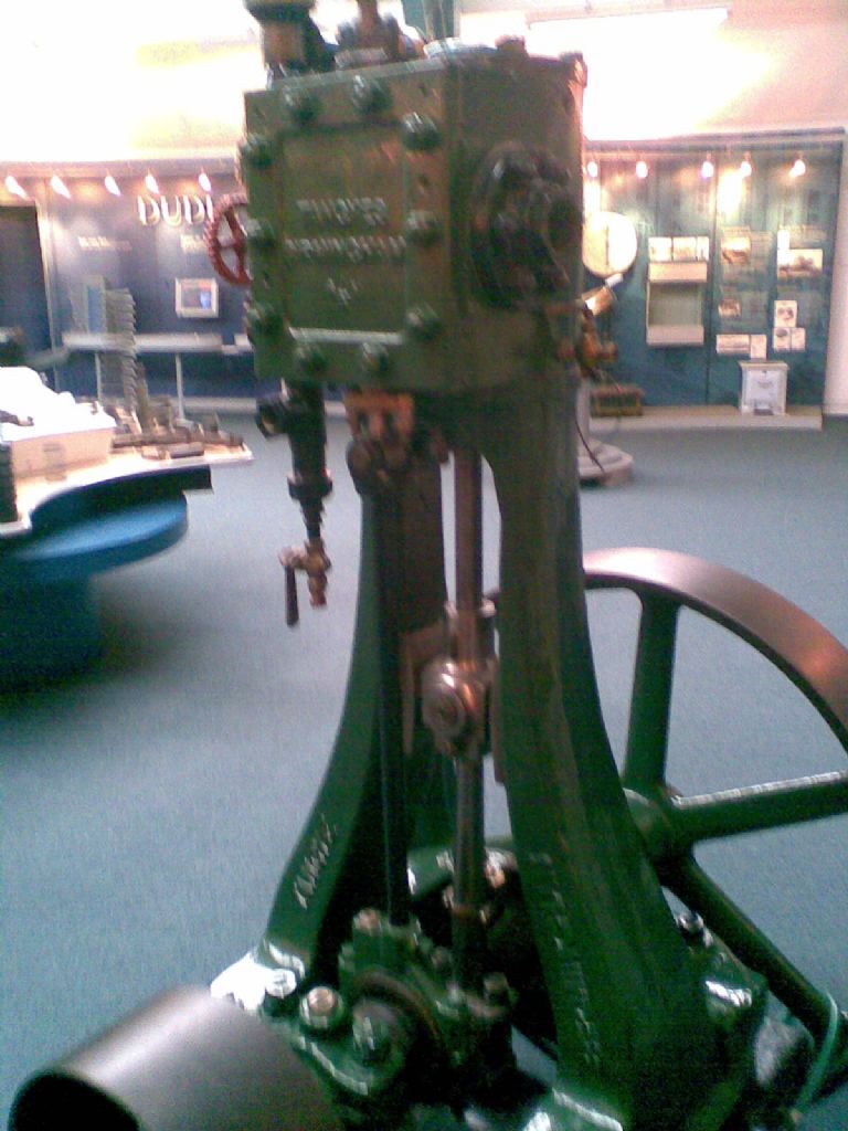

        I was going to post a random picture in to see if I was having the same problems as others have documented in a current thread. I came on these pictures and remembered that I never got a definitive answer to this question – On this Tangye engine at the Black Country Museum the governor appears to be fitted to the exhaust. Is this a mistake? Does this engine have inside admission (highly unlikely)? Is there a reason?
        Tangye stationary engine
        Steam chest
        Look carefully
        You'll see it's also made in Brum, not the Black Country!

          No way of telling for sure without taking engine to bits but a common arrangement on Tangye engines was the four port portface .
          Three ports to work in the normal manner with slide valve and a fourth port – always open – was cored back through the cylinder block itself to the connection which admitted the high pressure steam .
          Advantage of this arrangement – apart from simplicity – was that the steam chest and cover could be removed for maintenance without disturbing the steam connection .
          Regards ,
          MikeW

            That would seem a reasonable explanation, except that why would the exhaust be on the steam chest? I'd expect them to be on opposite sides of the cylinder if that was the case.
            I can't find anything about this arrangement with google, but some of these Tangye engines appear to have similarly palaced inlet and outlet pipes. Perhaps the exhaust was also running down a cored hole in the side of the steam chest, I can see how this makes attaching the exhaust easier in a horizontal engine, but I'm sure Mr Churchward would have fretted about such serpentine passages!
