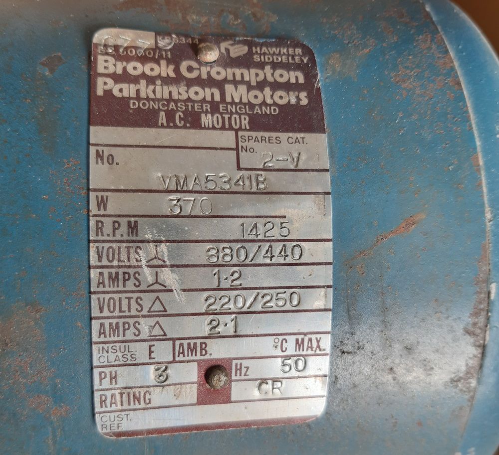

      Ok, I am new to the forum and have spent the last few days looking at all the topics on inverters, I have picked up some valuable tips but still not sure if my planned approach is correct.
      I have a Fobco bench drill that is 3 phase 370 watt 400 volt @ Hz50 which I want to run as 1 phase 230 volt.
      My simplified explanation is as follows, first change the motor to Delta, I have taken the 3 wires off terminal N and checked for a circuit (continuity) between A, B and C and the wires from N being Brown, Black and White, so I presume I connect the Brown, Black and White to the A, B and C terminals where there is continuity and that will set the motor in Delta mode 240 volt 3 phase.

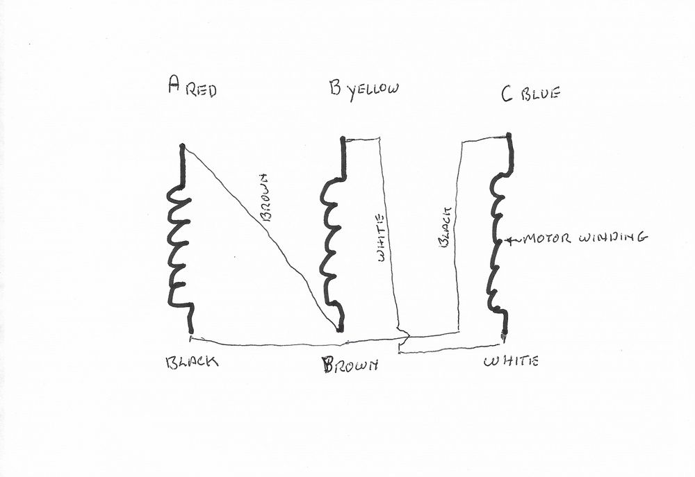

                Posted by David P on 19/05/2023 16:17:33:
                It is possible to misinterpret your description above, so you might have to be more clear in the way you describe the connections.
                In particular, you need to list clearly the relationship between the six wires.
                I _think_ you are saying: red (A) and brown are connected; yellow (B) and black are connected; blue (C) and white are connected. However, my (or anyone else's) thinking is a particularly bad way to proceed. Certainty and clarity is required.
                If this is the case, and you connect brown to terminal A (red), as you appear to be saying above, you are just connecting the two ends of the same coil together. No harm will come by doing so, but the motor will not work.
                You have the delta triangle on the data plate. Each side of the triangle is one of the three coils. Each vertex of the triangle can be labelled sequentially A, B, C. So the 'start' of the first coil goes to 'A'. The 'end' of the first coil goes to 'B'. The start of the second coil goes to 'B'. The end of the second coil goes to 'C'. The start of the third coil goes to 'C'. The end of the third coil goes to 'A'. One each of the incoming phases goes to A, B, C.

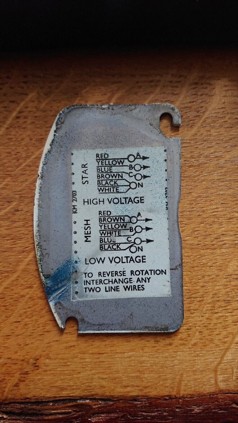

                  Here's the wiring diagram from my brook crompton motor cover:

                                      Posted by DC31k on 19/05/2023 19:20:19:
                                      so how do I test which of the free wires, Brown, Black and White go to the correct terminals A, B and C for delta?
                                      I do not have the original plate that covered the wires but looking online it seems most of the Brook Crompton 3 phase motor are wired the same as the picture shown by Pixel_Porpoise.

                                            David
                                            Fundamentally the motor coils all have to be the same way round. If one is reversed relative to the other pair the motor doesn't run as smoothly or efficiently.
                                            If you still have the coloured sleeves on them then follow the diagram posted earlier.
                                            If you don't have the colours but haven't yet mixed up the wires follow the same sequence. Star point wires are all at one end of a motor coil and the free ends are the power input. So in delta connection carries one of the old power input connections and one ex star point connection from another coil.

                                            old mart
                                              @oldmart
                                              PP has the correct wiring illustrated and you should use "mesh" which is the equivalent of Delta if you are running an inverter from domestic single phase mains. I always recommend checking out "The Inverter Drive Supermarket" and you will find that some of their inverters have a free "quick start guide" which is invaluble in all the wiring, external controls and programming. So helpful that even a dummy like me was able to wire remote speed, on off and emergency stop buttons. Having a proper box for the controls is recommended as the controls on the inverter are only intended for initial setting up, not continuous use. It is recommended that shielded wiring between the inverter and the motor and for the control wires is used to minimise interference from or to the system. I would go for the 0.5 Kw size inverter for your Fobco.
                                              Welcome to the forum.

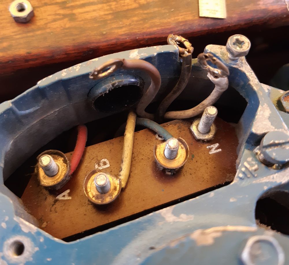

                                              David P
                                                @davidp
                                                So if I wire it as the motor plate picture by Pixel_Porpoise it will look something like my attempt at an electrical drawing, sorry.
                                                I have done a test and get a reading when the multimeter is put between A red and black N, also get a reading between B yellow and brown N and C blue and white N.

                                                old mart
                                                  @oldmart
                                                  If you have it wired in delta, then the resistance values between any two of the three should match fairly well. The fourth wire, (neutral), would not be connected to anything. If it was still in star the fourth connection, (neutral), and any other would read half the resistance of the reading between any two of the three. Your sketch looks like delta to me.
