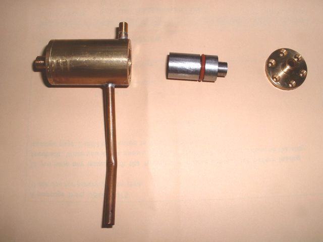

      This is a question for anyone who has built and used an injector test unit to D.A.G. Brown's (Bill Carter's) design. A club member has built one and I have borrowed it to test a couple of injectors. On testing with a known good injector the output pressure gauge only reads 35-40 psi with the injector delivering dry and with boiler pressure of 100 psi applied to the boiler inlet end. The fellow that built it has tested a good many injectors with it, and talking to him he says that is the result he gets and he thinks this is normal. From all I have read I was under the impression that the output pressure gauge should read 5 -10 % above boiler pressure ie. in this case ~105 – 110 psi. I'd be curious to know what other people's experience is.

          I used a modified version of the Bill Carter test unit which had a simple piston fitted with an O ring. When the injector output pushed the piston against the boiler pressure side the O ring uncovered an outlet port in the bore of the test unit. It seemed simpler to make than the coned seat and coned end on the piston of the Carter design.
          When testing an injector I always found that the indicated output pressure was higher than the boiler pressure, sometimes considerably so. I would have expected the Carter unit to give similar results. I am not sure why your, or rather your friends unit should indicate such low output pressures?

                  Just a thought but have you checked to see if you are indeed getting full boiler pressure to the boiler inlet of the test unit? Maybe there is a restriction somewhere that is reducing the pressure? It sounds as though there may be a problem with the test unit.
                  Paul – I fitted a valve to the outpipe pipe from the test unit so that I could restrict the flow produced by the injector. If you do restrict the output then the pressure should increase. I've had an injector produce double the boiler pressure before now.

                        I've had another go with the test unit but before I did I took the valve apart ( with the owner's permission! ) and checked it against the drawings in Brown's book. All dimensions are correct and the pressure gauge and drain pipe connections are in the right place. The only difference is he has replaced the coned seal on the piston with an "O" ring seating against the sharp edge of the inlet bore.
                        On the test today I tried restricting the outlet of the drain pipe by blocking it with a long piece of wood pressed against the end of the pipe (is that water ever HOT! ). As soon as there was any restriction the indicated pressure rose and when almost completely blocked rose to just under 150 psi, this was with a boiler pressure of about 90psi.
                        I think I will make a new shuttle valve to the drawing with the cone seating and see if that makes a difference.

                          If the gauge is teed in to somewhere where the water has very high velocity, could it be measuring dynamic pressure rather than static? This would explain why restricting the flow ( reducing the velocity) raises the output pressure

                            Well the new shuttle valve to the drawing made no difference. Still getting a reading of about 20 psi on the gauge. Also tried two other pressure gauges and they both read essentially the same. The whole unit is now to the drawing. I have measured it all round and all dimensions are within a couple of thou of the drawing dimensions. So why are we getting such a low pressure reading where others are getting a reading of boiler pressure plus?? I'm at a total loss.
