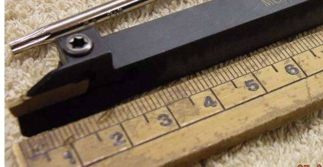

          Don’t bother with a set, most of which you are unlikely to use. Without knowing what  what you intend to cut, difficult to give recommendations on tool type, insert type size etc. More info needed. For that machine I have 10mm shank tools and try to keep the insert size small.
          SCLCR 101006 or SDJCR 101007 to start with and if you are planning to do a lot of facing or work on the left get a get an xxxCL version of your choice or even xxxCN where the tool is set centrally and you position as you wish to suit the cut.
          If you set tools only on the top slide with conventional tool clamp, the 12mm shank tools require less packing up.
          S12K to S06K scmt boring bars according to choice of size. I’m sure they make the equivalent for dcmt. Where possible, try to get scgt or dcgt depending upon your preferred shape (these are ground and polished non ferrous type inserts).
          I have had parting off success with MGEHR 150 using a 1.5mm carbide blade, but it is quite small. The wider 2 and 3mm tool blade equivalents are a bit hard work for the Myford.
          All available at various on line markets. Generally, the holders from those sources are not the best, not even hardened in most cases but they do the job OK. purchase other tools individually as you require.

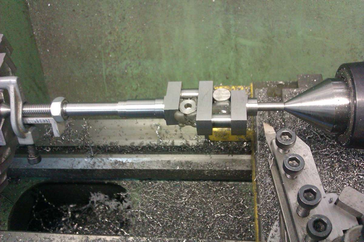

                      Morning Jason,
                      Can I ask how are you holding those spacers between the webs of your crankshaft?
                      I always wonder if it’s best to normalise BMS before machining a crankshaft out of it. Or rough out the shape first, as there are lots of locked up stresses in BMS.
                      I realise you have done lots of crank shafts before, do you get much movement between the webs after removing the spacers? Do you then skim the crankshaft after the spacers have been removed?
                      Regards
                      Derek

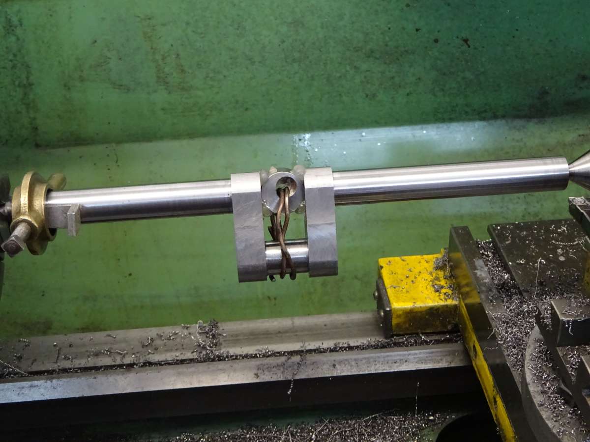

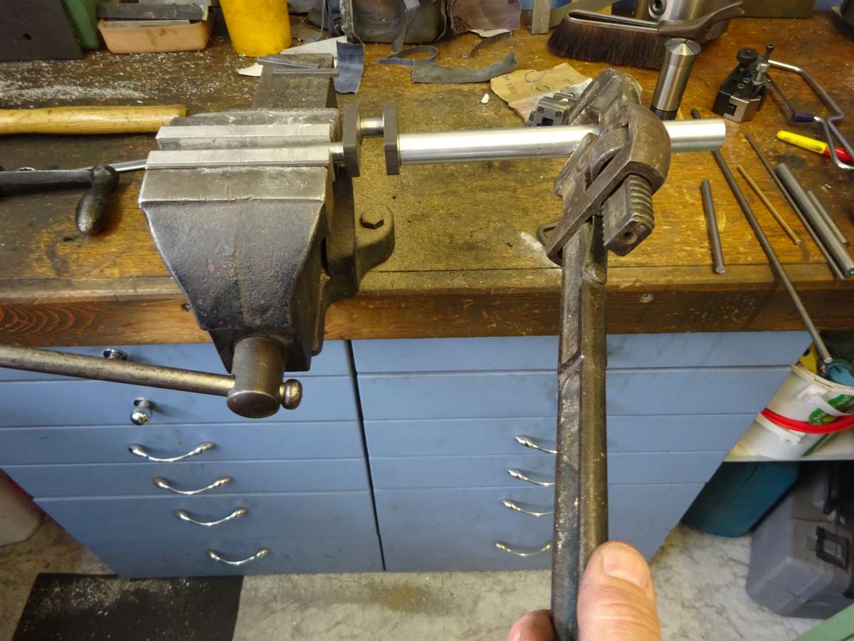

                          Spacers were turned using teh gap to gauge their fit and are held in with hot melt glue, sometimes I will add wire as well. They should slip in with minimal clearance but not force the webs apart
                          DSC01571
                          I mostly use black (hot rolled bar) for crankshafts but in that case did mill it from bright.  I let it settle for a couple of weeks between roughing out and final machining. This black bar was left to settle for a couple of weeks after stitch driling out the waste
                          DSC01562
                          They mostly run true, the odd one that has had a bit of a bow can be cold set back into place. I did have one on a part finishe dengine where th eprevious builder made a big point of the cranks being cut from EN24 and that needed quite forceful cold setting to get it running how I wanted

                                                  So below is a basic 10mm shank  left, right and centre  + 10mm boring bar turning tool collection for dcxx 07 inserts available either as a set or individually from the usual markets (cheapest as a set at around twentyish). Probably can get the same sort of collection for ccxx insert if you prefer that type.
                                                  Other configurations of tools sets are available that include both ccxx and dcxx types plus threading, parting tools etc. Inevitably they have the less than stellar MGHER parting tool (also shown below). They work after a fashion but best for non ferrous (except hard bronzes). The blunt 2mm blade puts a bit of a strain on the Myford and needs a bit of courage to get started. I have a 1.5mm version which is easier to start, but with the added attraction of the thinner blade  being a bit more bendy and prone to digging in! I find really sharp HSS in the rear toolpost the most reliable.
                                                  Also avialble are boring bars sets 6/8/10/12 for ccxx 06 inserts for twentyish or less. It would be nice if you could just get a 6/10/16 as a set but will probably cost you more as you would need to get individually, so I ended up getting a set I mainly use the 6 and 8mm but that is reflective of the size of work being done.
                                                  You want to chose tools that use the smaller inserts and avoid those that require larger inserts (ccxx09 etc) as they just cost more for no benefit.
                                                  edit  As an aside, I find the ccxx inserts to be slightly more robust than the dcxx, but the dcxx type is useful to work into tight spaces.
                                                  turning tool set
                                                  MGEH….Aaargh!
                                                  parting tool
