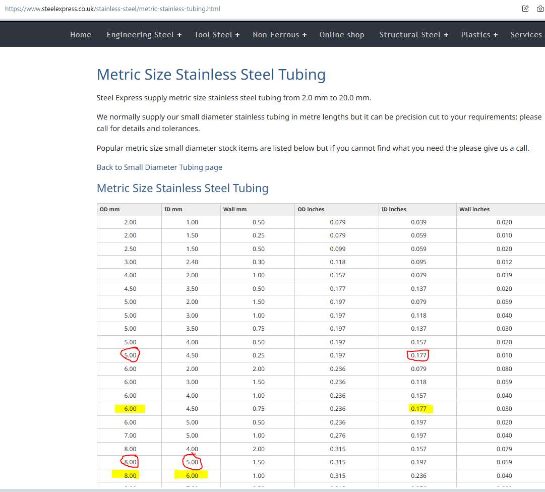

                            The reason for the increase in bore diameter is. I have been asked to repair an old model crane. It has two hydraulic rams that lift the jib. The piston parts of these are made of good quality polished steel at 4.5mm diameter. One of the external cylinders has been damaged over the years, and the piston will no longer slid in it. I have sourced some 8mmx4mm tube as I have searched the internet and cannot find anything closer. My “quite accurate” bore is to ensure the parts slide nicely into each other. I have thought about drilling it out 4.4mm then hone it us wet and dry paper to achieve a quite accurate fit. I have several 4.4mm drill that would the job if drilling from each end. I could buy and long series 4.4mm drill and it out from one end but was unsure about the result.

                                      It might be a lot easier to find some tube of about the right size and make a new piston. Macc sell 6mm od 5.1mm id brass.
                                      Lots of the above suggestions will work on bigger tube, but this is very small
