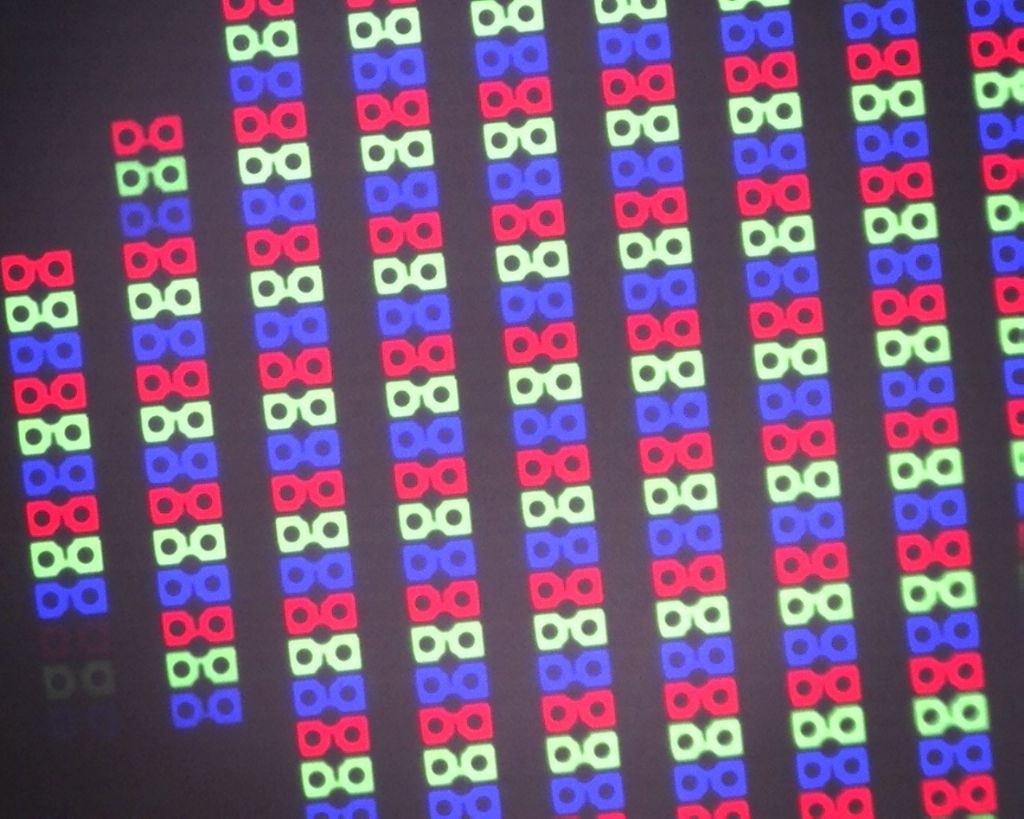

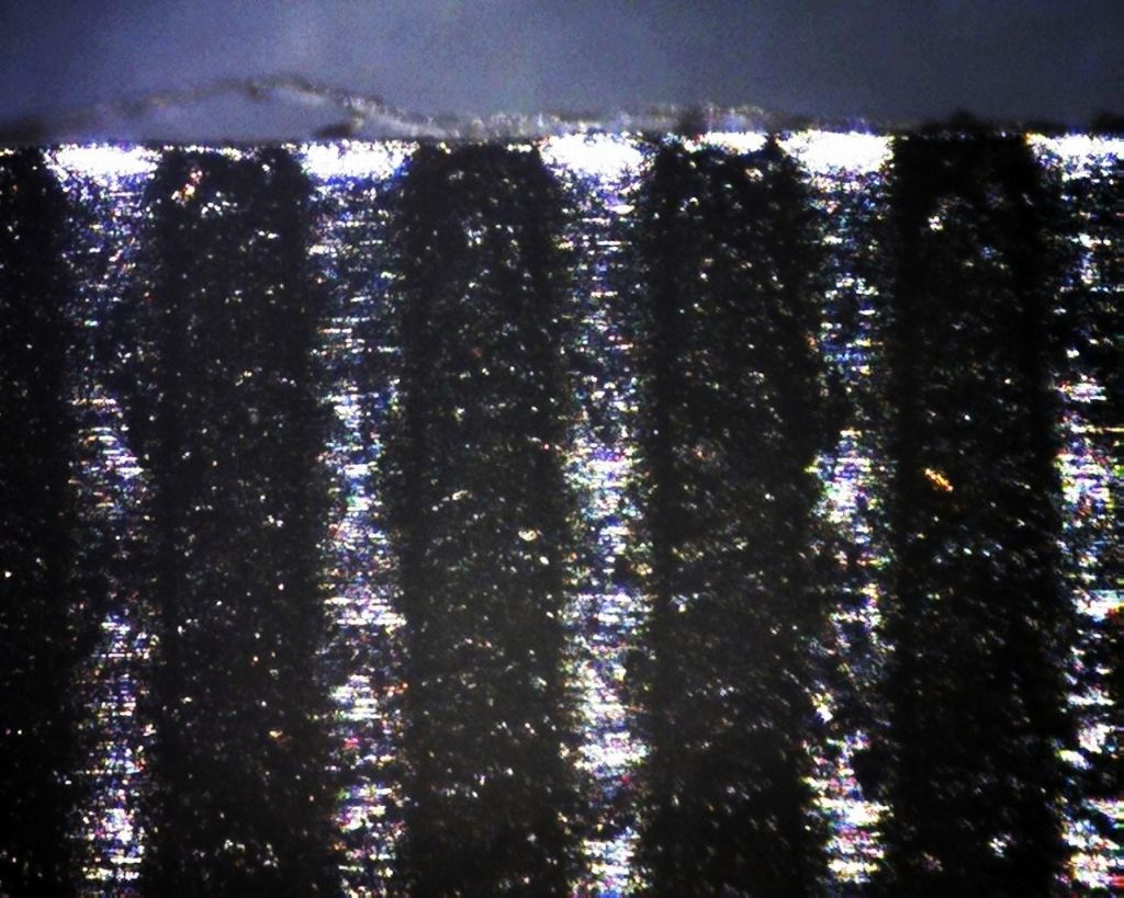

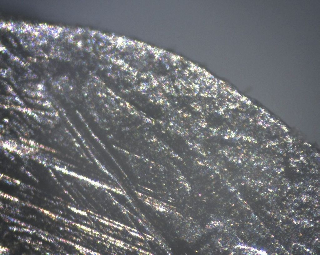

                      Don't underestimate the piotential of thes microscopes. i have a £30 Aldi 'traveller' one. These three pictures are at 200x zoom. I have to up the contrast at this level of zomm, but I am pleased with the results.
                      A lovely flexible stainless steel rule with 100th inch graduations – so one black + 1 white section is 10 thou – ample resolution to measure screws to <1 thou accuracy:
                      A tool tip at 200x – not the best bit of hand grinding ever, but it cuts well!
                      Finally, can you guess what this is?

                          #99691
                          Ian P
                            @ianp
                            Posted by Stub Mandrel on 29/09/2012 21:03:13:
                            It looks like a full stop?

                              #99696
                                Neil,
                                It looks like one of these
