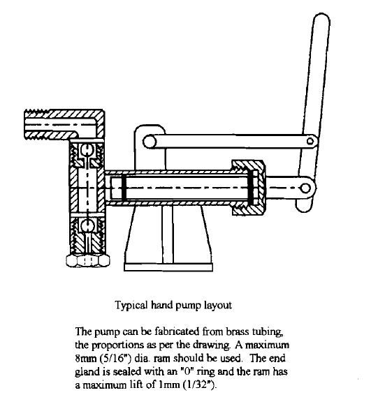

              Hi Michael,
              why not build a simple hand operated hydraulic pump such as the one in Stan Bray's book? That would solve the problem of excess pressure with not too much effort. Just remember to include a pressure gauge in the system.
              Regards
              Terry

                            The pump that Terry shows would be well worth building, as well as a pressure testing pump, it can be used as a feed pump on your boiler. I think its the lift of the ball valves that is 1 mm. Ian S C
