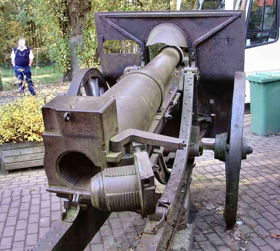

                            Just a thought, moonman doesn’t want to plug a through hole because he’s worried about the pressure.  Quite right, it needs some thought.  But 200bar (2800psi) isn’t that scary in a reasonably thick mild-steel container, walls say more than 3mm. Thin walled UK domestic Copper water pipe bursts at about 1500psi, and the Sparklets soda siphon I took apart had Mazak innards and a 900psi CO₂.   Look the formula up and do the sums, and maybe increase the safety factor by going for stronger than mild-steel.  But threaded plugs are remarkably strong, this screw-breech thinks 200bar is a sneeze:
                            breechscrew
                            Might also be possible to design a PHP so a failed plug was caught inside the mechanism, making unlikely to escape.
                            How is the air-bottle fixed to the gun?  That connection has to contain 200bar, bet it’s a thread!  The dimensions and number of threads are a clue.
