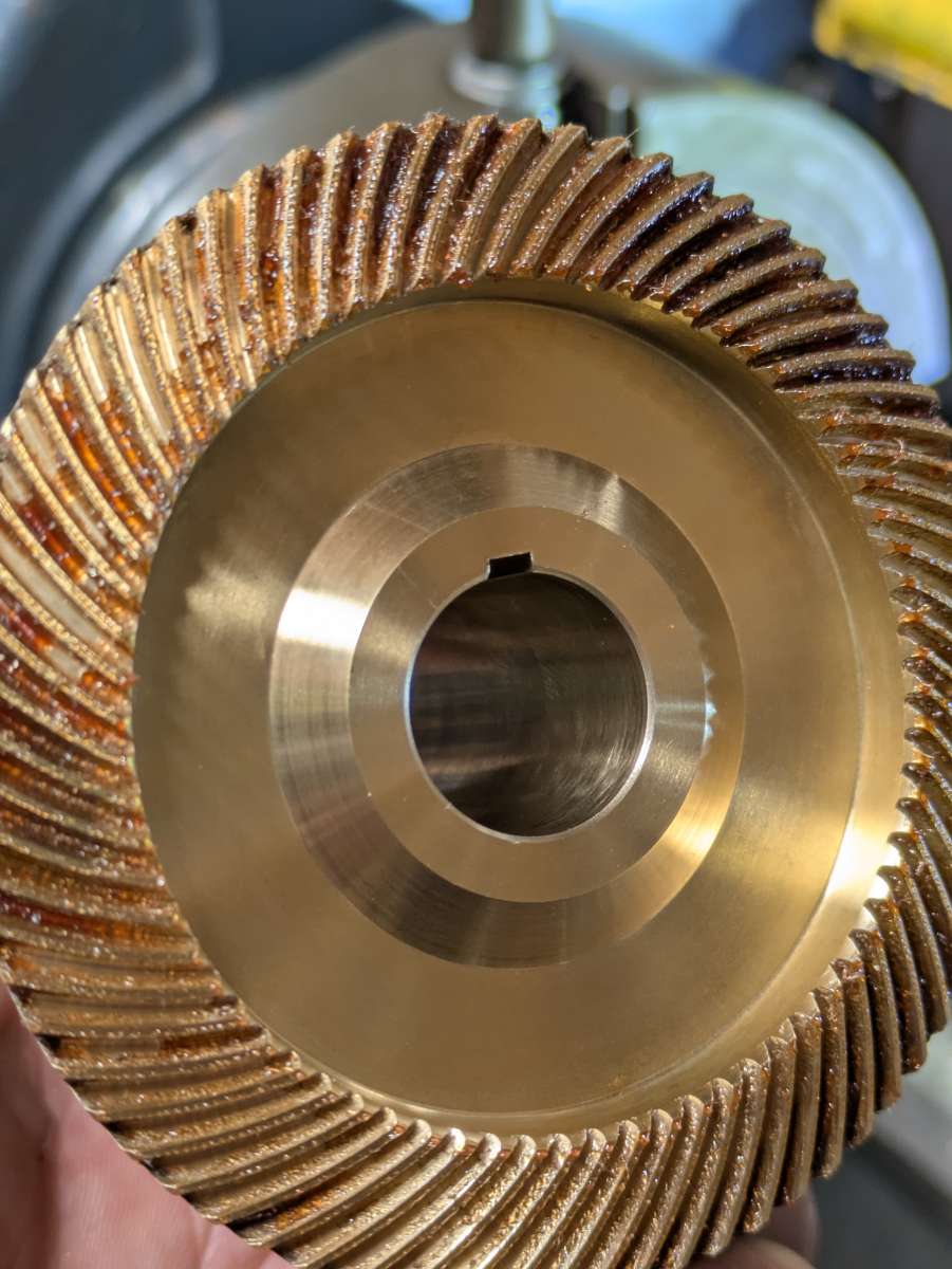

      Hi guys. A need to enlarge a keyway has arisen, The brass gear below is for a power feed, it has a 3mm keyway which needs enlarging to 5mm. The keyway is almost 60mm long. Having never done a keyway before I don’t have the proper kit or knowledge. In the absence of a proper broach and press, how would you tackle this?

              Grizzly – The keyway is currently 3mm wide and needs to be 5mm wide. I can’t remember the depth.
              Nigel – I have a Boxford lathe and a Warco VMC mill, I’m not a complete amateur but broaching is just something that I’ve never needed to do before. I have been watching some videos on YouTube and using the lathe might be the way to go.
              Unfortunately I can’t modify the key because there’s 2 separate parts that slip over the shaft. The key sits between where the two parts join or butt together. The brass gear slips on first so obviously the keyway needs to be bigger. If that makes sense.
              Paul – I’m in South Yorkshire.

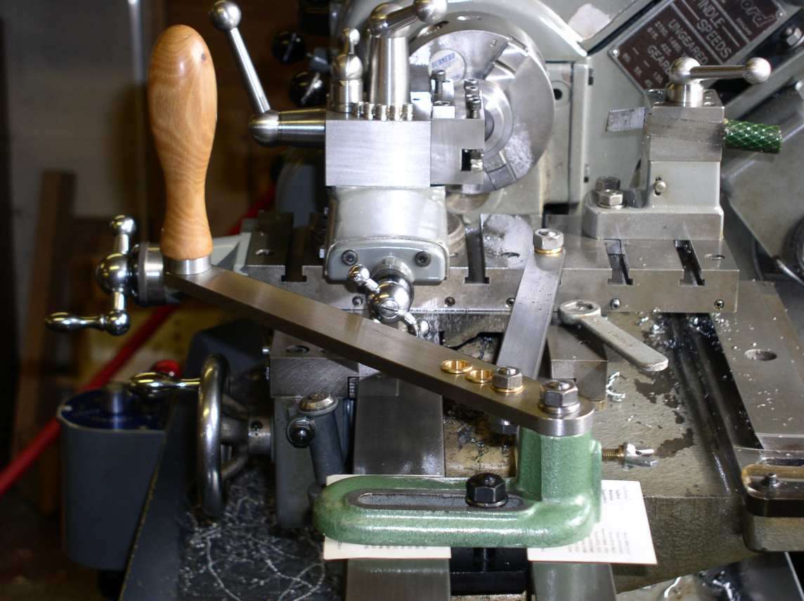

                          For slotting in the lathe I made a lever and link. I use the base of the hand tool rest as an anchor. This puts much less stress on the machine than racking with the saddle handwheel. The handle is a piece of an apple branch from the garden.

                            Effectively answers the too much strain on a small lathe when using the saddle feed issue and simple enough to be worth making for “the one and only keyway I shall cut in my life” job. Of course once you have got it …..
                            That said I’m unconvinced by the strain on the carriage argument. Yes a keyway is a wide and relatively heavy cut if you go straight at it. However if, as I do, a starter hole is drilled half in the job and half in a plugged bore just a touch smaller diameter than the key width most of the heavy cutting is already done so the stain is seriously reduced. Only the last bit of the end corners being full width. A little bit of attention to the corners with a file helps there. I routinely drill the starter hole before boring.
                            If the OP is worried about stress a bit of filing to remove a useful percentage of the metal to be cut isn’t too difficult. Alternatively a narrower tool could be used and one side at a time cut. If working in the lathe use a 3 mm tool and shim up 1 mm to do the top side and down by 1 mm to do teh bottom.

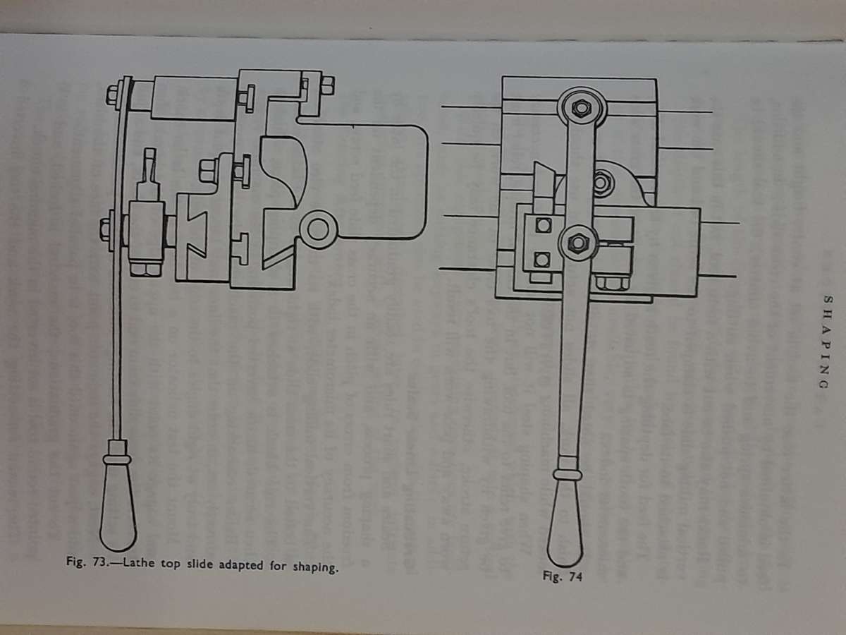

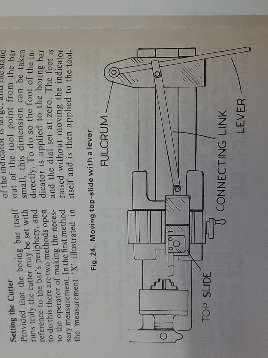

                                  Ian Bradley published several designs in ME in the 1940s for lever-acting the topslide for keyway cutting. Theory was it saved wear on the main bed ways.

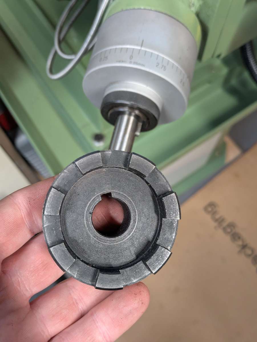

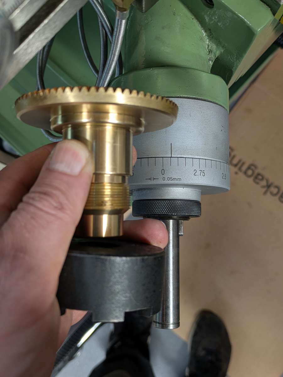

                                            OK guys, here is the situation. These parts are for a power feed on the VNC knee. The brass gear must slip on the shaft first as shown below. The second, castellated part goes on second. Both parts span a single key.

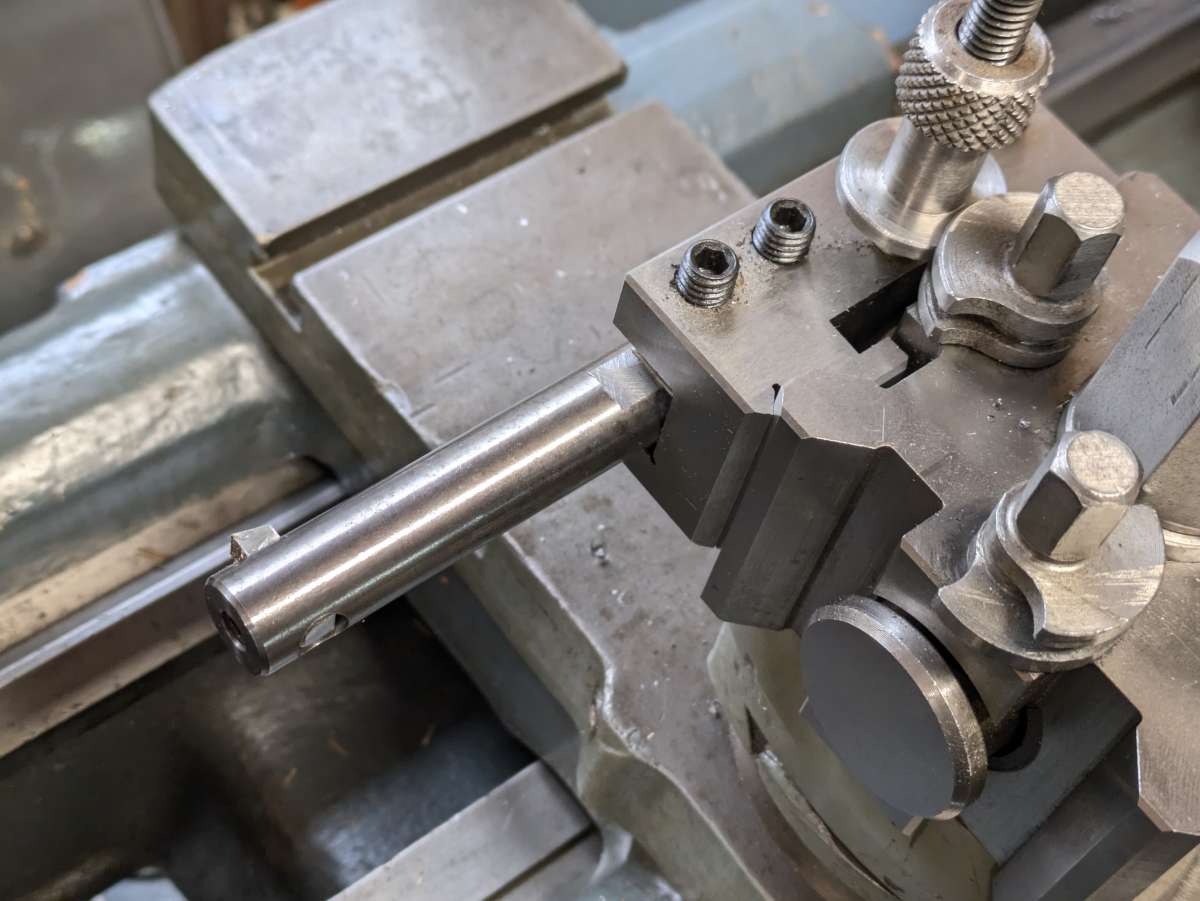

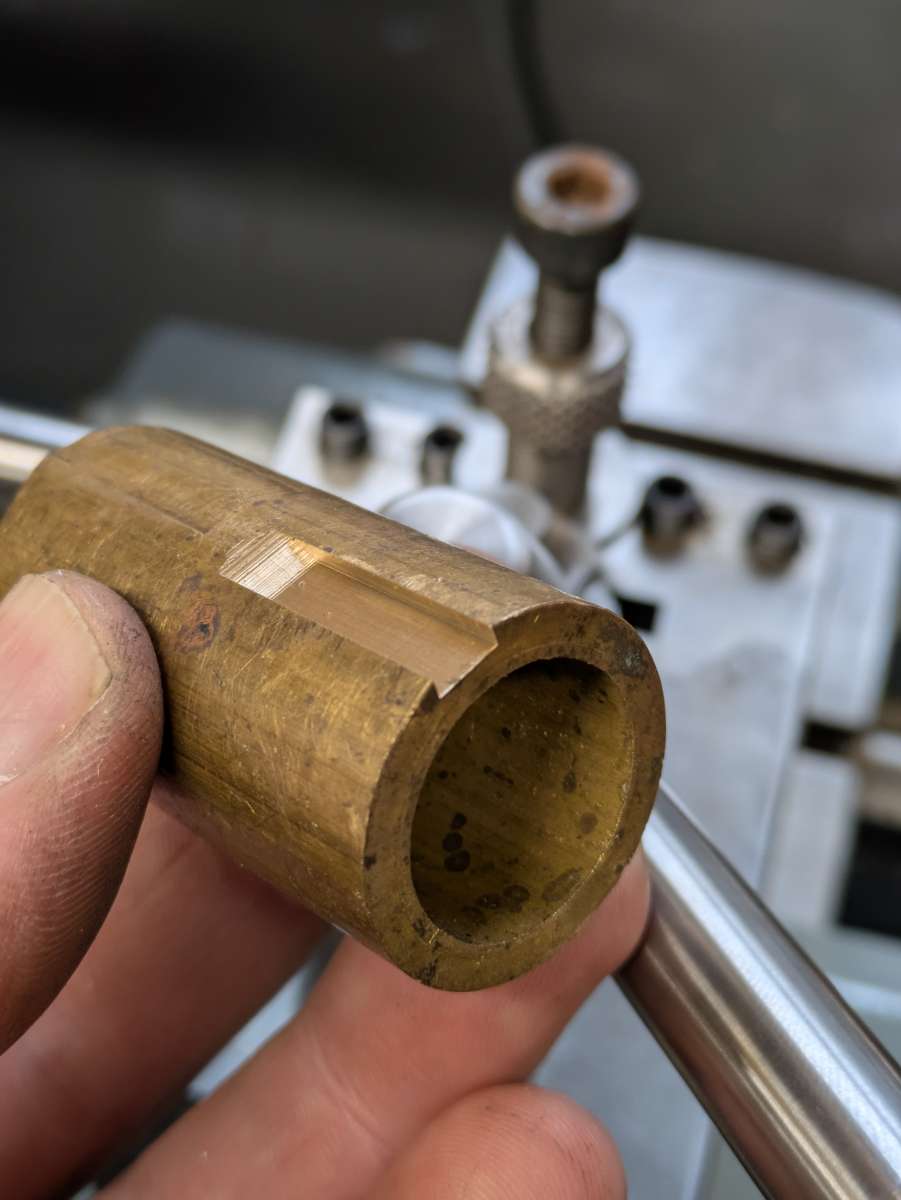

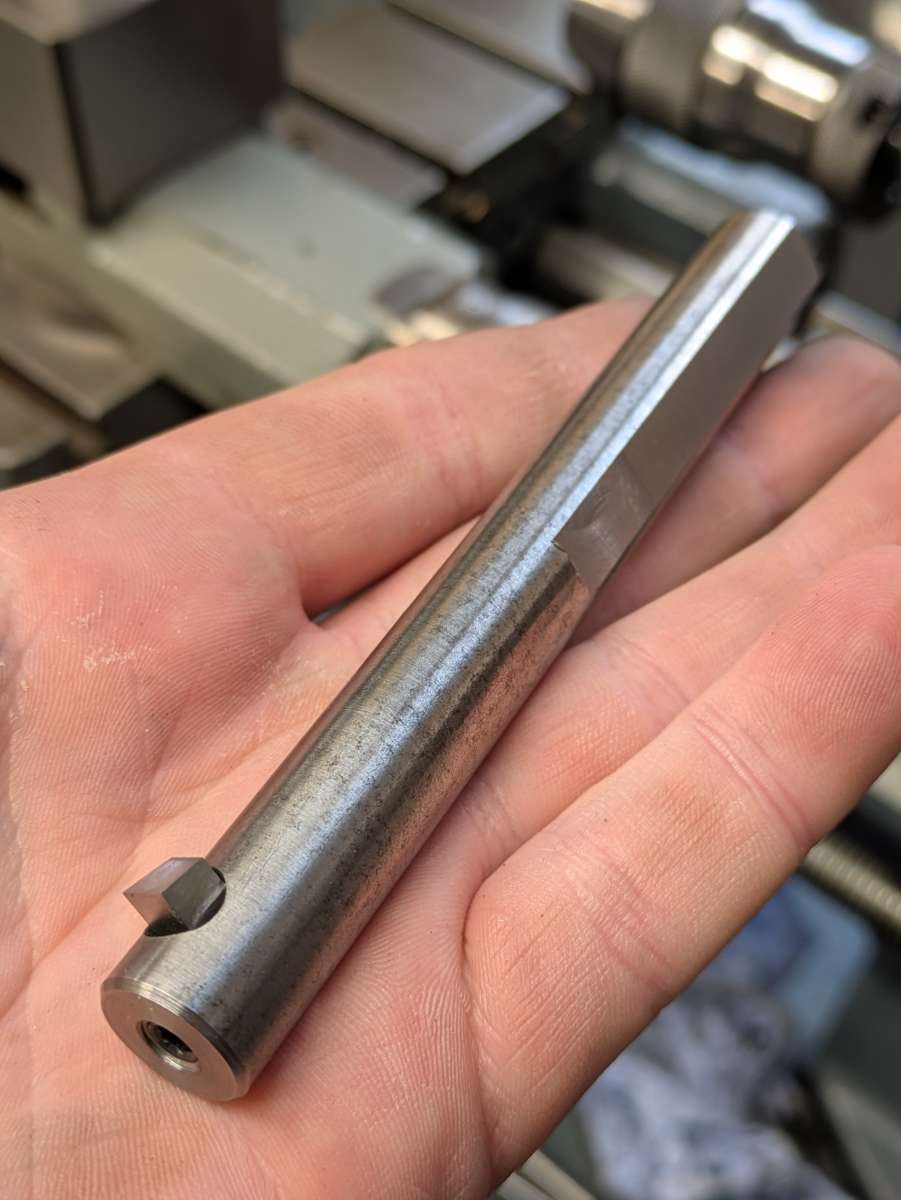

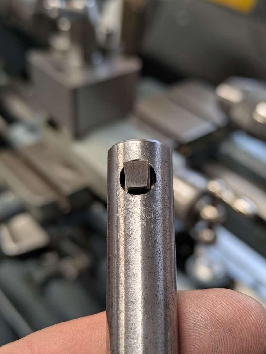

                                              I have decided to have a go at doing it on the lathe as suggested above, I spent this afternoon making a tool similar to that shown in “blondiehacks” YouTube video. I tested the finished tool in some scrap brass and as long as I take very small cuts (0.2mm) it seems to work fine. In fact, I am pleasantly surprised at how well it works!

                                                With the smaller one going on first a stepped key won’t work unless the shaft keyway extends to the end of the shaft so it can be pushed in from the end.
                                                But they do not have to “share the same key” they can share the same keyway in the shaft but have separate keys.
                                                Asuming the shaft and nut have 5mm keyways just use a 5×5 square for those. When it comes to the gear make an inverted “T” shaped key with a 5mm bottom to fit the shaft and a 3mm top to fit the gear.
                                                EDIT posted between your two, so may as well just enlarge the keyway.

                                                    Now I’ve made the tool I might as well run with it. The thing that worries me now is getting it all set up perfectly! 😅
                                                    #819725
                                                    Nicholas Farr
                                                      @nicholasfarr14254
                                                      Hi, well providing you set the tool centrally on the lathe’s centre, there shouldn’t be much of a problem. Just lock you chuck by eye to the keyway and start cutting.
