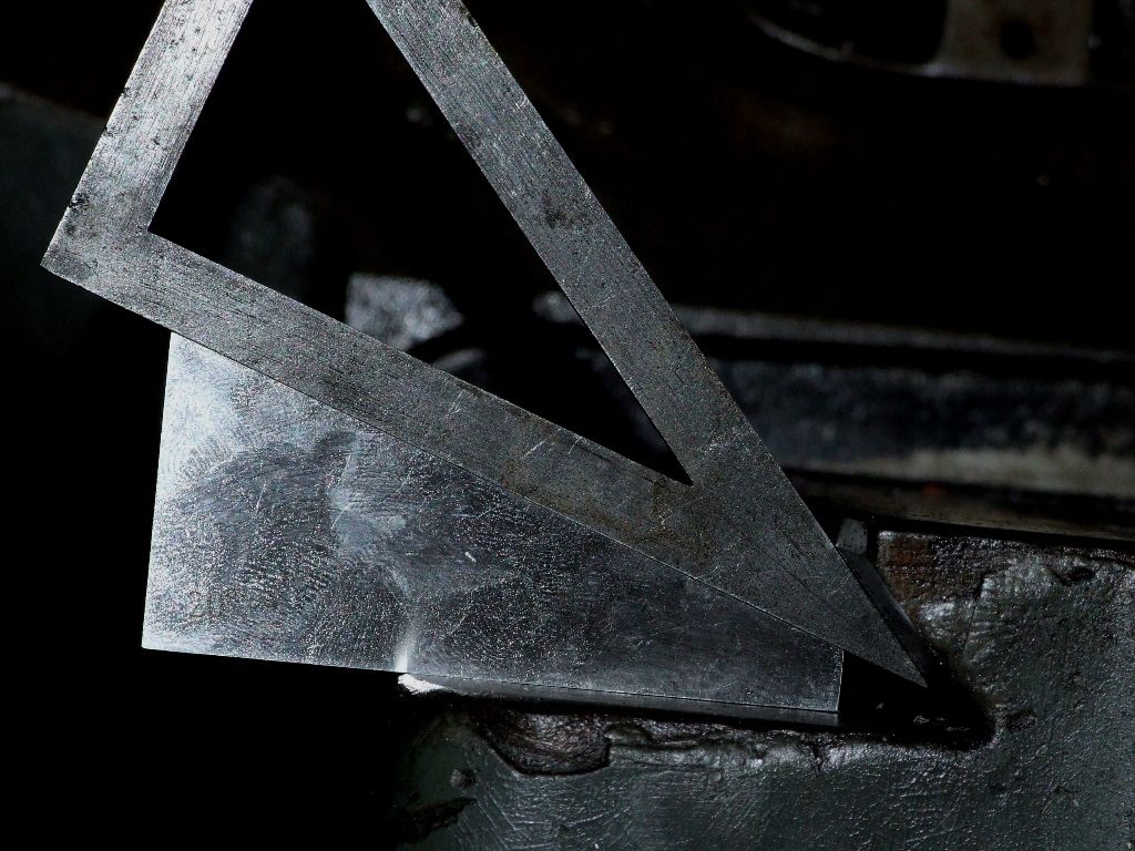

                                        #205017
                                        Anonymous
                                          Somewhere (possibly on 'practicalmachinist&#39 I read that the optimum angle for dovetails is nearer 50º, although I can't remember what the criteria were. Having just measured the dovetails on my Bridgeport they are 50º.
                                          Andrew
                                          #205025
                                          Ketan Swali
                                            @ketanswali79440
                                            Andrew,
                                            The Chinese Bridgeport clones are usually 55 deg. And same with most SIEG machines too. Is it possible that your Bridgeport is 55 deg. ?
                                            Ketan at ARC
                                            #205026
                                            Ian S C
                                              @iansc
                                              Mr Whitworth was keen on 55*, perhaps there's a clue there, maybe not. I think there is something about the angle being related to the distance apart of the Vs, at certain gaps the angle becomes near to a tangent of the sliding part as it tilts, getting worse as the angle steepens, 60* would be worse than 45*. Just me thinking.
                                              Ian S C
                                              #205033
                                              Anonymous
                                                Ketan: Definitely looks like 50º to me? Here's a 20º block and a 30-60-90 set square:
                                                I suppose it is a Bridgeport clone, in the sense that it was built by Adcock and Shipley in the UK. teeth 2
                                                Andrew
