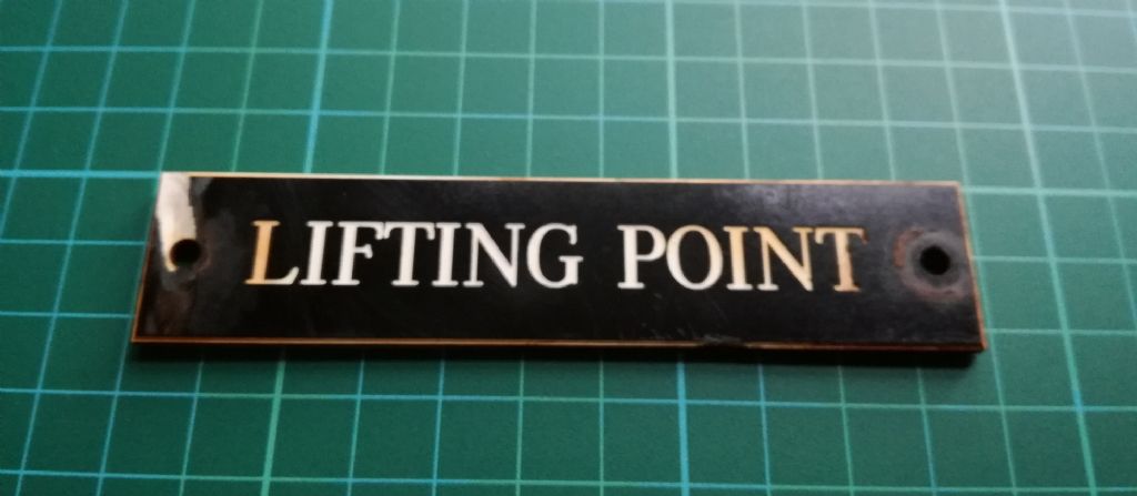

                                        Hi, a photo of a label made from plastic laminate that peak4 mentioned earlier, this one is 106 x 23mm & 3mm thick, and has five layers, two thin black layers on the front and back, two thicker white layers under the outer layers, and a black layer in the middle, which is the thickest. This was on a steel stop log from a river basin that five stop logs were refurbished in my final day job, the brown staining on the white edges being rust. These were probably done with a pantograph engraving machine.
                                        The electrical department in my day job from many years ago had one of these pantograph engravers, which they made labels for the control panels etc. and also made our own name discs for our isolating locks, which were used when we did maintenance on machinery.
                                        Regards Nick.
