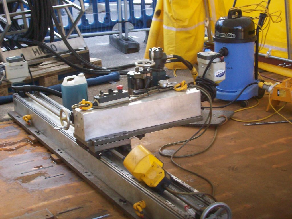

      A port bridge too big to fit a Bridgeport, that is.
      Weymouth Town Bridge is a twin-bascule lifting structure, built in the 1930s I think, that in the past served mainly a commercial ship-repairer and paddle-steam operator, Cosesn & Co. That is long gone and the Inner Harbour – "the Backwater" to use its proper name – is now populated with fishing-boats, dive-charter boats and private yachts.
      Its deck asphalt originally covered cast-iron grids infilled with oak blocks, but this gives a rather fragile surface prone to breaking up earlier than on a solid hard-cored road. So quite some years ago now (1970s?) the iron and wood were replaced with steel plates stitch-welded to their under-frames. The welds are each about 150mm long.
      The bridge is heavily-used, including by some buses,, and over the years the welds have deteriorated, started to crack and need replacing.
      This entails not grinding, but milling, the old welds out to the appropriate depth and profile.
      The MIG welding is performed within a tent to protect everyone else including the public – one footway is still in use, alongside the fenced working area. I noticed the welder himself wears not only a full helmet but one with a filtered air-supply, that unit worn on a waist-belt.
      The bridge is still opened at at least one of the two or three daily scheduled times, which must be very inconvenient for the contractors. Probably quite annoying as it only really needs be opened for the tall-masted yachts – surely their owners could have had their pleasure-sailing curtailed slightly for a couple of weeks, to expedite the repairs?

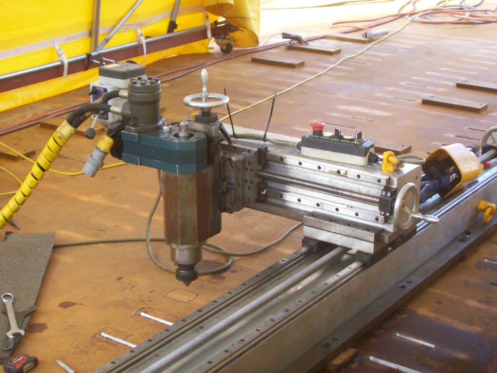

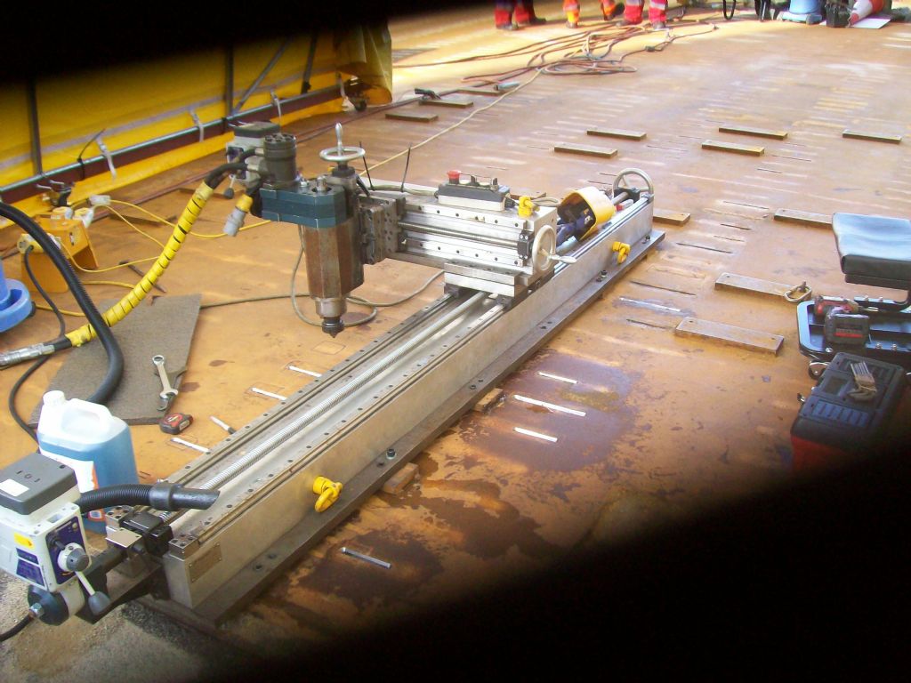

      With the agreement of the rather startled operators, I photographed their milling-machine, built, they told me, by the company itself. I'd disturbed their afternoon tea-break but without my even asking they obligingly moved out of their gazebo!
      As illustrated, Allen-screws secure the machine to the deck via faced steel blocks temporarily tack-welded to the deck itself. The long and cross-feeds have power was well as manual feeds, the cutter is held in an ER collet.
      The photos tell the rest of the story, with some of the mounting-blocks and weld-grooves visible, surrounding objects giving scale, and a snap of the van sign-writing as credit.

                An optimum proflie would be easier to achieve by milling than grinding. Notice the hydraulic motor for the mill spindle, and the powered leadscrews.

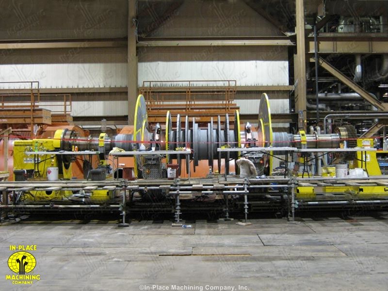

                        Onsite machining is a big thing these days. And on big jobs with long straight welds, they have a similar looking machine that crawls along a pre-laid track and does the welding, no human hands involved! A perfect weld every time. It is how they weld submarine and ship hulls together these days.
                        Mining and marine industries use a lot of line-boring machines that are similarly portable and set up on the job. Quite intriguing to see a flimsy looking boring bar set up and running through a series of very large holes, but of course it is usually only taking out a few thou to correct ovality or to fit an oversized shaft or bush etc. And they even have portable lathes now that will machine a power station steam turbine rotor right there on the powerstation floor instead of trucking a 100-ton rotor across the country to a specialist machine shop. Pretty amazing stuff.
                        First time I have seen a mobile milling machine though. Yes, much tidier and quicker than angle grinding by hand.
