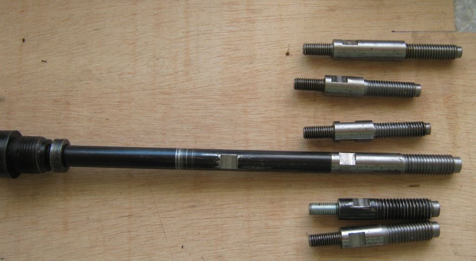

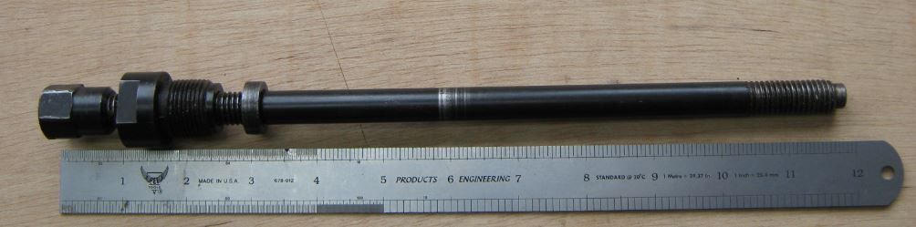

              Hi
              I've just completed a mod on my I/2 " BSW draw bar to accept arbours with M12, M10 and 3/8 BSW.
              My captive draw bar is easy to remove, so I cut the end off and drilled and tapped it M8, then I made adapters to screw in. The pics show the before and after.
              This does require the draw bar to be removed each time a different threaded arbour is used, If that's not acceptable then the same mod could be done but with the adaptors made to screw tight into the arbour, just provide a flange to tighten up against.
              I did notice some arbours require a longer draw bar by 3/4"
