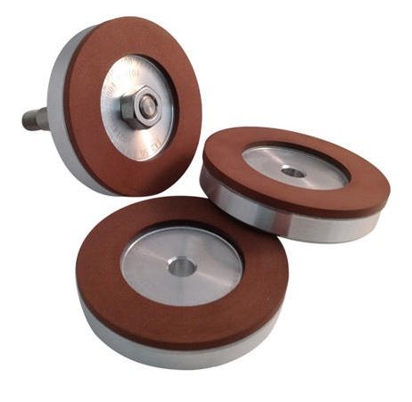

        Hi, I openly admit to asking thisc question in almost total ignorance, but you have to start somewhere.
        I am investigation attatching a 50mm diamond disk to a 400 rpm motor. I have looked on ebay and found a motor of suitable rotation speed it is 12v but how does one gauge if the torque would be sufficient. This applies to both Ac and DC so any help gratefully received.
        Chris

                            His other thread on diamond grinding and lapping will give an idea of use
                            Chris can you post a link to these discs, I can't find any with google. Do sound a bit more like diamond coated discs for lapping stone and glass for lapidary rather than shapening.
                            Like others 400rpm sounds slow at that diameter if you are using these to shape your own tools they it will take forever. If they are just to tough up a previously shaped tool then may be OK and slow speed will not generate heat. At this speed the cutting speed won't be far off my Tormek but I would not use that for initial shaping, 67.6m/min on the Tormek vs. 60m/min on the little discs
                            By way of power the Tormek turns a 250mm wheel with 200W input power but drive system plays a big part in things.

                                    Thanks Guys, there is a lot of information set cutters.jpga special thankyou to the old Duffer for the huge contribution…need time to digest that.
                                    firstly i will upload the disks note they are from eternal tools and are sold as diamond grinding disks to be run with light pressure and at low speeds. From research I take the speed to be around the 400 rpm. What i am minded to do is convert a n old bench grinder with a speed say at 3000 rpm and link it via pully to another pully of suitable ratio to get the speed near 400 rpm which will afford all the torque I need and I doubt other than a simple ratio calculation that will be all the mathematics I will hopefully need. Not to say that I am over looking any advice here I am not and will read it to see what is useful.
                                    The problem then shifts to the spindle and bearings on the additional reduction spindle. Any pointers as to where to get suitable bearings appreciated. obviously if i can get a variable speed powerful motor I can simplify the design. The reason as i understand it for running at the slow speed is heat can deteriorate the grinders surface. Another option for me is to be a crappy old lathe and adapt that with an angled table.
                                    Chris

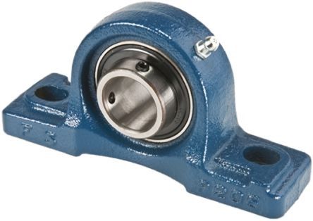

                                        #436427
                                        Chris TickTock
                                          @christicktock
                                          Can anyone help with the feasability of adding a spindle using bearings as shoen. I need to make a spindle to take a suitably sized pulley. That hopefully I can do, but I have never used bearings so I need something to hold the spindle in place. For a starting point here is an RS stock nos 750-8930 that has an internal diameter just under 16mm. Using these as bearings what other components would be beeded apart from the spindle and pulley/

                                            I have never come across the head powered spindle. I take it pullies go on one end but what goes on the other? I am awaiting the arrival of the cutting disk and arbour before thinking again.
                                            Chris
                                            Pully goes on the end with the keyway and the other end has a tapered hole and external thread with closing nut to take ER16 collets which would grip a simple arbor for your wheels

                                                  From the photos you posted of the diamond laps, 400rpm seems about right.
                                                  Sorry for using an ebay link, but how about something Like This ER16 spindle
                                                  A normal cheap 240v motor will run at 1425 rpm, so you need about 3.5/1 reduction.
                                                  Take the small pulley off the spindle, and re-use it as the motor pulley, procure a suitable belt and pulley 3.5 times the diameter of the one you already have, and fit it to the spindle.
