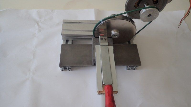

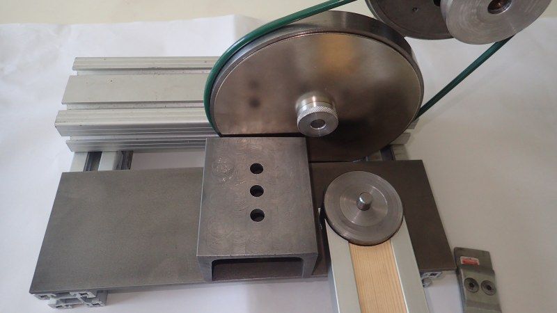

                    PekkaNF
                      @pekkanf
                      Build something like that 2017 to lap carbide scraper blades. I used 90W 2800 rpm furnace blower motor geared dow with round belt pulleys.
                      I used scraped aluminium profile for frame and build very simple spindle with two ball bearings that acsept 12 mm shaft. i glued one bearing (fixed bearing) and left another easy fit. All parts and materials from scrap box.
                      Work table is mild steel to allow fixing jigs there with magnets.
                      Different holes for different r (on scraper blade radius).
                      Plinth made of C-section mild steel is milled to proper angle (scraping blade needs small negative angle).
                      Slow speed works fine and even blade change is not too hard with knurled knob.
                      Edited By PekkaNF on 12/11/2019 17:31:09

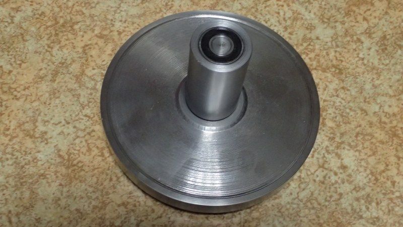

                      #437544
                      Chris TickTock
                        @christicktock
                        Adapter now made not 100% happy with as blind hole face could be better but on whole acceptable and should do the jobadaptermk1.jpg
                        Thanks for all help and posts which are appreciated.

                            #437584
                            Ian P
                              @ianp
                              Posted by Chris TickTock on 16/11/2019 12:40:45:
                              chris
                              I would not be in the slightest concerned with the state of the face at the bottom of a blind holes, its not like anyone will ever see it and its serves no functional purpose whatsoever. As long as the shaft enters far enough its done its job.
                              One observation I would make is to say that ideally the grubscrew should make contact with the shaft about half way along their engagement length. It helps to increase the chance that the axis of the two parts are parallel with each other.
                              Out of interest, how did you ensure the concentricity of the bore relative to the threaded shank?
                              Ian P
