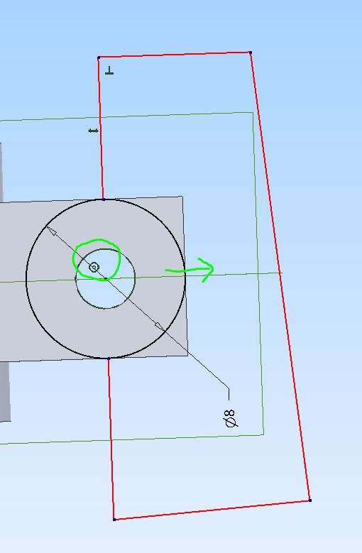

      20 constraint icons showing in the sketch I posted so maybe I’m doing something right😊😊😊 would be more if I had not purposely made the sketch with the tiny error
      Yes that is the way I tend to do things place the circle approx where I want it and then use a concentric constraint to line it up with the hole already in the link, snap will put my dividing line central. Draw a rectangle and then size it and make it symmetrical or align a side with an existing feature.

        Hope you don’t take my comments amiss, Jason – not your sketches I was thinking about! And I do see on closer inspection that at least one of Nigel’s sketches include a few constraints – although not as many as I would expect. Of course, you can’t tell whether or not they were explicitly added or automatically added by Alibre.
        The real point is about the general approach, which really needs to play to the strengths of modern software and not apply traditional draughting techniques which are designed to achieve a very different end. Every screen used with 3D CAD needs to have “a sketch is not an engineering drawing” engraved across it!

            Falling apart when you try to rotate the crank is likely to indicate that the parts in the assembly are not fully constrained but just placed by eye. Therefore, they move in more than one direction when all you want to do is drag the crankpin around with the mouse.
            Symmetry is one I use a lot as well as fillet so worth spending some time trying your luck. The one thing I find with symmetry is it can sometimes need the mouse hovering over a differnt part of the first axis line in orfer to get it to change colour and be selected.
            With paper and pen you would take your rule and mark a distance then draw the line through that point. With CAD it is really the opposite. Place the line often letting it snap vertical or horizontal. After that to position it with either a dimension or constraints and then give it a length or trim it to other features. This also helps to ensure the sketch is fully constrained and you have not just placed something buy eye. Constraining also helps when you come to make changes as if features are correctly constrained anything related to that feature will adjust itself.
            Taking that link rod if the semicircle were not concentrically constrained to the hole in the rod and you subsequently altered the length of the rod then you would end up cutting away more of less of the rod and not rounding the end as it should be.
            Taking Nigel’s earlier image I would not expect to see much more in the way of constraints. Alibre won’t show the constraints that were used to construct other features that made up the square ended rod. It has snapped the 0.375″ circle to the dashed green axis line, the green double ended arrows indicate the diagonal line is vertical and the other three lines that make up the shape are not critical so can be unconstrained. What I can’t see is the concentric constraint symbol to tie the whole thing left to right although the inner hole has changed to green which can indicate it is or was being used as a reference. If it is not concentric then Nigels 2D sketch could be too far to the right and that is why there is a flat spot on the end of the rod rather than the fillets meeting.

              I didn’t even think about constraining the two circles to each other – didn’t occur to me, or I didn’t realise the possibility. I set their centres by dimensions from the flat surface at the far end.
              The hole and arc are where they are supposed to be. The flat is more likely from making the initial outline slightly undersize, perhaps as I think you suggested previously by under-rounding the dimension. The physicall making wouldl be cutting steel back to the intended size so should not create a flat in the real thing.
