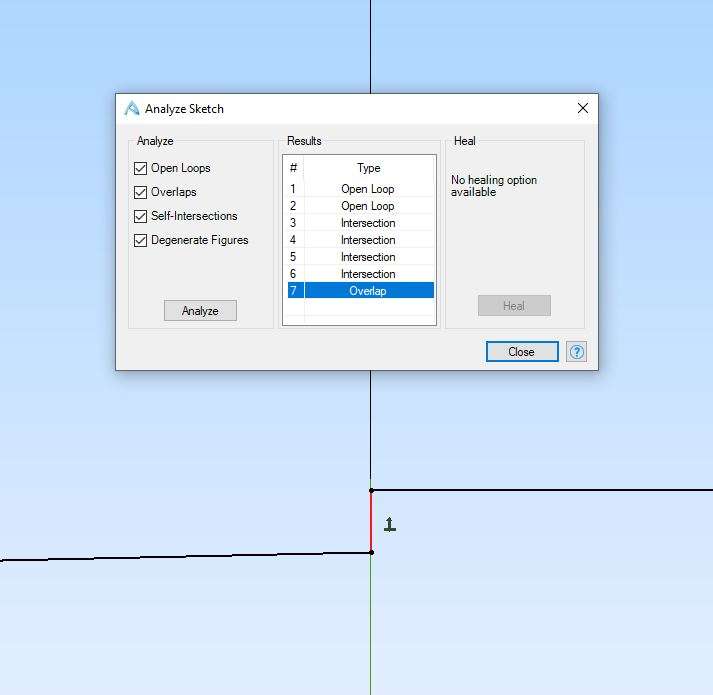

      I am trying merely to represent a semicircular end on a link, by creating a semicircle concentric with the pin-hole then joining its ends with a rectangle around the end of the “metal”. It’s worked on other drawings.
      Attempt after attempt – change this, delete and re-draw that…, and every time:
      “9003: The sketch cannot be used because an endpoint is wrongly shared by multiple primitives or has overlapped figures.”
      “Help” tells me is only the same thing in more words, and seems to be for the high-level editions of the software.
      The display shows only what I have drawn, not what I have done wrong, how and where. No highlighting of faulty points invisible even at high magnification. The error-message table merely lists arcane names. Its “Heal” tool is not supplied.
      How on Earth is an ordinary user who has never programmed a computer supposed to know what this Alibrese means, and how to put it right?

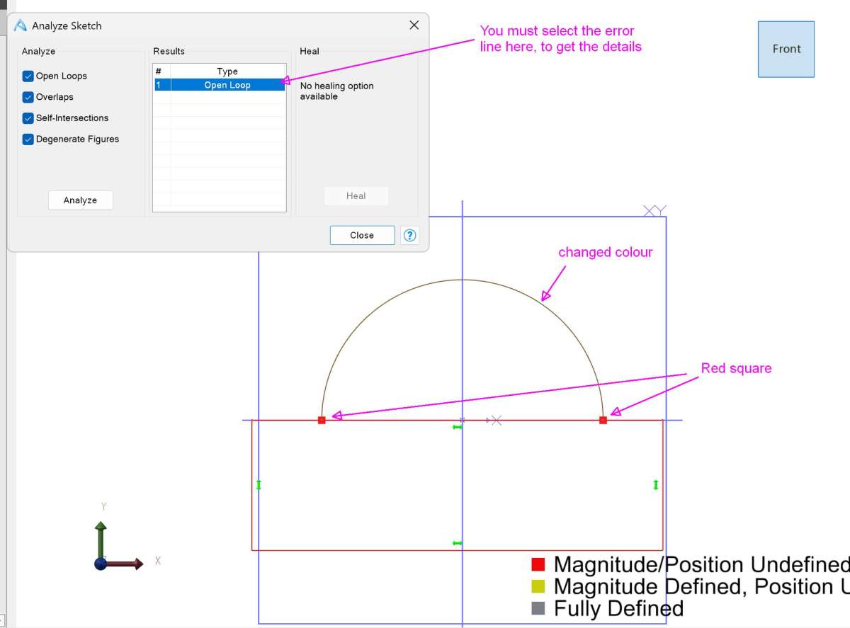

              Nigel – I did some tests, the error message you report comes from the 3D feature that you tried to produce from a 2D sketch that has issues.  It is a generic message that can be caused by many different issues with the sketch.
              You appear to have either turned off sketch analysis or are ignoring it.  Sketch analysis will give more specific information regarding what is wrong with the sketch.
              If I had to guess, I’d suggest that the ends of the arc don’t quite meet the ends of the straight lines, or you may have used a rectangle in the sketch and failed to trim away the line segment that traverses the arc.
              Using closed sketch profiles is critical to success in most 3D CAD systems.  If sketch figures cross, overlap, or leave gaps, there will be failures.

                    When the analyse results window shows up, you have to select one row of the results at a time to get it to display where the error is.  Usually a coloured square will display at each end of the problem.  Sometimes the indication is a lot more subtle, just a slight change of colour.  Having identified the error, you have to close the analyse tool to fix it, then try again.
                    Analyze Output
                    The Help offered is to try to show you how to find the error(s).  It’s always easier to do that with the file that you have been working with, so it means something to you.

                        Sketching a rectangle over an existing line as descried in your method above will leave overlaps that have to be removed.  Easier if you omitted the step with the line and moved immediately to using the rectangle.
                        Where you have got overlaps, it is sometimes useful to use the ‘advanced selector’ to choose a specific line of you can’t easily grab it.  Right click on the indicated problem, then choose ‘advanced selector’ from the context menu – that displays a list of items under the cursor and you can select from the list.  The selected item will highlight on screen.
                        #817000

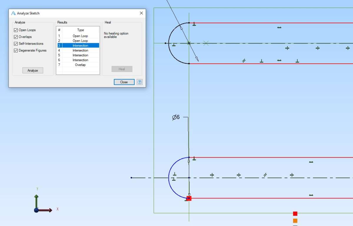

                          Two rounded ends the bottom one done as you describe, the upper without extending the diametric line beyond the circle. Both “look” OK once the unwanted lines have been trimmed until you close the sketch then Analyse finds the faults all of which get highlighted as you click the error on the screen.
                          extend
                          As the error is actually two lines ontop of each other but only 0.0005mm long you really need to zoom in a lot to see them. I’ve added a line 0.01mm ( 4/10ths of a thou) long so you can see how far I have zoomed in, that is 10,000 times magnified so without using the analyse to highlight the errors you have little chance of finding some errors
                          extend error

                              I should say that in the above example clicking “overlap” at the bottom of the list does not highlight it or change the colour of the line. But all the other errors are at one of the ends of the overlapping line so a good pointer as to where the error is.
                              #817006

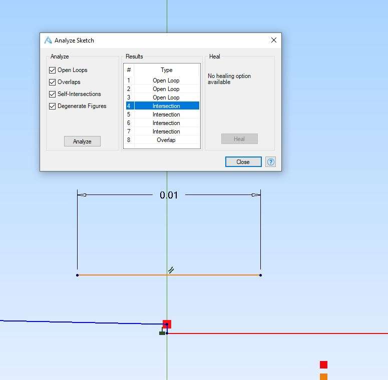

                                I just followed Nigel’s method to create the sketch (or at least how I interpret his description) – the Analyse tool didn’t really display the location of the overlap clearly – however, the same extra line that caused the overlap did show other errors which do display clearly.
                                If there are occasions where the Analyse tool is failing you – please report that to Alibre Support, if there is a bug or just something that can be improved in the software, it stands a much better chance of being attended to if it gets reported.
                                [EDIT – I just checked the Alibre Development issues list, it looks like a known issue that overlap highlighting is not visible if the sketch figure in question is under-defined, as the highlight colour used is the same (or very similar) to that of an undefined sketch figure.  Hopefully this will be improved in a future build.  I have added a comment to the record, to get some renewed attention.]

                                  And if proof were needed it now shows the overlap if I fully define the sketch.
                                  David, as you still need to zoom in a lot to see just the colour change can I suggest overlaps are also highlighted in some way rather than just changing the colour, much like the other errors get highlighted.
                                  defined

                                    I believe that some versions ago there was also the red square at either end of the overlap.  That likely got lost when the graphics engine was migrated.  I’ll add a note to the ticket.
                                    #817017

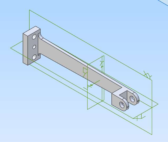

                                            I’ve just tried again and of course it worked perfectly this time, so I still haven’t the foggiest what was wrong. The images show the construction and end result:
                                            1) Vertical line (not a reference line) at the set distance from the foot of the link – it’s on its side in the drawings.
                                            2) Horizontal reference line to indicate the centre, then the generating circle. (Is it possible to make construction lines and dimensions survive switching from sketch to model and back again, for each step?)
                                            3) Join the dots right round the outside.
                                            4) Trim away the inboard half of the circle, and unwanted bits of the first line.
                                            5) Extrude cut to give the rounded ends.
                                            No tangents or anything like that, with their potential traps, were harmed in the making of this model. I am not sure why there is a tiny flat on the ends. I must have made the initial shape slightly under-size. The internal corners at the ends of the central section are not meant to be sharp. The depth of the clevis will clear the basic radius of the shape of the link it joins, but that shape might need altering to let the links act in a way predictable only by a lot complicated geometrical construction or repeated two-dimensional drawing.
                                            Screenshot 2025-09-22 212134
                                            Screenshot 2025-09-22 212217
                                            Screenshot 2025-09-22 212330
                                            The “Alibrese” I am supposedly meant to understand came when I tried to extrude-cut the shape, first time round.
