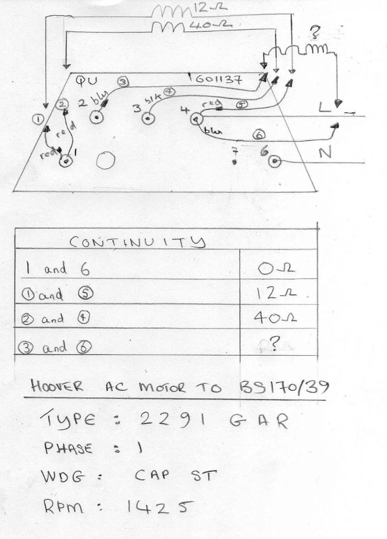

      Hi. I have a Hoover motor model 2291 GAR. I don't know how to wire it up. It might be missing a start capacitor. Please see the drawing I made. Can someone please tell me how to wire up this motor? Thank you.
      As per the drawing: There are six wires numbered 1 to 6 the numbers I've circled. Three windings. There are 5 terminals marked, 1, 2, 3,4, 6. There is continuity between terminals 1 and 6, with no wires connected the terminals. Otherwise no other instances of continuity between terminals when all wires have been disconnected from them.
      The resistance value between wires 3 and 6 varies when I rotate the rotor, seems to go from zero to 40 Ohms. Don't know why..
      Live and Neutral shown as it was wired when I got motor.

          Aah. The centrifugal switch is connected to wires 3 and 6 (terminals 2 and 4).. So, the question mark shown is not a winding but a switch. That needs to be in series with the start winding, which is wires 2 and 4 (1 and 3). The main winding must be wires 1 and 5 (terminals 1 and 4).
          Presumably given what is on the name plate, this motor needs a capacitor in series with the start winding and the centrifugal switch?

            Yes you are correct….it will need a capacitor in series with the start winding to get things going …..
            Just make sure the centrifugal switch is not sticky….

              Hi. Yes, that switch is temperamental. The start capacitor connects between terminals 2 and 3. That puts the start winding and the switch in series with it. At the moment no capacitor, so it cannot start.
              I wonder what value the capacitance was for this motor.

                    120 uF is about the value I would expect. It is worth trying it. Confirm that the 950 RPM motor works before removing it. Also fix the fault with the centrifugal switch first. It should not change it's resistance when the motor is rotated slowly. It should be near zero ohms when the motor is stopped or rotated at low speed. It should change to being open circuit (Or at least many meg ohms ) when the motor reaches near its rated speed. Assuming the motor works the the capacitor from the other motor I would suggest fitting a new one as the capacitor is probably very old.

                            I have not seen the design of the centrifugal switch on your particular type of motor so it is difficult to know why its contact resistance is changing as the motor is rotated. On the ones I have seen when the bob weights fly out it moves a collar along the shaft which causes the switch to open. Possibly the end float may be allowing the collar to be touching the switch when it should not.
