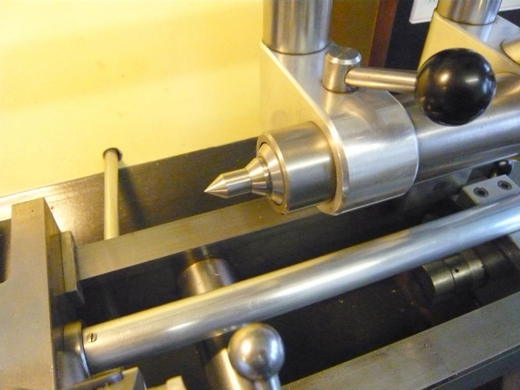

        Hi All
        Years ago I made a rotating lathe centre using a crowded needle roller bearing at the front with a ball thrust bearing behind. The outside diameter was just below 1" diameter as this avoided the restriction of the then conventional rotating centres featuring a large diameter body. This proved to be very useful over the years so recently I gave it a makeover and reground the point. I had a similar needle bearing and thrust bearing so I made another centre for my Stepperhead lathe. The reduced diameter body can retract into the tailstock barrel for maximum access. The reduced diameter point was just to see if it would be advantageous. The points can be exchanged if required. After doing all this I looked on Ebay and found that you can buy these quite cheaply, Ah well. I have added a couple of pics in my album.
        AlanStepperhead Centre

          Neat in the execution. I assume Stepperhead is continuing to earn its keep then?

              Neil,
              "Neat in the execution. I assume Stepperhead is continuing to earn its keep then?"
              Yes, I used it to make the Morse taper by setting the X and Y axes to cut the taper and I also ground the points after hardening them using the milling head with a diamond grinding wheel.

                    John,
                    I made this centre about 40 years ago and it has been fantastic and never given rise to any of the problems you seemed to suffer. The hardened steel centre has a close running fit even today. It has been used and abused and very rarely lubricated. It does not suffer from chatter or affect the surface finish. Just does its job.
                    Alan

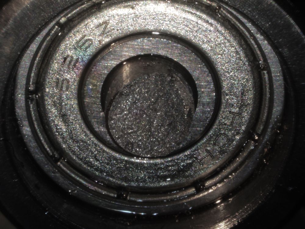

                    Ian P this is what I found on Ebay
                    http://www.ebay.co.uk/itm/2MT-SMALL-BODY-REVOLVING-CENTRE-FOR-MYFORD-LIVE-CENTRE-/370825984005?hash=item5656f37805:g:bzgAAOxyHE5RqKa6

                      #212410
                        Ian,
                        May I suggest that you read through Nick_G's thread **LINK**
                        [Alan] … Yours looks a superb job.

                            Here is the missing point:

                                    #212434
                                      For completeness … here are some details of how Gepy does it.
