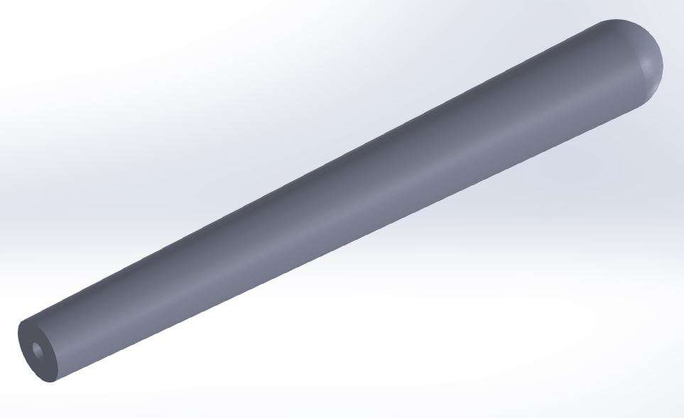

      I would like to know who one would go about holding a tapered bar in the chuck if it is possible. I look forward to any answers on this matter.
      Thomas

                I would like to add a threaded hole at the bottom and create a dome at the other end. I have a ball turning attachment but this can’t be used while there is a revolving centre at that end. I could create the dome before I add a tapper to the bar but that would mean using a centre punch on the top of the dome to hold the revolving centre leaving its mark after the work.

                  Drill & tap the hole before cutting the taper. After cutting the taper, make a parallel  arbour that screws into the threaded hole, grip that in the chuck and use a fixed steady close to the other end to machine the dome.

                        Can you make the blank 1″longer to start with? Place the blank into the chuck and turn the dome on the end. Reverse the blank and turn down the last inch to the minor diameter and droll through the !” plus the depth of the threaded section and thread this.
                        The extra can be held in the chuck and by making a small adaptor to fit over the revolving tail stock with a reversed V which can be pushed against the domed end then turn the taper, finally part off the extra 1″ hopefully the parting off will leave a pretty clean end.
                        Hope that makes some kind of sense.

                              Take your piece of bar and face one end, spot drill, drill and tap your thread.
                              Hold in chuck to face the other end to overall length and form the dome.
                              Take an odd piece of rod, turn down the end and thread to fit the hole in your part.
                              Screw the part onto that threaded arbor which will drive it and also allow you to turn the taper right to the end (you can cut into the arbor)
                              Put a female ctr in the tailstock and bring that up to support the domed end
                              Turn the taper

                                              To add to the conflicting advice, do the easy jobs first, while the material is parallel.
                                              Make the blank, drill and tap the end, reverse in chuck and form the dome.
                                              Then screw onto a threaded arbor, and use Jason’s suggestion of a hollow centre in the tailstock, to support the domed end while the taper is cut
                                              If you make the threaded arbor, and then do not disturb it , the thread should be concentric.
                                              If the taper is longer than the Top Slide travel, you will have to turn the taper between a centre in the headstock and offset the tailstock. The hollow centre will accommodate the offset, but lubricate it.

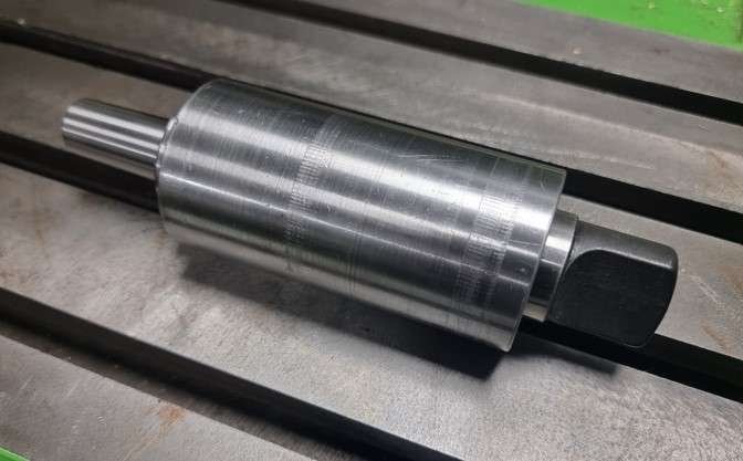

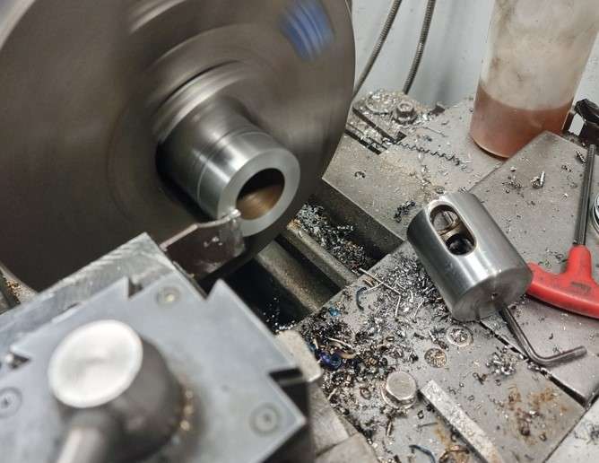

                                                    I’ve been modifying MT4 arbors by cutting off the tang and drilling&tapping the end for a drawbar thread. I purchased an old MT4 cpstan turret sleeve and cut the end off. That allowed me to knock the arbors gently into the open-ended sleeve and hold the parallel outer diameter in the chuck. There’s no need for any other method of securing it holds the taper firm enough for turnong, parting and drilling.
                                                    Capstan Sleeve
                                                    Sleeve parted
                                                    Sleeve cut
                                                    #826649
                                                    Diogenes
                                                      @diogenes
                                                      Peter, does that really hold them firmly enough for the drilling op. from the small end ? – useful if so..
