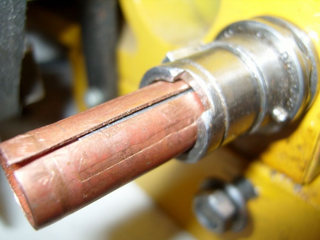

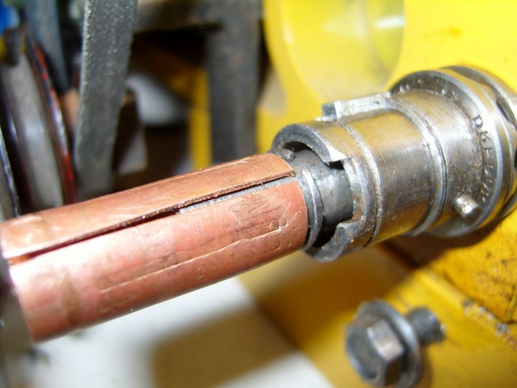

          Hi T Bracey, don't know if you have resolved your issue with the C clip, refered to a 12 X 1 snap ring in operating and maintenance manual, but the easiest way to get it back in is to use a thin tube. A piece of domestic 15mm copper pipe with a cut down it's length as the outside diameter is to big, will do fine, just put the snap ring on the end of the leadscrew and push it up with the tube until it snaps into place, hence the term snap ring.

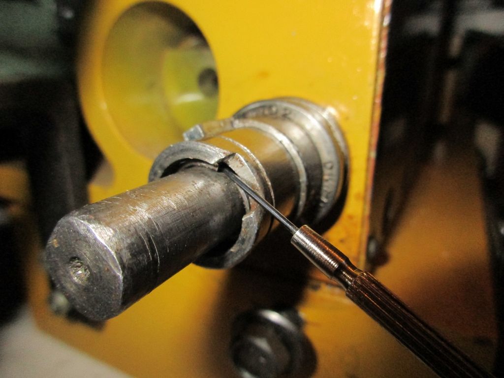

              Hi Tim, yes it's a bit of a fiddley job and the best way I've found is to line the gap in the snap ring with one of the dog gaps and then using a small watch makers flat blade screwdriver into the snap ring gap and lever one end out of the groove.

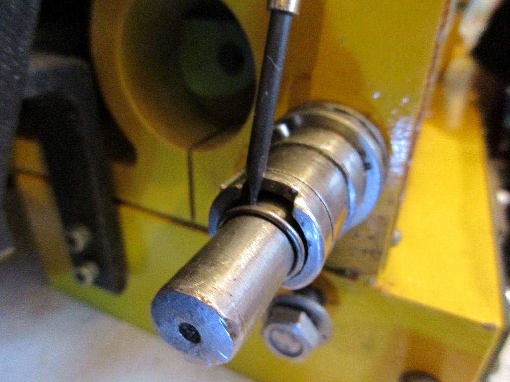

              You then have to chase it round the shaft, turning the dog as you go.

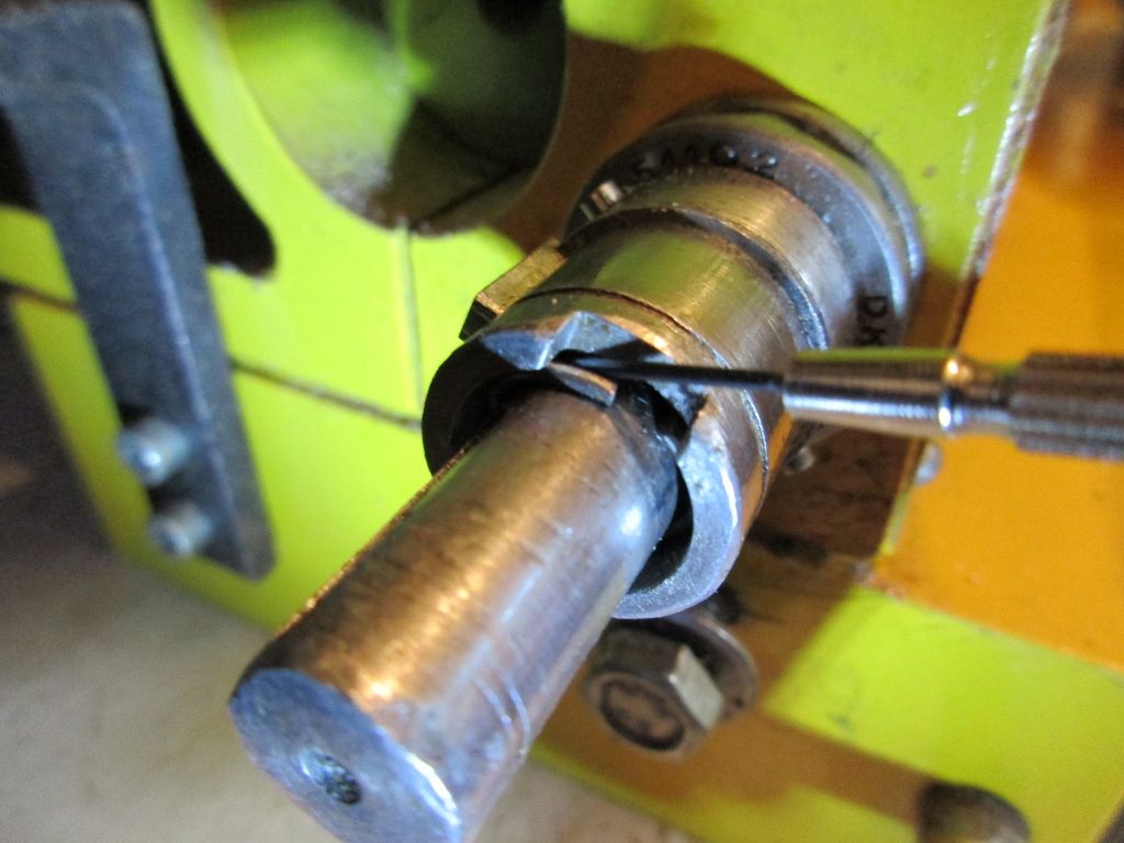

              When you get to about half way round the shaft, you should be able to get a larger watch makers screwdriver behind the snap ring and pop it out, but keep the smaller screwdriver behind the snap ring while you are poping it out with the larger one, otherwise it's likely to snap back in.
              It may well take two or three attempts, because it is a bit of a fiddley proceedure and you could do with three hands.
