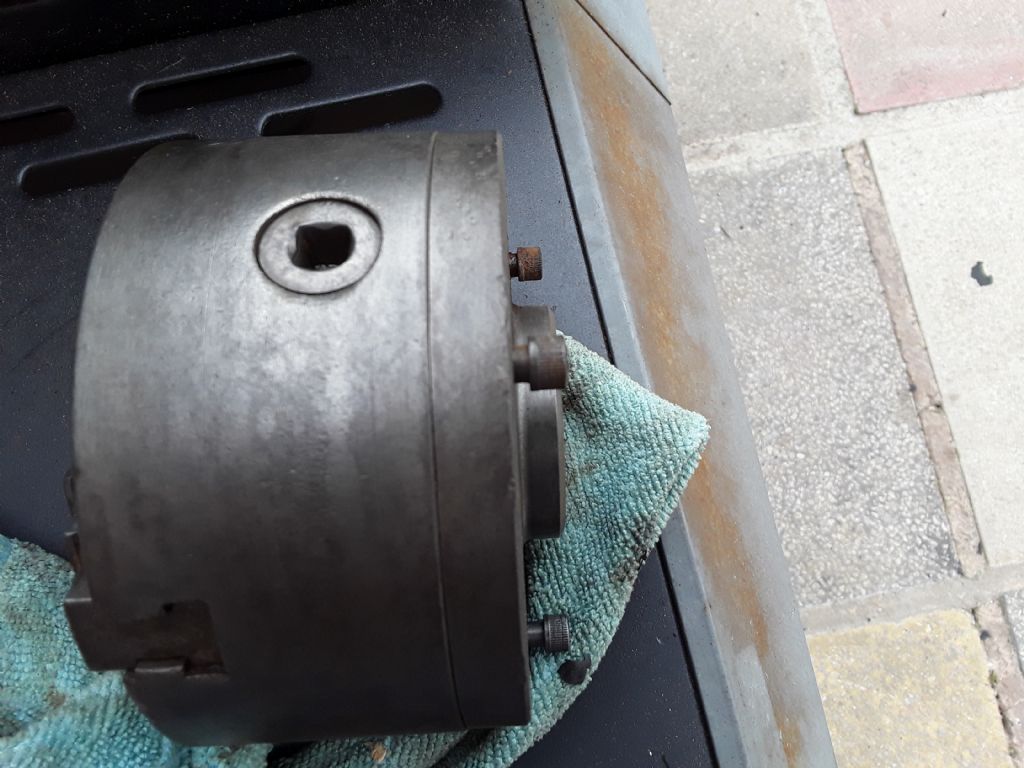

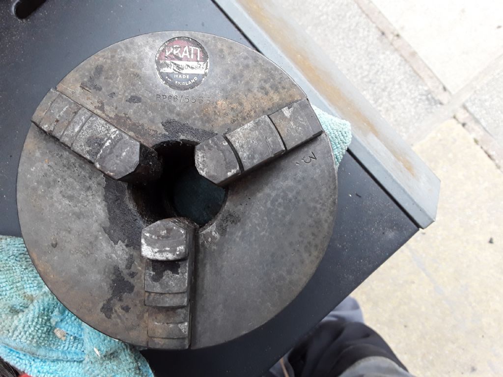

        Hello all,
        I have an issue with Norris. Am I right in saying that if I remove the 3 cap bolts from the back plate, the front part should just pull away from the back plate?
        Will upload pictures in a mo.
        Thanks in advance.
        #295391
        Martin Faulkner
          @martinfaulkner67684
          3 jaw front
          #295392
          Martin Faulkner
            3 jaw side
            #295393
            Martin Faulkner
              Forgot to mention, I need to split it to clean it as it seems to be coated in crap and rust on the inner and is stiff to move.
              #295394
              Speedy Builder5
                @speedybuilder5
                don't forget to put a location mark on the chuck and backplate before you separate them.
                BobH
                #295400
                Robbo
                  @robbo
                  Second Speedy Builder's comment about making a witness mark.
                  Removing the 3 screws should let the backplate come free of the chuck, but don't forget that if it has been fitted properly it will be a very tight fit. With crap and gunge could have become "glued" together. Giving it a good soak in wd40, paraffin, w.h.y. and a tap all round the edge with a mallet will help free it.
                  #295534
                  Martin Faulkner
                    Thank you very much, yes it was full of crap, it was a badly smoke damaged and had been covered in what ever melted off the shelf above. So wanted to make sure before I took wd40 And a mallet to it. I have never dismantled a lathe before so I have marked everything. Lol. Probe rely overkill but it works.
                    #295548
                    Ian Welford
                      @ianwelford58739
                      I used moly grease on rebuild , on the pinions (bits the chuck key turns ) and it works well.
                      Regards Ian
                      #295552
                      Martin Faulkner
                        Thank you for the tip Ian, I was wondering that but thought the swarf may cause issues with it. I try and limit the daft questions as I will need help in the future and would like some friends. Lolwink
