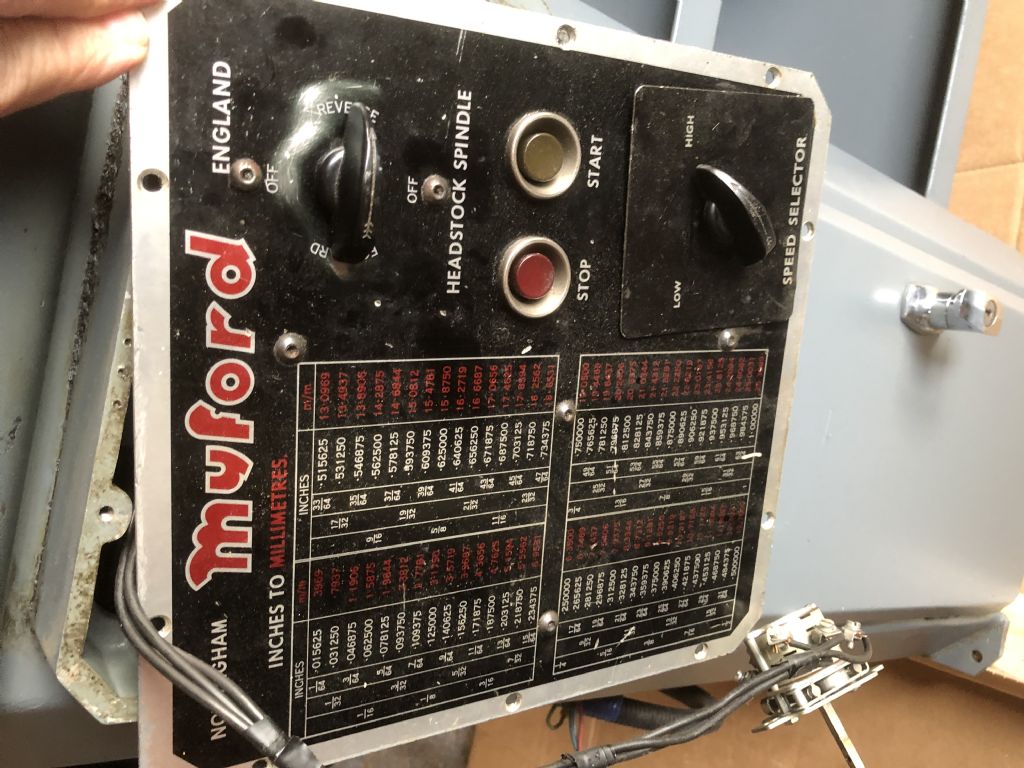

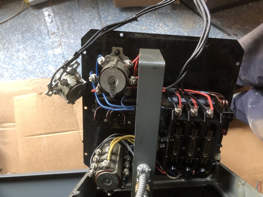

      Hi,

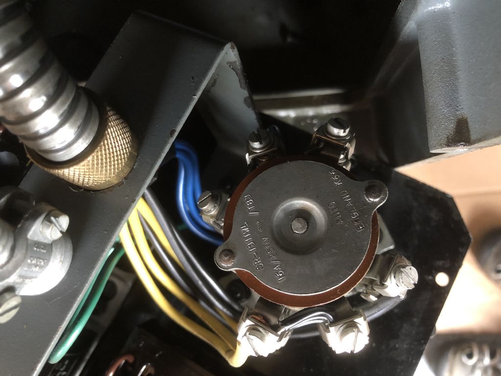

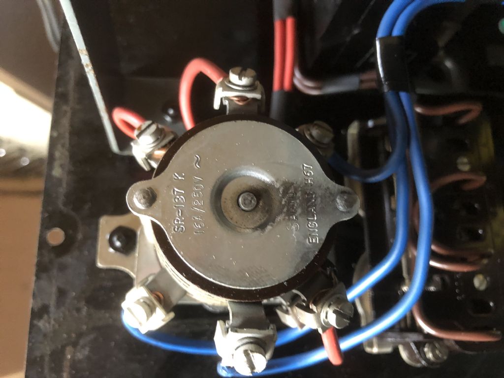

      I have a single phase Myford Super 7, I did not get a cabinet with it, so I have just bought an industrial style cabinet for it.
      I think the cabinet is wired for 3 phase. See pics below:
      The loose switch in the pictures is the coolant switch.
      I have some specific questions:
      1, Can anybody confirm this is a panel for a 3 phase motor?
      2, Can anybody confirm a rewiring scheme to wire up my single phase motor?
      3, The panel has high and low speed, that I believe would require special 2 speed motor, single or 3 phase. Is that true?
      4, Are my options limited to ? :
      4a, Rewire for single phase
      4b, Install an inverter. If so am I correct in thinking I need a three phase motor, as well as an inverter?
      4C Any other options?
      Thanks in advance
      Jeff.

          The coil voltage on the contactor is going to need to be 240v for a single phase panel, it may be simpler to replace the contactor if it is 415v as tracking down a 240 coil is likely to be difficult. It may be possible to unwind some turns from the coil bobbin if you fancy a challenge.
          The two speed motor would make it likely that the cabinet was for a Trilever ML7.
          Apart from the contactor issue it should be possible to rewire for single phase.
          A VFD is almost universally recommended, they have some limitations but the pluses trump the negatives for most people.

            Hi Mike,
            I can check that by wiring to 240 and checking it operates OK. Will post results.
            Thanks
