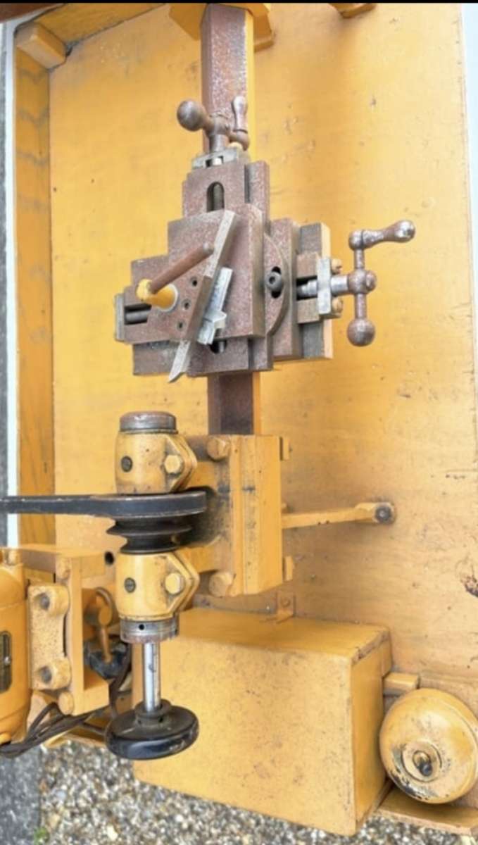

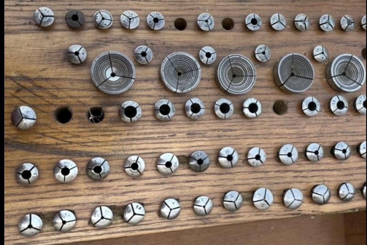

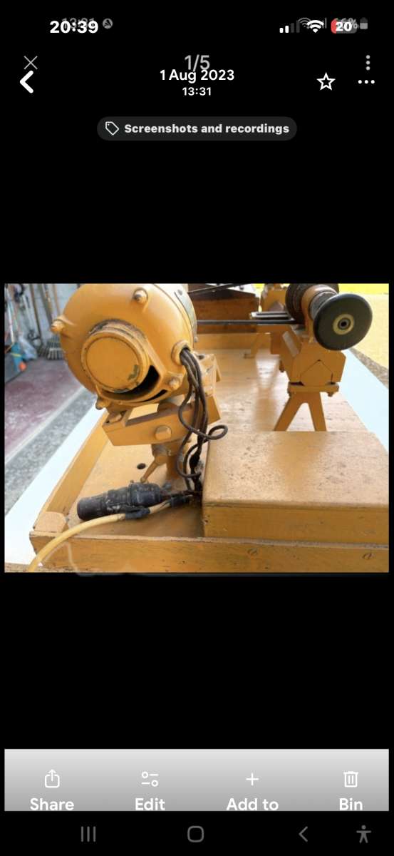

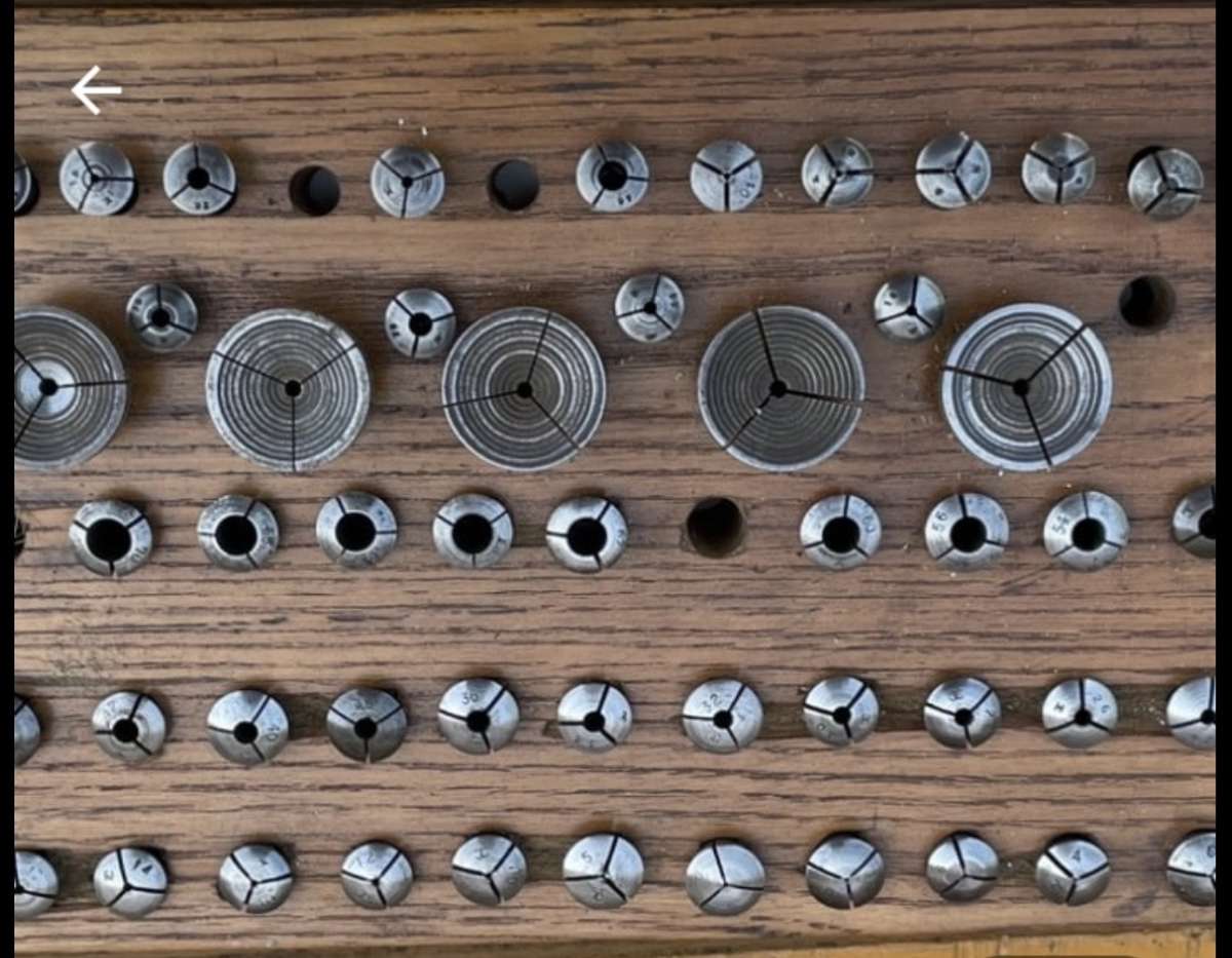

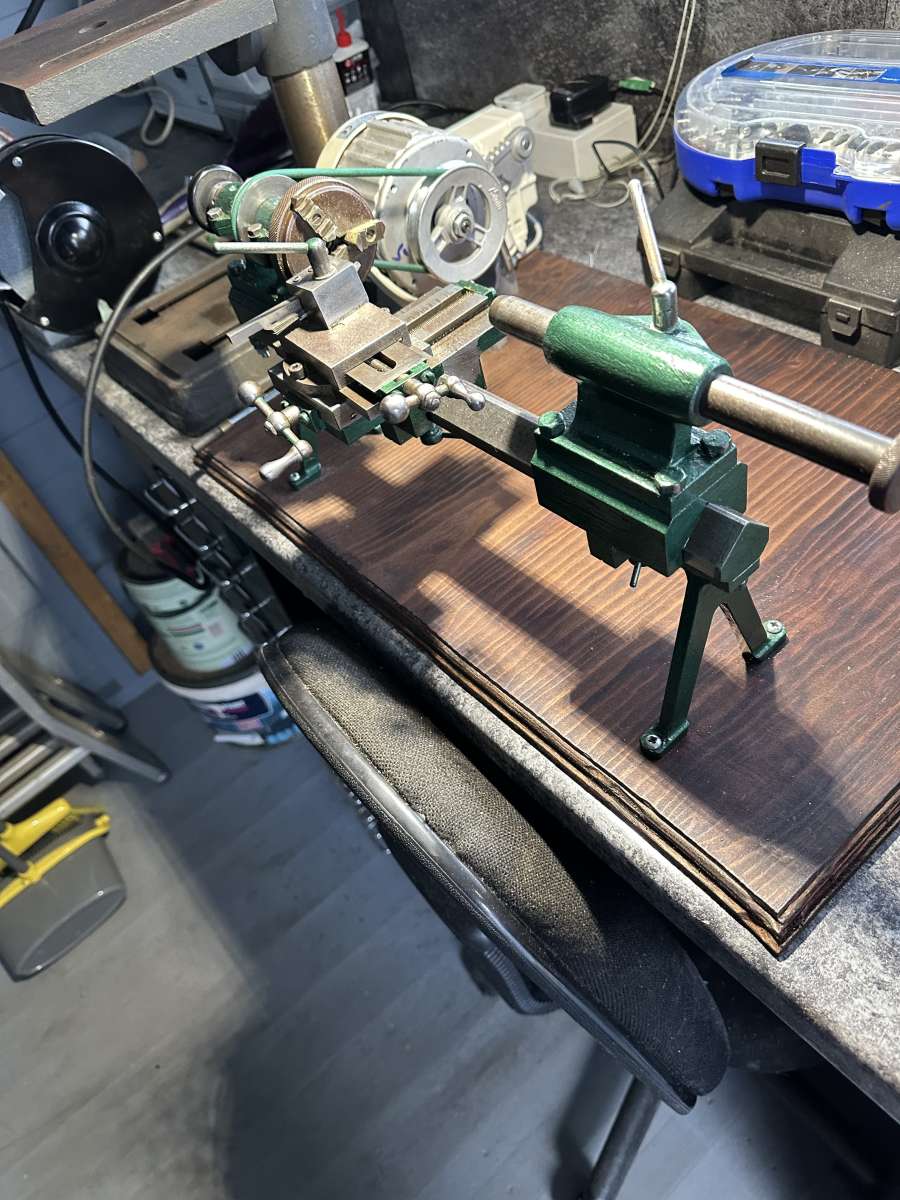

      Hi all , I have recently brought a small lathe it needs a good clean up as it has surface rust and the motor has burned out . I was just wondering if anyone on here knows what lathe it is as there are no numbers or name on it . I recently sold my uncles lathe and sore this at a fair price so I think I paid £80 for it and it has a good selection of collets a 3 jaw chuck and other bits and pieces which as they stand are in a sorry state but I am working on it cleaning it up . I have been given a jack jk 513a motor with control box and I want to put a speed control switch on it but have no idea how to go about attaching one as you can adjust the speed via the control box but I don’t have a pedal for it . If anyone on here can help me out I would appreciate it thank youIMG_0161IMG_0165IMG_0166IMG_0162
      #830591
      John Haine
        @johnhaine32865
        Looks like a nice watchmakers pattern lathe and great to have a collet selection with it.
        Regarding the Jack motor, a few people here have fitted them to small lathes successfully and got round the foot pedal problem.  Some searching on the forum should help and hopefully one of them will also provide some help.

                Some Manufacturers used to stamp their name on the end of the bed and as yours is covered in paint!
                #830624
                Nev Whitehurst
                  @nevwhitehurst53938
                  <p style=”text-align: left;”>Hi Bernard . I am in the process of cleaning it up . I have now removed all the paint and rust and there are no names or numbers stamped on it anywhere . I am going to repaint it as there is hardly any chrome plating left on it just black cast should have it finished over the weekend then I’ve got to sort the motor out</p>

                    Q1 What is wrong with the motor attached to the lathe and why do you need a foot controller? Try rewiring and using that motor first, it may be all you need.
                    Q2  By a ‘Jack’ motor, Do you mean an electronically controlled BLDC motor of the type now commonly used for commercial sewing machines?
                    If the answer to Q2 is yes, then there are a number of options available. Depending on how your unit is configured, you may be able to leave everything associated with the hall speed sensor intact and use a simple mechanical linkage solution. This may be preferable if you want foot control as these motors usually come with parts to permit this (foot or knee levers being normally used for sewing machines).
                    Alternatively, you can replace the hall sensor with a voltage divider and potentiometer but this will require some simple ability for circuit design and construction. There are H&S risks involved with this approach but they are manageable. This would be more suitable if you want a more precise and stable speed control, as with an engineering type lathe.
                    To get some idea, trawl around on the net or you tube and get a feel for what others have done.
                    #830648
                    Nev Whitehurst
                      @nevwhitehurst53938
                      hi Martin . I don’t want a foot control , I want to use a speed control switch instead of a foot control . The motor that it came with is burned out I had a friend look at it and it’s no good . I’ve been given the jack jk 513a motor and control box which does work but I want to fit a speed control switch to it but not sure how to go about it

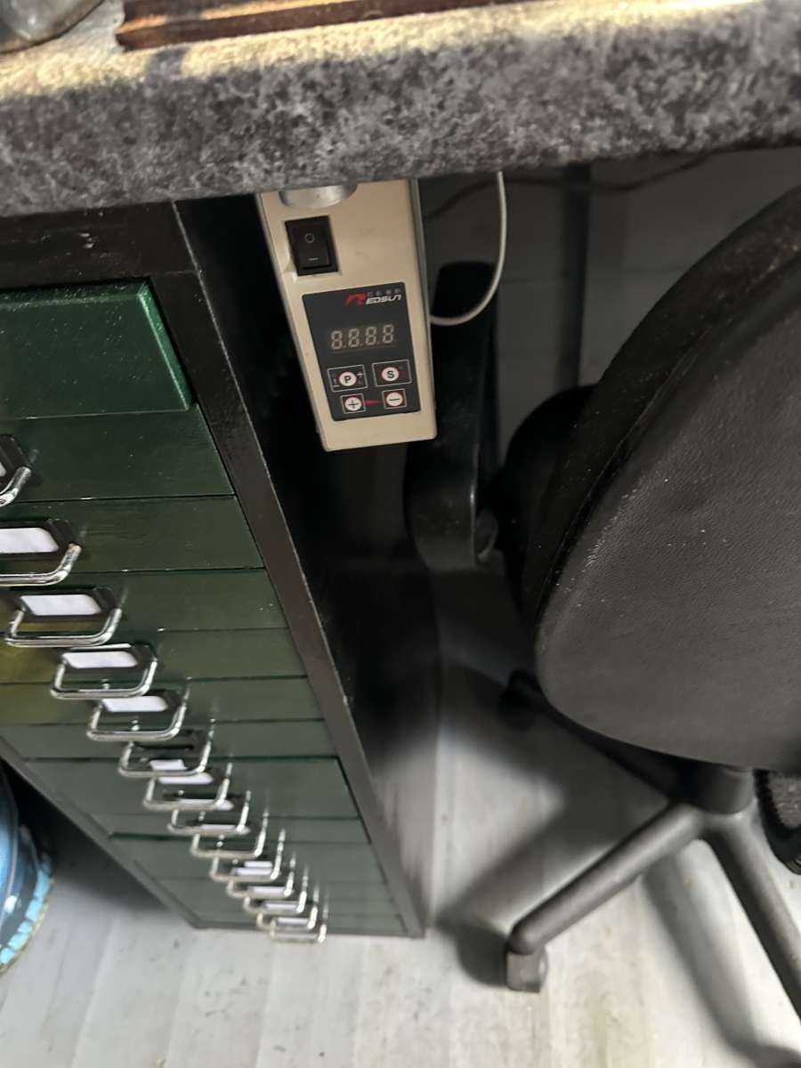

                                      #833290

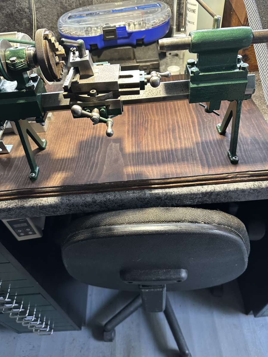

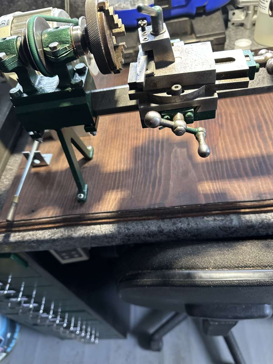

                                      Nev Whitehurst
                                        @nevwhitehurst53938
                                        IMG_0306IMG_0307IMG_0300IMG_0305Hi all sorry it took so long to get back with the finished project but here it is still got a couple of things to finish off but it’s all working I had a little play with it and all seems well , I was given another motor and control box which seems to be easier to use than the jack one this one is a redsun which is a lot quieter than the jack
