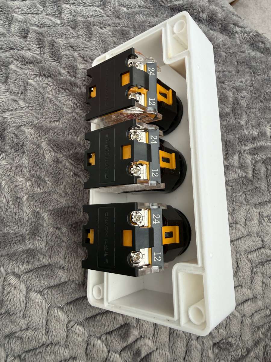

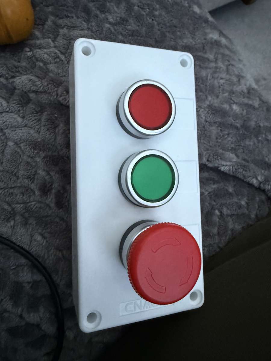

      Hi All,
      Fitted a single phase motor to an old surface grinder I have and it runs great. However prudence dictates I fitted an emergency stop button and this is where I’m up against it.
      svrsvr1svr2
      Bought this switch and I have no idea how to connect it so throwing out to my friends on the forum to guide me home lol. Some of the vids I’ve watched the switches only have 8 connections where this one has 12, presuming its down to the magnetic side of things. So basically I have 220V going in and out and need simpleton instructions on how to connect?
      I’m competent in nearly all areas of engineering/construction but electrics is something beyond my scope of expertise I’m afraid so your help is greaty appreciated as always.
      Best regards to all

          Do you have a contactor or relay in your circuit? The switch box you have bought appears to be intended for a control circuit such as a VFD or contactor.
          Are there any markings on the switch such as a current rating or part number. The E-Stop may not be capable of crrying the motor current which is not ideal. It appears to be a latching control switch rather than a power braking type E-Stop.

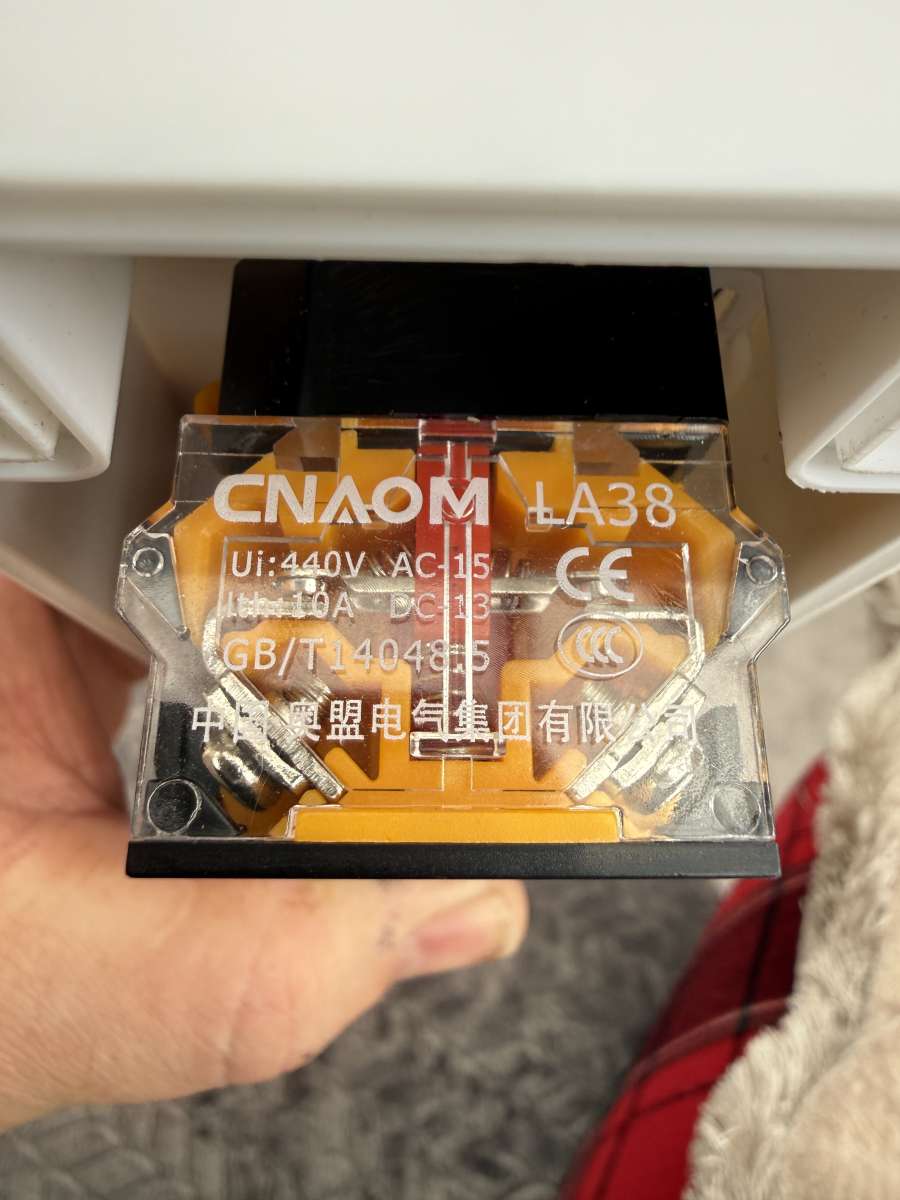

            Ex contributor
              @mgnbuk

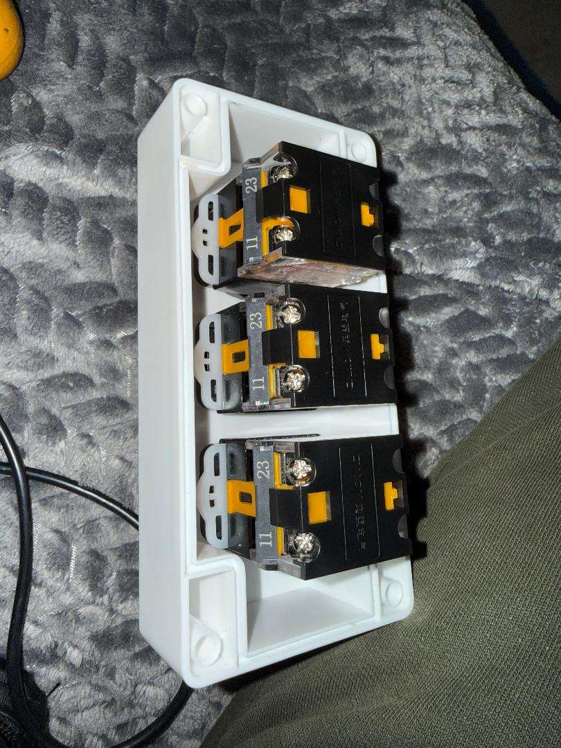

              The switch contacts look to have a standard marking – first digit is the contact number, second digit denotes contact type where 1-2 is normally closed and 3-4 is normally open.
              So of each switch’s contacts one is normally open and one is normally closed. A few seconds with a multimeter will confim this.
              HTH

                Hi Gents,
                Typical I waited a fortnight as I unknowingly bought from a chinese supplier posing as UK based and now it might be wrong one anyway 🙁
                I honestly thought a cut-ff switch was a cut-off switch but in hindsight I should of asked here first, noob mistake!!
                This is all I can see on the terminal blocks

                  Did run multimeter over contacts last night and found contacts 11 + 12 have continuity which stops when button pressed and continuity then at 23/24.
                  I thought logic would prevail and i could work it out but the magnetic side of things threw me all a kilter lol

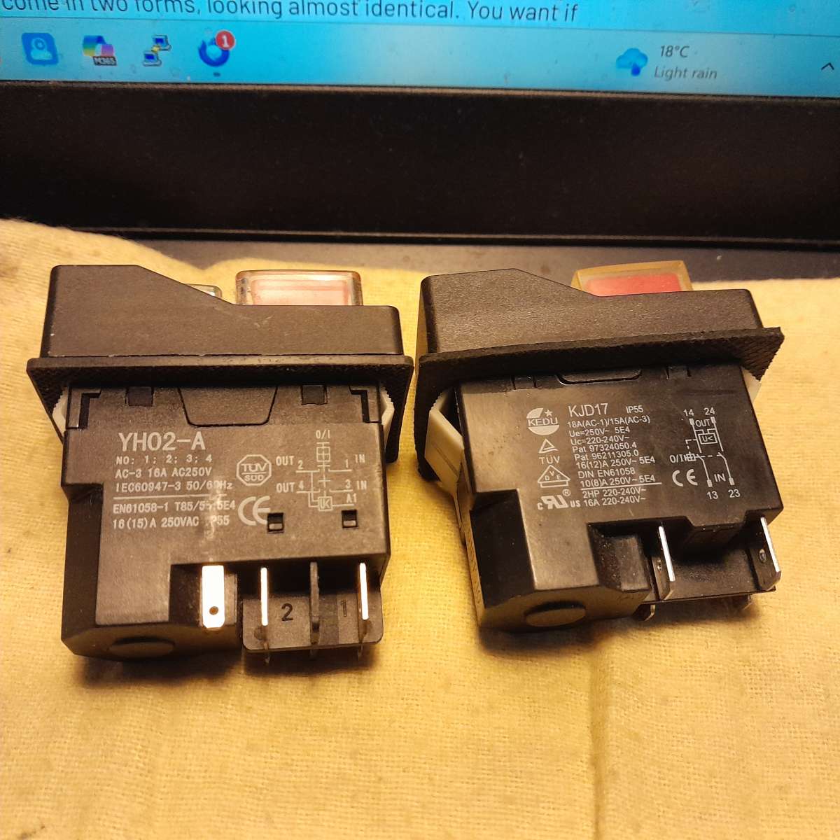

                        NVR relay switch units come in two forms, looking almost identical. You want if possible the rarer  type that have auxiliary connections to  add in additional stop switches so that you can in future add a safety shield interlock.
                        #847411
                        Bazyle
                          @bazyle
                          And it turns out I have one of each that I can actually find on my desk!
                          no volt releaser
                          The extra pin on the one on the left has to be connected through your interlocks and safety switches, lots of them in series, and then to live. All such swicthes then have to be closed to allow the relay to power up and any one breaking drops the relay power.

                                        The push button switch station consists of three switches, one is a momentary red push button switch, one is a momentary green switch and a emergency stop switch.
                                        Can be widely used to control the electromagnetic, contactor, relay and other automatic control electric circuits.
                                        Comes with quick connect terminals to allow for fast connections.

                                            Not correct. You are conflating NVR and Emergency Stop Functions. A NVR stops the machine restaring without warning after a power interruption when power is restored. It’s not just about turning the power off at a master switch. It’s about a short break in power, user reaches into danger zone to investigate and machine re-starts. On a conventional systen using buttons such as Bezel has the NVR is provided inhernetly in the contactor function. An E-Stop is a means to stop the machine in an emergency. A good E-Stop design wil work independently of the stop / start controls.
                                            The combined Stop / Start control and NVR you show would be suitable for Bevels application but is not what he has. On the seperate coil connection version, the coil connection is for interlocks (chuck guards, door switches) not emergency stop functions. It won’t stop the machine if the contact welds for example. If used the coil connections to the interlocks MUST be in the neutral not the live. If you don’t do this the interlock circuit will be live with the machine stopped representing a serous shock hazzard. It is dangerous to provide advice on saftey critical circuits if you don’t fully understand the requirements. Also applies to Martin of wick’s omments.
                                            I assume there may be incorrect information about this on the internet for it to be commonly stated.

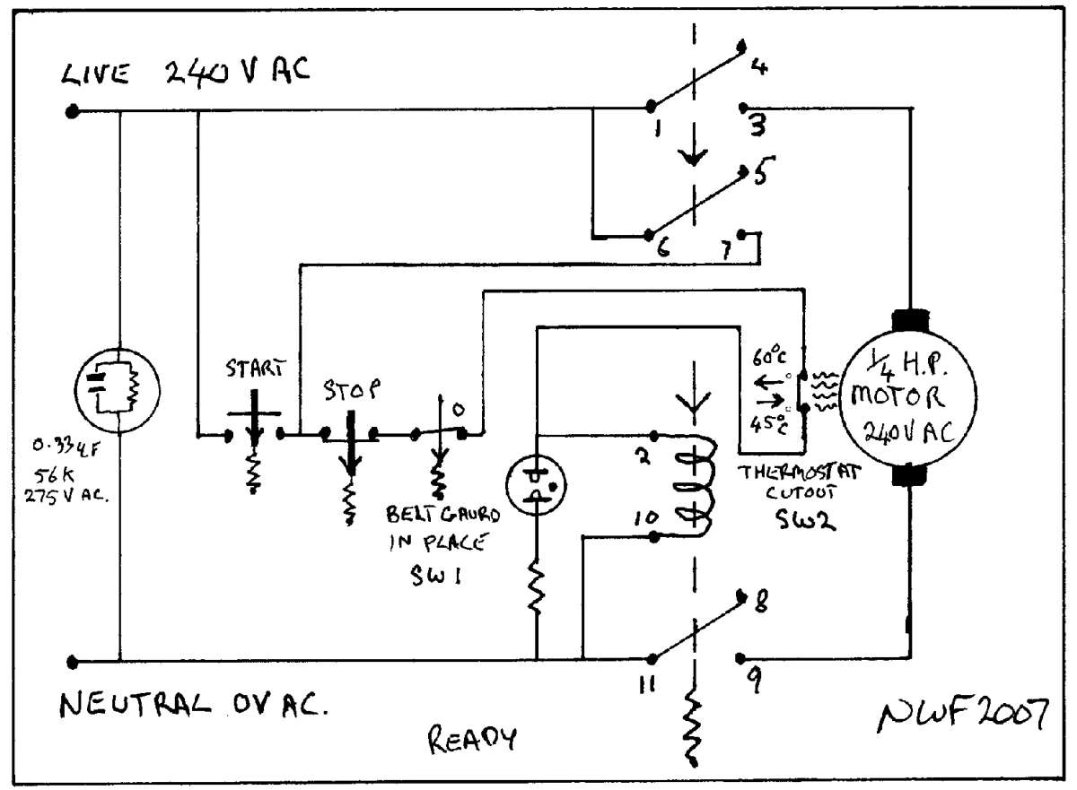

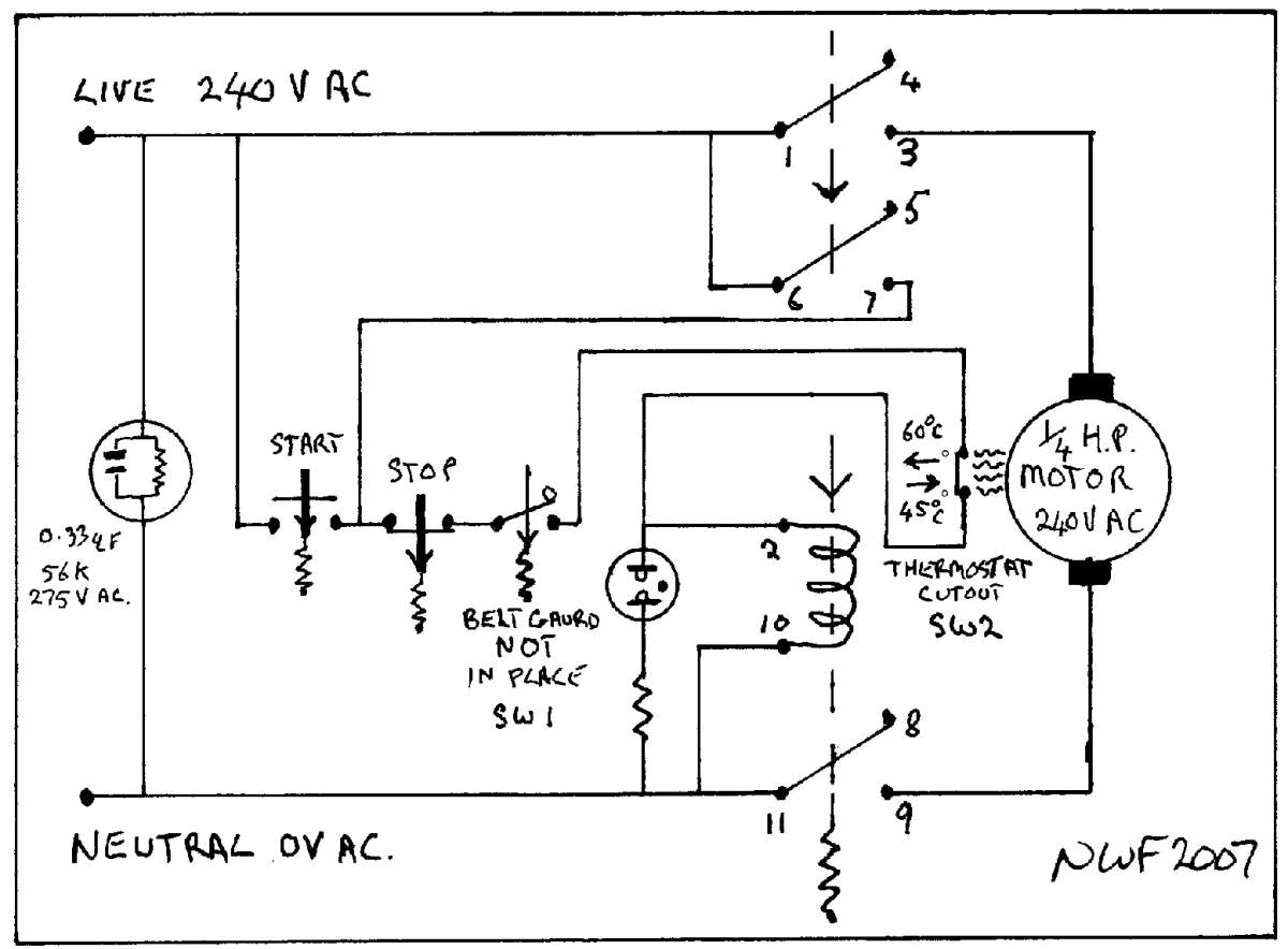

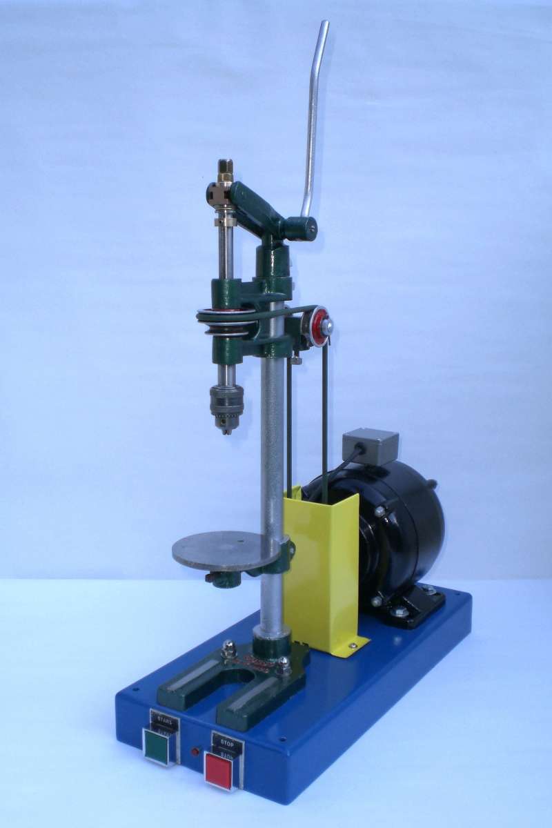

                                              Hi Bevel, back in 2007, I refurbished a small hobby drilling machine, which was my fathers, when he had it in his shed back in the 40’s / 50’s, it was powered by a line shaft, which also drove his lathe.
                                              DRILL0
                                              However, I decided to make it as a portable bench drill as can be seen above, I didn’t include an emergency stop for it, but one could be added easily enough, but it does include a NVR circuit, a missing guard situation and a thermal cut-out, should the motor overheat. Your switch box could be used quite easily with a similar circuit using a contactor, as shown below, but you may not need the thermal cut-out.

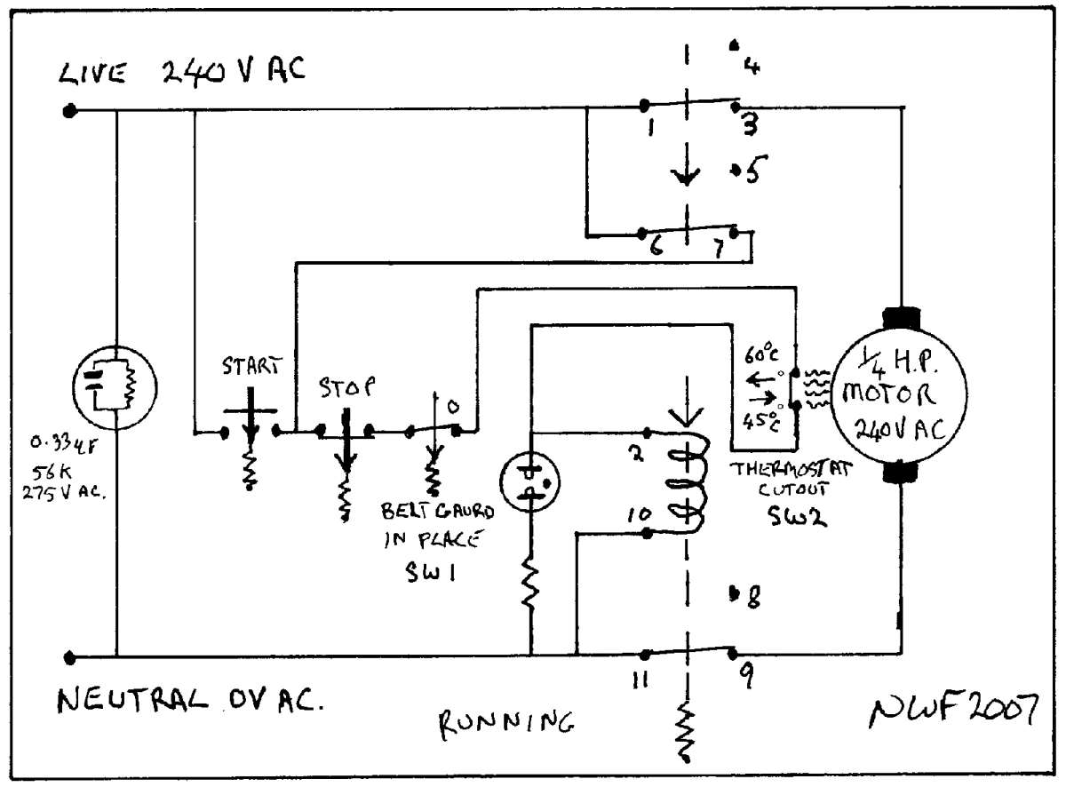

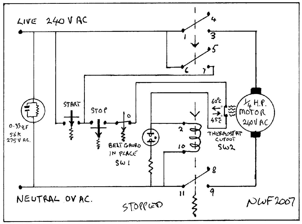

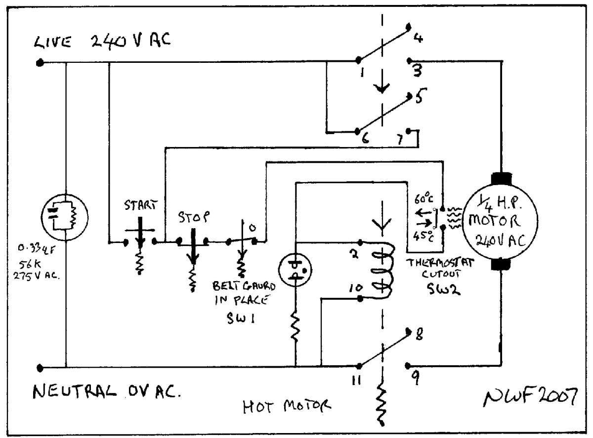

                                              The circuits below show all the states they can be in.
                                              CIRCUIT1CIRCUIT2CIRCUIT3CIRCUIT4
                                              CIRCUIT5
                                              DRILL06
                                              As you can see, the stop is on normally closed, and the start is on normally open, an emergency stop could be put in the live feed, or after the start switch, before or after the stop switch, and using the normally closed contacts. Hope this is of help.
                                              Regards Nick.
