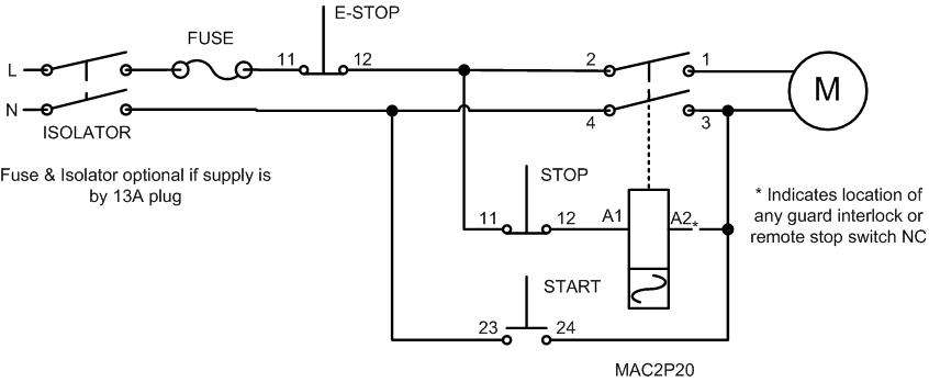

        You need to add a contactor like this one:
        https://www.ebay.co.uk/itm/183128744561? 2 pole 20A with 240V coil to make your switches work.
        Basic stop start.
        Note the blobs I’ve used at junctions for clarity don’t have to be seperate terminals they can be at the component screw terminals. You can put 2 wires per terminal one either side of the screw. So the connection between the E-Stop , Stop and contactor terminal 2 would be 2 wires in the E-stop terminal 12 one going to Stop terminal 11 and one going to contactor terminal 2.

          Hi Martin,
          Not sure if we are quite on the same page. I’m refering to the NVR switches the Batxle shows in post 847411 These are not in my opinon an E-Stop. Some (not the ones shown) have an E-Stop latching “mushroom” on a swing down cover. They may be considered an E-stop IF the button forces the contact open regardless of the state of the coil. If an external E-stop is used with one of these it should of course be fitted at the input to the NVR and ideally break both live and neutral (these NVRs are only single phase.) A single pole E-Stop such as Bezel has would still be at the input and break the live. In the units Bayzle shows ther are 4 or 5 connections. The 5th connection “A1” is one side of the holding coil. You can’t tell from the diagram what the other side of the coil goes to because it shows two connections to the “output” side of the switch. This is to allow external interlocks. It is not suitable for an E-Stop as it can’t over-ride a stuck coil. A common failure mode is the coil over-heats (possibly due to shorted turns) and distorts or melts jamming the armature / actuator in the on position. In this failure breaking the A1 connection will not stop the machine. If the interlocks and thus A1 are in the live circuit then they MUST be connected to the output side of the NVR. This is only works because the Start button on the NVR closes the contact without needing to energise the coil. That is another failure mode of these cheap NVRs, the Start button jamming in, possibly due to swarf and you can’t stop the machine.
          A seperate contactor and E-Stop is much better.

            FYI testing the NVR switch I pictured has the A1 connected to the coil and the other end of the coil connected to pin 4. When the green button is pressed pins 3 and 4 are connected. So you could wire it with pin 3 (which is labelled “in”) connected to live, pin 4 connected to motor input, pin 1 to supply neutral and pin 2 to other motor input. Then the relay coil wire A1 can go through whatever interlocks to neutral or independent earth. This leaves the interlock circuit not live provided you have an earthed neutral (depending on country and wiring protocol).
            This seems to be the opposite numbering from the diagram above.
