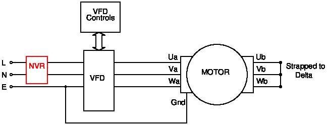

        Can you provide a circuit diagram please?  Is it different from Allan’s compromise, in which the 2-speed motor is wired for one speed only and driven by a VFD of appropriate voltage?
        Wiring one VFD to a single motor is straightforward.   Using one VFD to power two motors is asking for trouble, and so is switching a VFD’s output.  I tried to explain why it’s unwise to connect a VFD to a Dahlander motor and switch the windings as the machine was originally configured.  No problem when the supply is true 3-phase, but unwise when 3-phase is generated electronically.   Julie found my explanation muddled, and, if I gave the impression speed is related to impedance, she’s right!  Impedance is nothing to do with speed, other than indirectly due to how the motor is wound.  I was trying to explain why ordinary VFDs don’t like load impedances that jump about due to different windings being connected, and especially dislike their outputs being switched. Sorry I failed, and no-one else has tried!
        How risky depends on what’s inside the VFD.  So far I’ve not found an inexpensive VFD that supports mixed loads and/or switching.  Those that do are expensive.  Might change because the cost of electronics tends to drop, but so far, best not to risk mixed loads and/or switching. Check the spec if it’s wanted.
        Allan’s solution keeps his VFD happy by strapping the Dahlander’s windings permanently into single speed.  Then there’s no need to switch the VFD, and the circuit becomes conventional, hurrah!
        Speed is controlled by varying frequency, not voltage, and the VFD voltage is chosen to match the motor.
        Apologies if I’ve misunderstood, but, if proposing something new, how would Mark wire Ub, Vb and Wb?

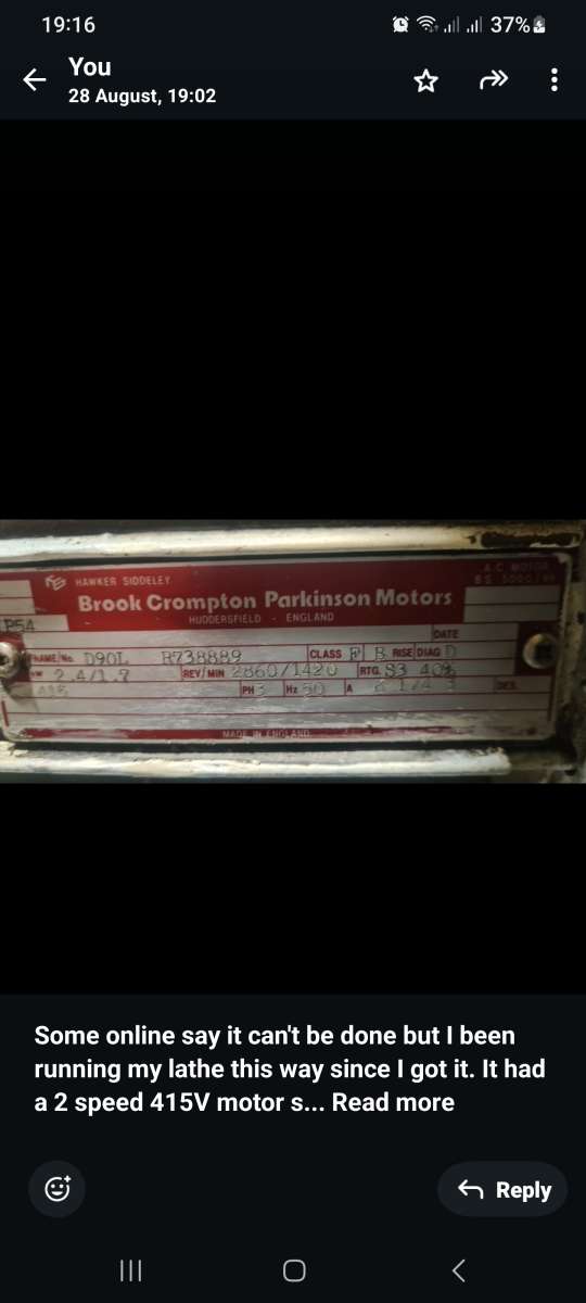

          OK so I I decided to test this out today with this 415V 2 speed motor picturediabove. I did a bench test & it worked so i put it on on a lathe to run it through the RPM speed. I first connected the low speed terminals 1U 1V 1W to the VFD & set the voltage to 230V & maximum Amps 4.3A & selected high gear & i got the lathes rated 1500rpm (obviously its geared) the motor is very smooth.
          Next test  i swapped the terminals & connected the high speed motor wires  2U 2V 2W to the VFD & set the voltage to 380V & the maximum Amps to 6.1A & got 3000rpm, again very smooth, I then machined SS for 30 minutes & checked the motor & its cold. Athough i connected it separately there are settings in the parameters to programme both & use them using the M.FUNC button on this VFD so it switches between low/high speed setting but that is for another day as it 6pm now & tea time.
          Bear in mind I already have a 2.2kw inverter rated dual voltage motor that I used for this lathe & its a great motor but the 415v pictured is running alot smoother so I’m temped to keep it on the lathe now & use the new one for another project. Wish I new this befor I purchased another motor but its always good to have a spare. There has to be a downside somewhere,  maybe decreased torque IDK but it’s working.

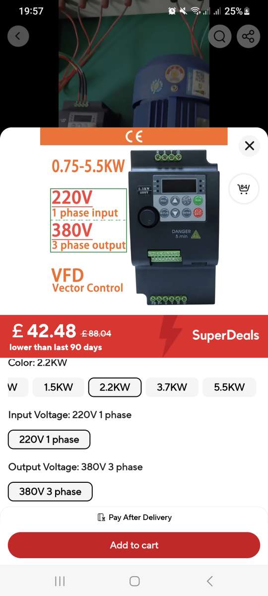

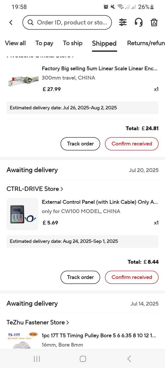

            Screenshot_20250801_195819_AliExpressHere is the VFDs I been using , they are available in both  240v in 230V 3 phase out & 240V in & 380V 3 phase out & its the latter I used for this test you can set the voltage above 380V in the parameters but i stuck to 380V max. There is also a external display that is available for this model. I’ve never had a issue with them & all three i have come from there & my linear scales & DRO, they are cheap but the important thing is they work as advertised.
            There was somone on the hardinge forum that connected & used a VFD on his hardinge 415V precision 2 speed motor using a drum switch to change the speed & adjusted the parameters to run it one way or the other. I have not go that far, I’ve only tested it wired to the VFD one way or the other. These are 2-3HP motors & maybe there are torque losses but I can see or feel them on the lathe, if there is perhaps it would be more noticeable on a lower HP motor. There are torque compensation parameters on the VFD but I have no experience using them.  Screenshot_20250801_195706_AliExpress

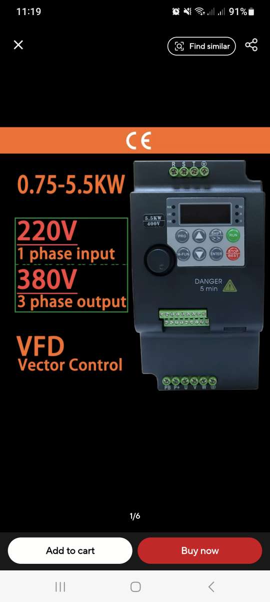

                      Screenshot_20250910_111940_AliExpressHi Wade
                      I’ve looked at 415v VFDs, but they are expensive. These are £40 & allow you to run a 415V motor & more importantly a 2 speed 415V motor.
                      Here is a update from my testing on a 2 speed 415v motor.

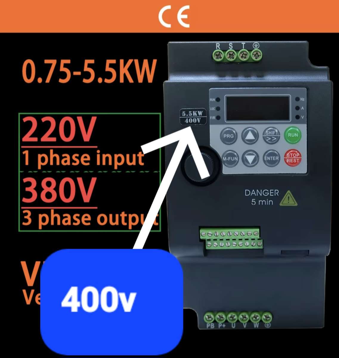

                      I have been testing these particularly CTL100 VFDs  for the last 2 years & and their excellent. Like all VFDs within the parameters, it allows you to set the maximum motor voltage BUT interestingly you can set it beyond the nameplate 380V. Although it’s sold as a 380V VFD, it has 400V on the front of the drive.
                      Initially I was running/testing this drive on a 415V 2 speed motor on a 3Hp lathe but with only a 230V output VFD connected to the motors low speed windings (even in low speed the motor still requires 415V but a lower current) however for this test i used a 230Voutput VFD & it worked fine, I got full RPM however at top speed 3000rpm I could tell it lost Hp but as its a 3HP motor it wasn’t noticeable in the other speed ranges.
                      My latest test was to add a single phase in & 380V three phase out VFD to test/run this 415V 2 speed motor, I wired the high speed terminals to the VFD then updated the maximum current in parameters but set the maximum motor voltage set to 380v. It ran great all week with no issues ( the motor did not get hot or stall & no errors from the drive)
                      next test i set the maximum motor voltage (in parameters) to 415v, it’s been running all day every day in the workshop for a month.
                      I have 4 of these VFDs now in both 230V output & 380V output & in all of them it allows you to set the maximum motor voltage to 3 decimal places (theoretically 999v) I would not advise it but 10% beyond the drives 380- 400V seem OK.
