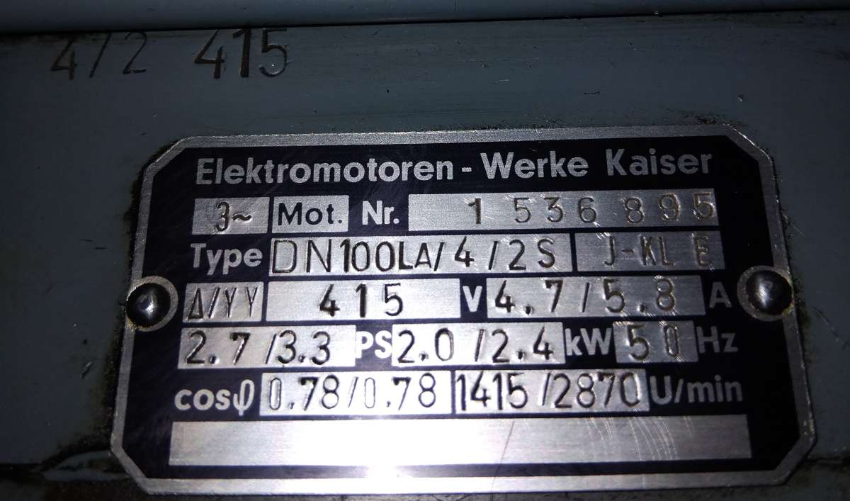

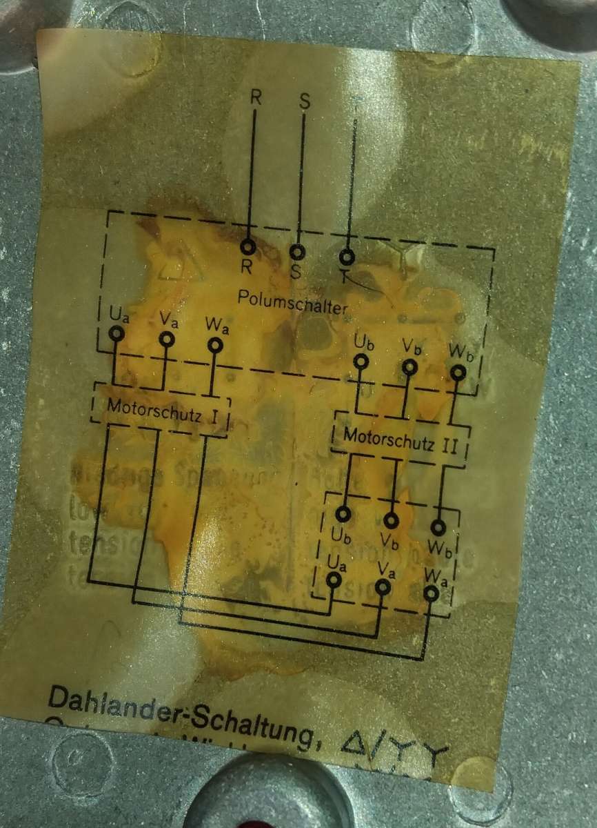

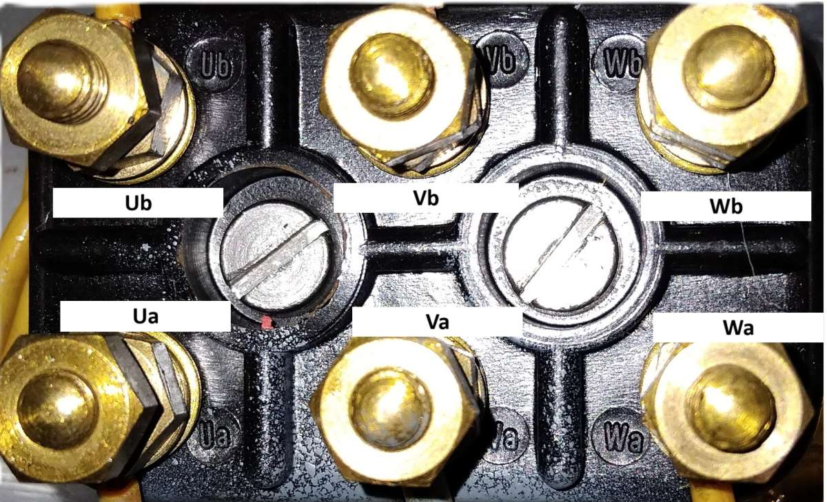

      I have a Weiler Matador lathe with a 2 speed 3 phase motor (Dahlander.) I want to run the motor on single phase 240V 50Hz.
      I want a VFD to supply the power to the high speed windings in the motor. Pictures below of the motor connection box, connection box label & the motor information plate.
      Conection block 1
      Motor Information Plate
      Connection box label
      How do I wire the VFD into the motor connection box & configure the 6 terminals in the connection box?
      Would I be better off buying a new 3 phase 2.5Kw motor instead of using the original motor? I would like to use the origional motor.
      Is a 3Kw output VFD adequate for the task?
      Thanks for your help,
      Allan

                I have been speaking to an engineer who has suggested I could use to original Dahlander motor by implementing a few modifications explained in the following.
                “U V W are the 3 coils in the motor wit A being one end B the other.
                First configure the motor to permanent star by linking Ub and Vb and Wb using a copper strip. The linked B are your (neutral) and the other ends your L1 (Brown) L2 (grey) & L3 (black)
                Your VSD will have an AC in and 3 phase out connect to motor. Swap 2 wires to reverse motor direction”
                Please reply with your thoughts.

                  Your engineer is speaking as a true engineer. What s/he has said is not untrue, but is completely unhelpful to your situation.
                  Sure you can re-wire the motor into permanent star, effectively making it single speed, but it will then only operate from 415v 3 phase input.
                  The only way you can get that from a VFD is to buy one that outputs 415v three phase. The most common 415v 3 phase output VFDs also require 415v 3 phase input.
                  Hence, the statement “your VSD will have an AC in” is trite.
                  A VFD that takes 230v single phase input and outputs 415v three phase is a rarer item. As you are in Australia, either you need to find an importer of the far Eastern ones (akin to JFK or Drive Direct in the UK), who of commercial necessity will have some quality level or you buy direct from China via eBay, Amazon, etc.) and take a risk on the quality.
                  Similarly, while the ‘swap any two wires’ is not wrong, it is never something you would do either physically or via a mechanical switch in conjunction with a VFD.
                  So give the engineer 10 out of 10 for engineering but one out of ten for actual practical help.

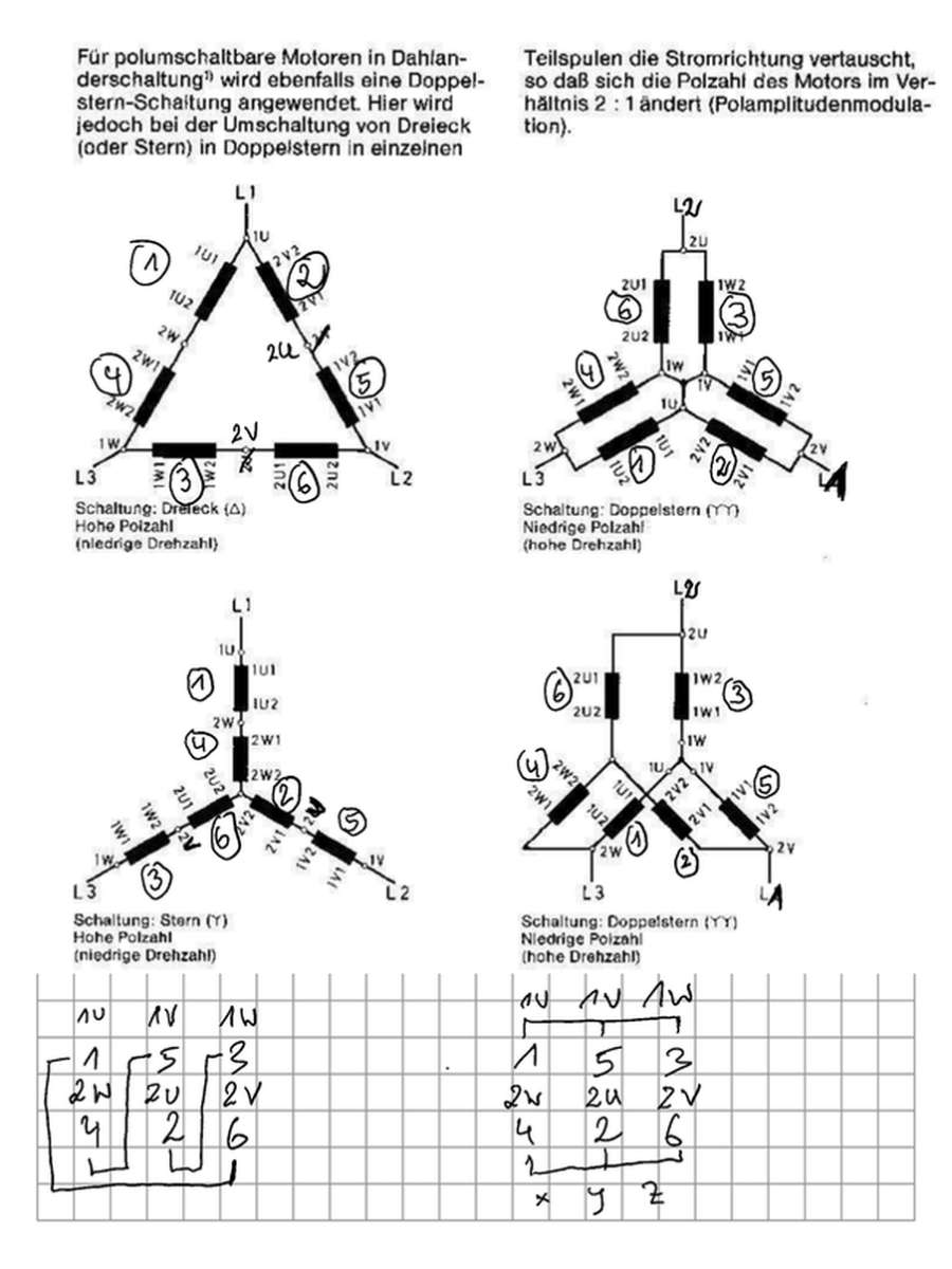

                        In principle, yes.   But the devil is in the detail, and the description is basic. I’m also a bit worried about “U V W are the 3 coils in the motor wit A being one end B the other.”    That describes an ordinary 3-phase motor, but this is a Dahlander, which I believe has 6 windings, not 3.  The words are ambiguous, “not wrong”, but might be hiding a misunderstanding?
                        Sorry it’s in German, but next diagram shows how the 6 windings in a Dahlander can be connected, assuming all the ends are available in the terminal box.  More to think about than ordinary 3-phase!
                        dahlander
                        For the avoidance of doubt, can you share a circuit diagram showing exactly how your engineer says the motor will be connected?   From LN to the VFD and from VFD to motor.
                        Also, equally important, what should be disconnected inside the lathe?  The existing electrical switches and contactors will be set up for dual-speed, wrong if a VFD and strapped motor are used.  I find control switching harder to understand than connecting the motor.  For example, the diagram in my #797469 shows an overload trip and the contactors used to change speed, but not how the contactors are wired to the front-panel switches and any safety interlocks.  It too is a statement of principle, not an actual diagram.   Don’t panic, disconnecting redundant circuitry is easier than adding new.  May be as simple as unhooking the existing stuff from the power input and the motor, and telling the operator to ignore the old front-panel switches.   But be careful about disconnecting safety interlocks – they exist to stop stupid accidents.   What does your engineer suggest?

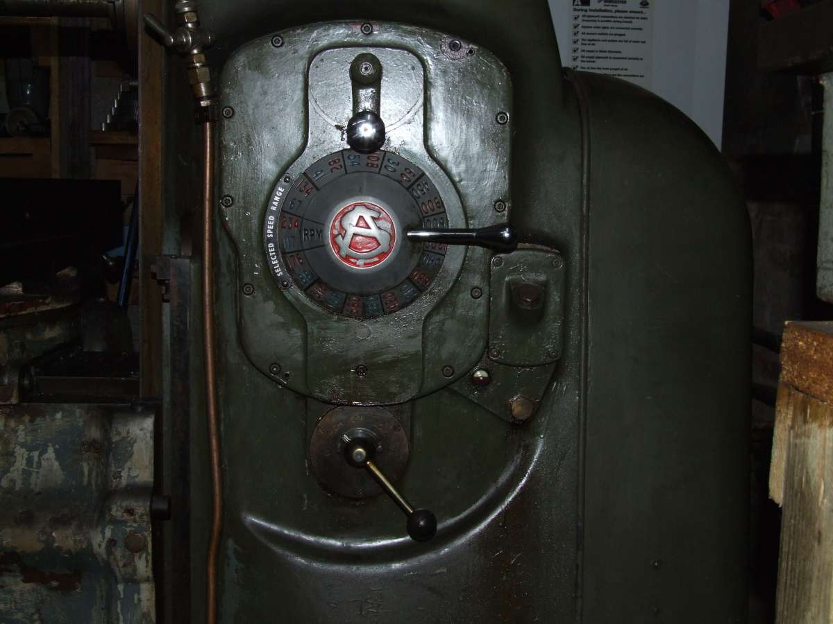

                          Photo 3 - Speed Change Arrangement
                          Changing of both switches is done with the motor stopped.
                          On the other hand the two speed motor on my repetition lathe has two electrical switches on the headstock for changing speed range and direction. The speed change is simply pole switching as power in low range is half that of high range. In contrast to the mill the switches can be thrown when the lathe is running. So one can go from low speed and forward direction to high speed and reverse direction just my moving two switches; no need to stop the motor. The motor does clunk a bit, but is designed for instant reverse/speed change as befits a production machine. An operator on piecework wouldn’t be happy if they had to stop the motor each time something needed changing!
                          Both of my machines run on true 3-phase, an upgrade I did soon after moving into my property. Part of the excuse was that the original supply was only 60A and had a wind yer own fuses box. So it needed upgrading anyway. It cost me £2k to have 3-phase installed, albeit that was 20 years ago. I was told by a friend in the building trade that half of the cost was due to the electricity network company having to dig up the road to get to the 3-phase supply buried on the other side of the road. Apparently they have to cover any costs due to poor workmanship on the road excavation for a year.
                          For the OP the best solution is a 3-phase supply, allowing the lathe to be used properly. Failing that probably best to change the motor.

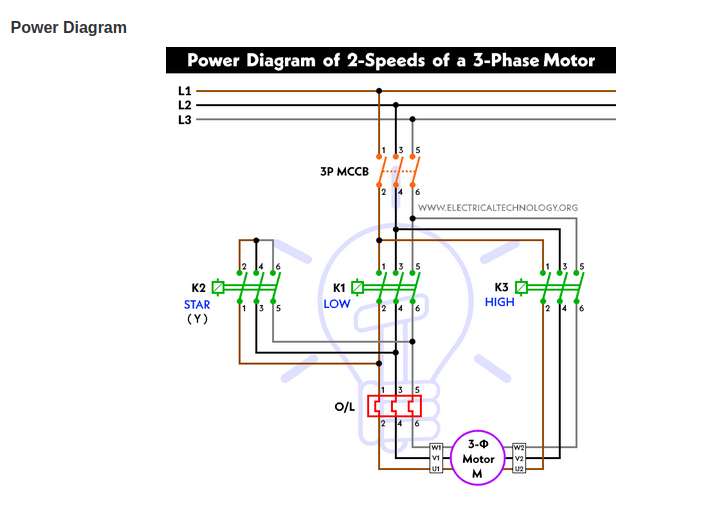

                            Hi, this schematic might be clearer to understand, as it doesn’t look too cluttered to me.
                            Dahlanders
                            Web page
                            Regards Nick.

                              Unfortunatly there is no way to wire this motor for 240V Delta as it is. However if all the winding ends are brought out to the terminal block it could be re-wired.
                              You need to look at the back of the terminal block. If there are two wires on each terminal it can be rewired as Double Delta. This allows you to use a low cost 240V output VFD. Ideally wire for lowspeed and use the VFD to double the frequency and speed.
                              If there is only one wire on 3 (or more) terminals you need to dig further and see if the ends of each winding can be accessed. If not you would need a 240V in 415V out VFD.

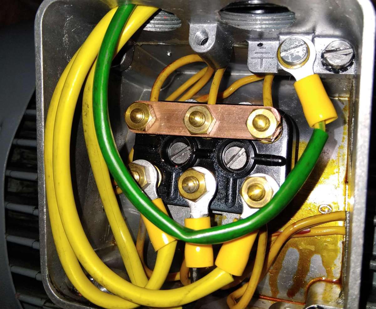

                                      #798678
                                      Allan Day
                                        @allanday33071
                                        <p style=”text-align: left;”>Thank you all for your replies, again!</p>
                                        The picture of the connection box below is as the engineer I have been speaking to says.
                                        The 3 yellow & earth wires go directly to the VFD.
                                        NO switching between the motor & VFD.
                                        The VFD will be used to switch the motor on off (high speed ONLY) & speed control.
                                        The original switch gear has been removed from the machine.
                                        Gerard O’Toole’s post is what I am aiming for.
                                        PS. The wiring in the picture is just for the picture, it is not connected to anything.

                                          Allan, words and photos make work at this end compared with a circuit diagram.   And they risk helpers making mistakes whilst reverse engineering them.   However, if this is what you’re doing, the motor should run as expected:
                                          dahlander
                                          Note the “No Volt Release” switch shown in red.  Recommended for emergency power off, and NVR prevents accidents when power comes on unexpectedly after a power-cut.
                                          Also, lacking detail is the “VFD Controls” box.  The controls handle ON/OFF, Forward/Reverse, Speed, and the Safety Interlocks.  Wiring this can be tricky – read the manual, and ask again if necessary.   Most VFDs are components, i.e. mounted inside a protective box, and it’s calculator-like interface is intended for set-up only, not routine operation.  Instead, the VFD is worked from a box located convenient to the operator, and it’s handy to fit a tachometer showing spindle speed.

                                            If wired up correctly the vfd will provide the nvr function

                                              Dave, Thanks for your replies.
                                              Your diagram, less the NVR, is what I have planed for my lathe.
                                              The VFD switching controls will be remote, via the lathes apron lever (how it was originally controlled, forward / reverse) & a potentiometer mounted remotely from VFD. There will be a breaker between switchboard mains supply & VFD.
                                              Regards,
                                              Allan
                                              #798838
                                              duncan webster 1
                                                @duncanwebster1
                                                If the apron lever is just a fwd/off/rev switch then my previous email doesn’t apply and an NVR would be a good idea.
