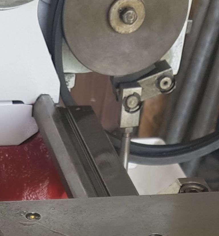

      Rollpins, of the size that you seem to have don't require a huge force to refit them. I could imagine that a 4 oz hammer would suffice. You are looking to overcome friction and compress the split rollpin. For the same interference, you would not be able to drive a solid dowel into place!
      If possible refit the rollpins to the pulley and hub, before refitting to the lathe.
      before tearing everything apart, turn up a counterebored dolly, so that you can use the central setscrew to press the pulley onto the shaft. In this way you will not be putting any impact load onto the bearings.
      A large thick washer, and the setscrew might be the impact free method of refitting the rollpins, (doing both at once with care )?
      Howard

            MC My M300 (late model with sloping front edge to tray) has much more clearance from the pulley (120mm dia) to the headstock than your photo appears to show, belt changing is easy and the pulley is fixed with two set screws and does not have a centre bolt. Not much help for you but it does show there are variants.

              MC Have now dragged my M300 handbook out from its resting place. Headstock parts breakdown clearly shows M6 x 20 bolt Part 33 screwed into end of shaft through "safety washer" part 31 and "washer retaining" part 32, pulley is keyed to shaft by a single woodruft key. So appears to be, M6 bolt out and pull pulley from shaft axially. No sign of any spirol pins

                    MC Mine is the later headstock wih the completely flat face where the gear selector controls are. I would hazard a guess that you may not need to worry about the roll pins but merely remove the M6  and draw off the double pulley using a simple puller.

                      Sorry I am a bit late late to this party. I don’t know if you have already sorted this. I have just finished stripping and rebuilding my M300. The roll pins only stop the washer/cap from rotating on the shaft, meaning that as you tightened the screw you are only pushing the pulley on rather than twisting/binding it on the key. On mine I just removed the screw, then the whole assembly came off. The roll pins remained in the cap / washer. You may need a puller to get the pulley off if the shaft is dinged from previous abuse, or if there is corrosion. Mine pulled off easily by hand.
                      Having said all of that, your pulley looks a bit on the large side, which may be why you are struggling getting the belts on. My belts easily passed the cap screw. Is the top speed of a T300 lower than an M300? 5d8dfee1-7b2f-4695-a169-0a16d0ef3dbc.jpegHere is a picture showing the pulley clearance on my machine. Sorry for the poor picture, this is a crop from a picture of something else.
